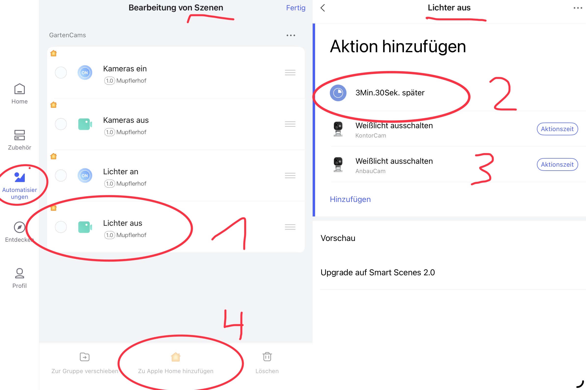

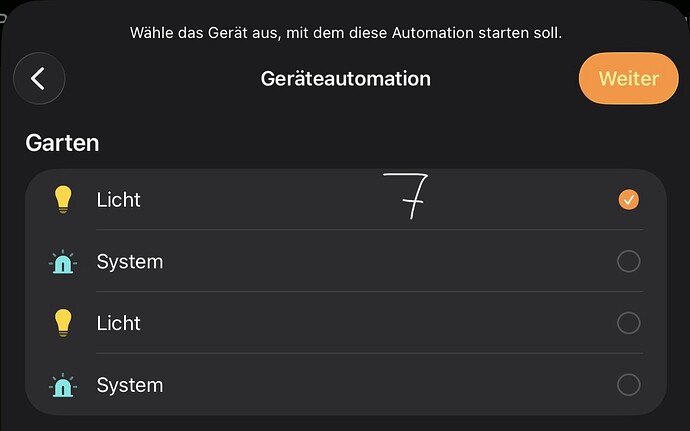

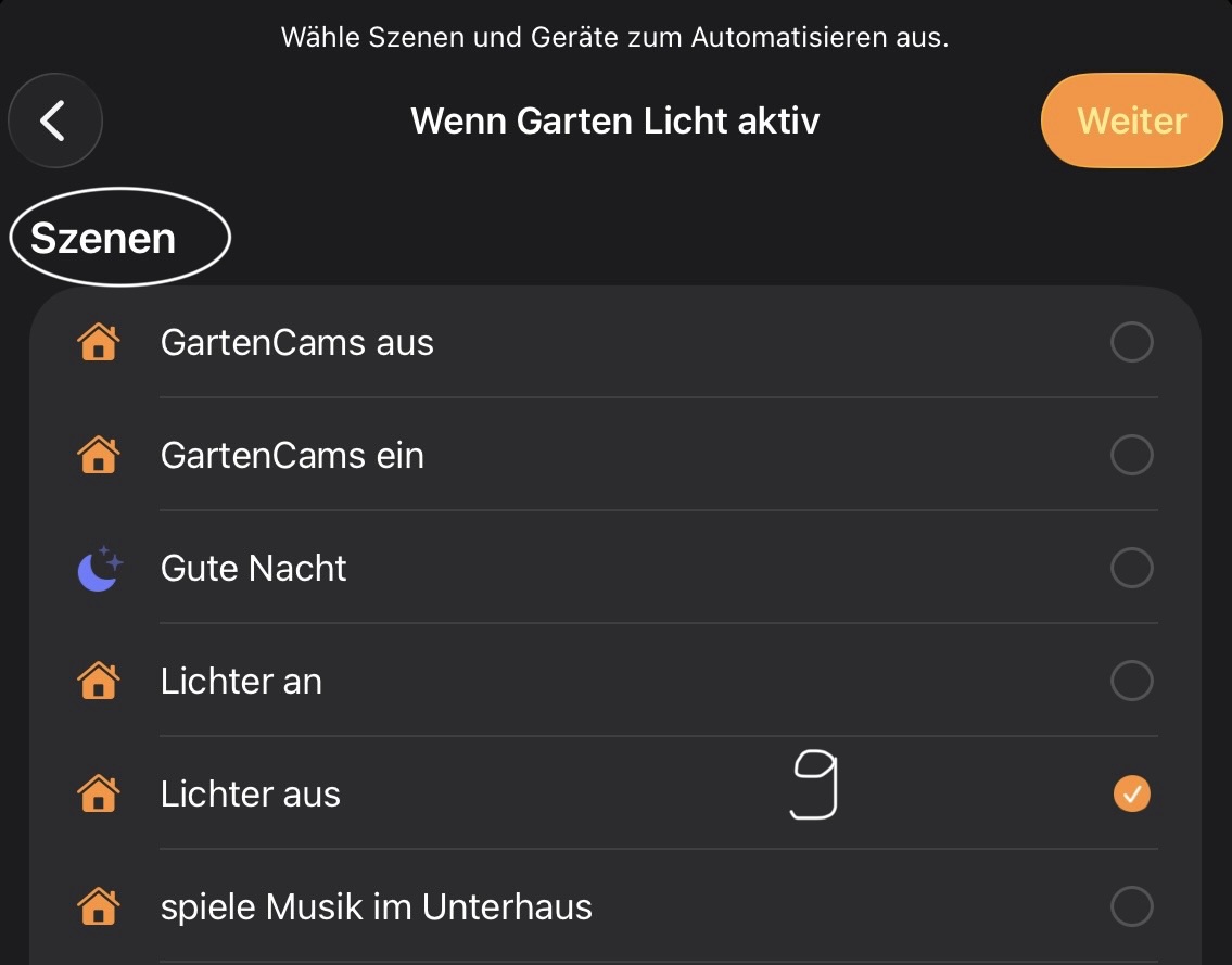

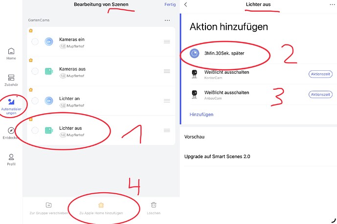

First create a scene in the Aqara app with a name of your choice (1), a waiting time of your choice (2) and the order to switch off the spotlight of the camera (3).
Then add this scene to Apple HomeKit (4).

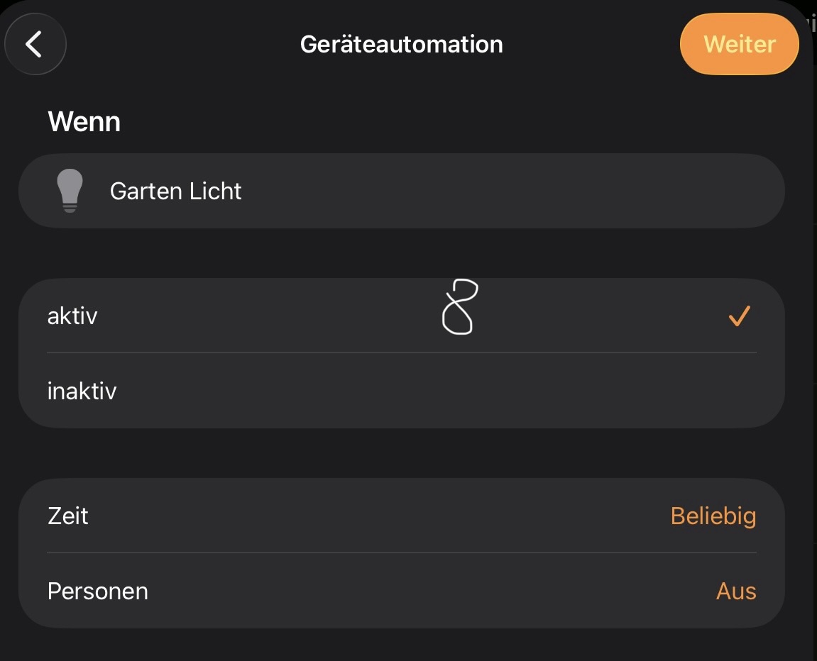

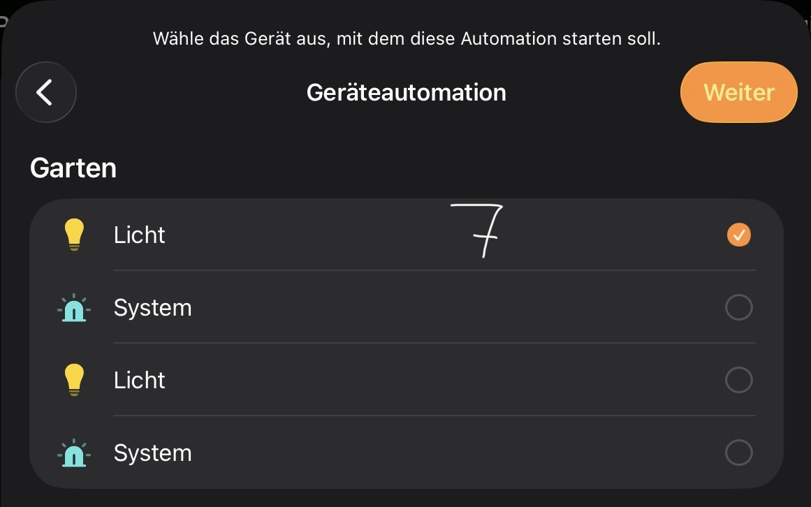

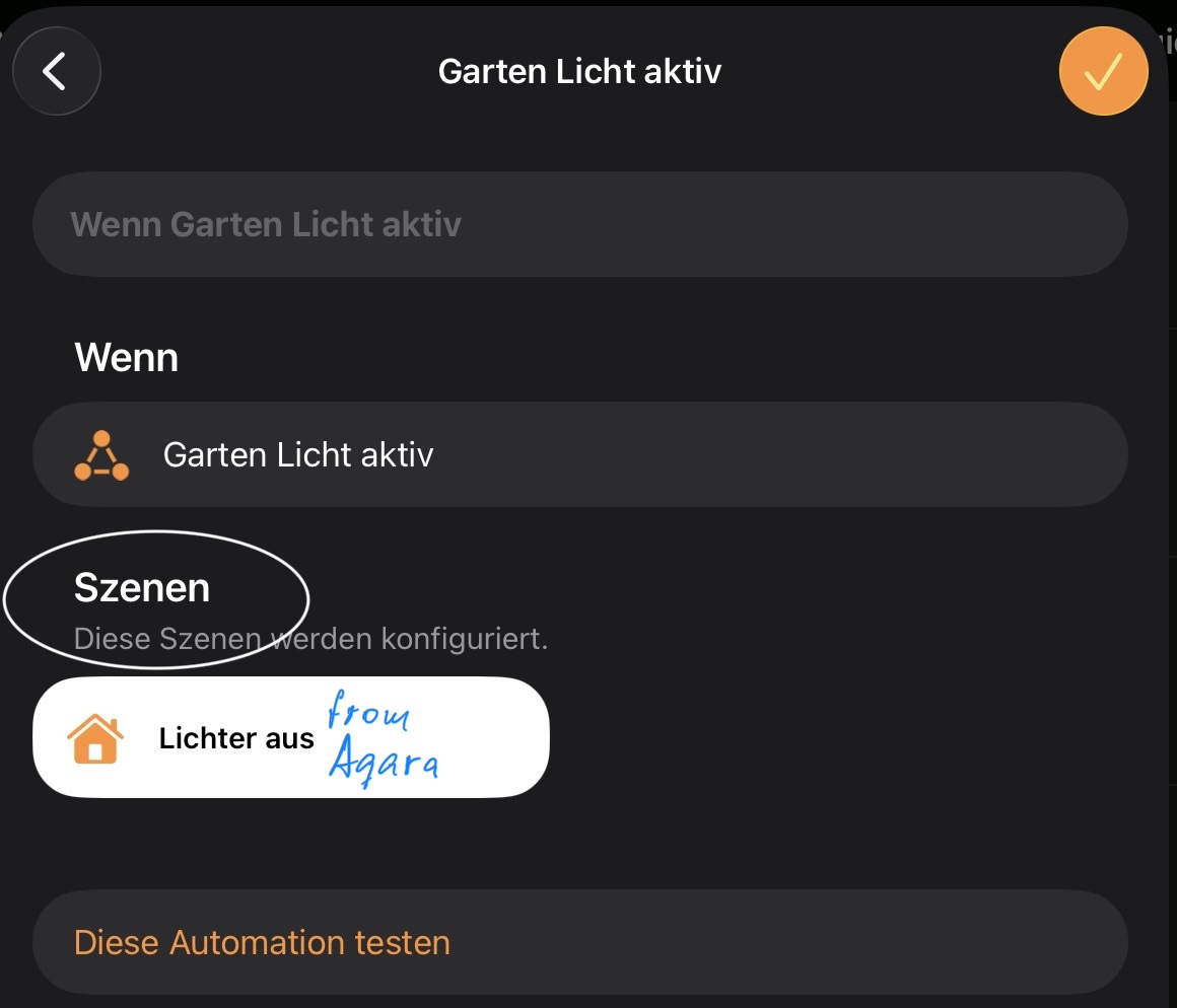

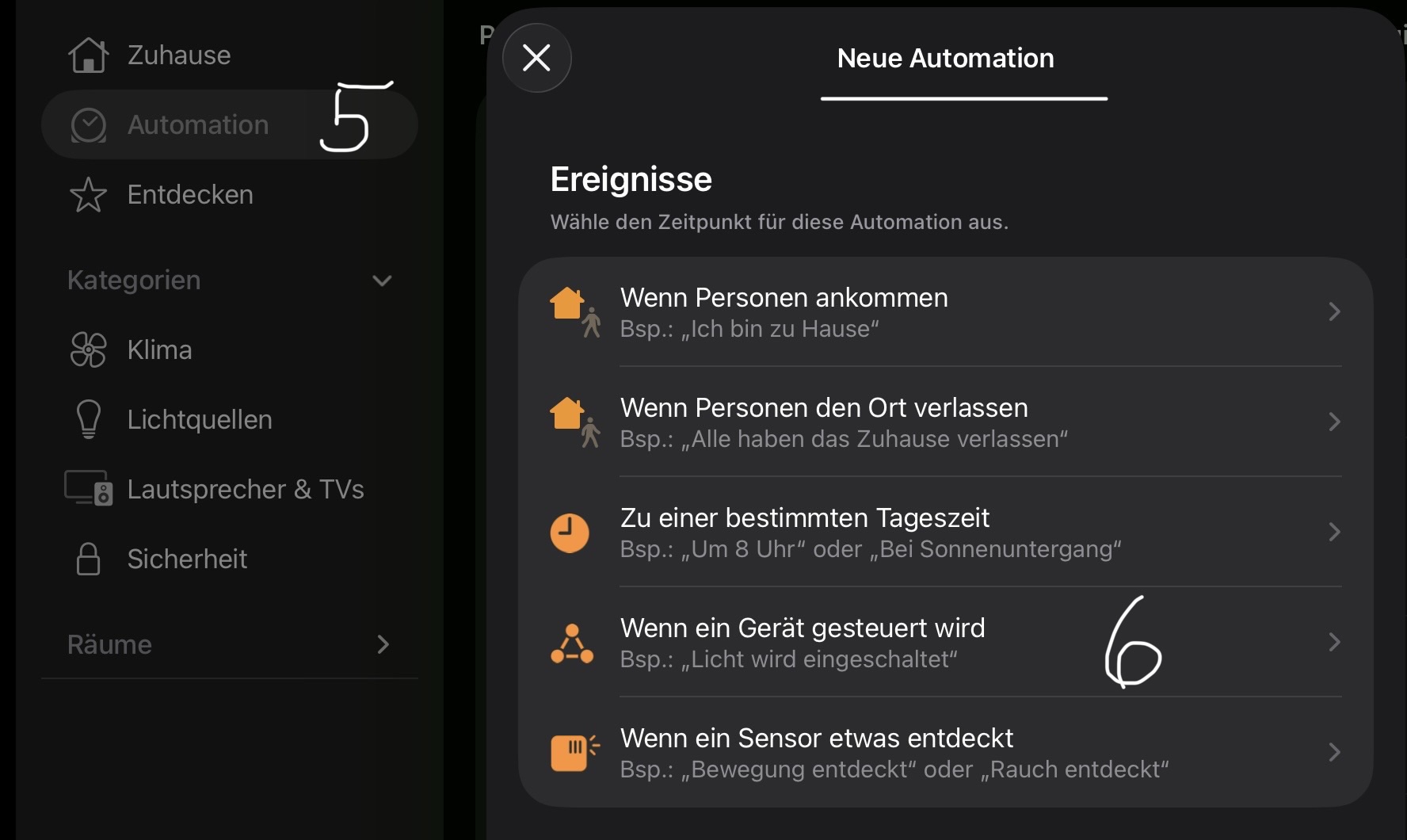

After that create a new automation at HomeKit (5-8) with the trigger to activate the scene (9) of the Aqara app to turn off the lights after your chosen time (2).

It exactly does this, the scene from the Aqara app turn off the camera lights but doesn’t affect any other lights in your home. See (3) in my screenshots.

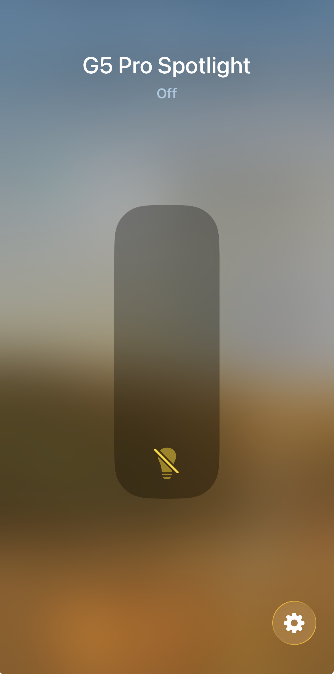

Frank meant that you can control the camera’s spotlight via Apple Home. I hadn’t thought of that. If you follow his instructions, you can set it to turn off after about a minute when it turns on. This is only a workaround, of course, and not a real solution to your problem, but you might want to check whether Apple Home Automation is turning on your camera light. It’s easy to confuse the light if you don’t rename it. Maybe you even accidentally created an automation that turns on the light?
I’ve renamed my camera. Before, it was simply called “Light”, which was confusing.
