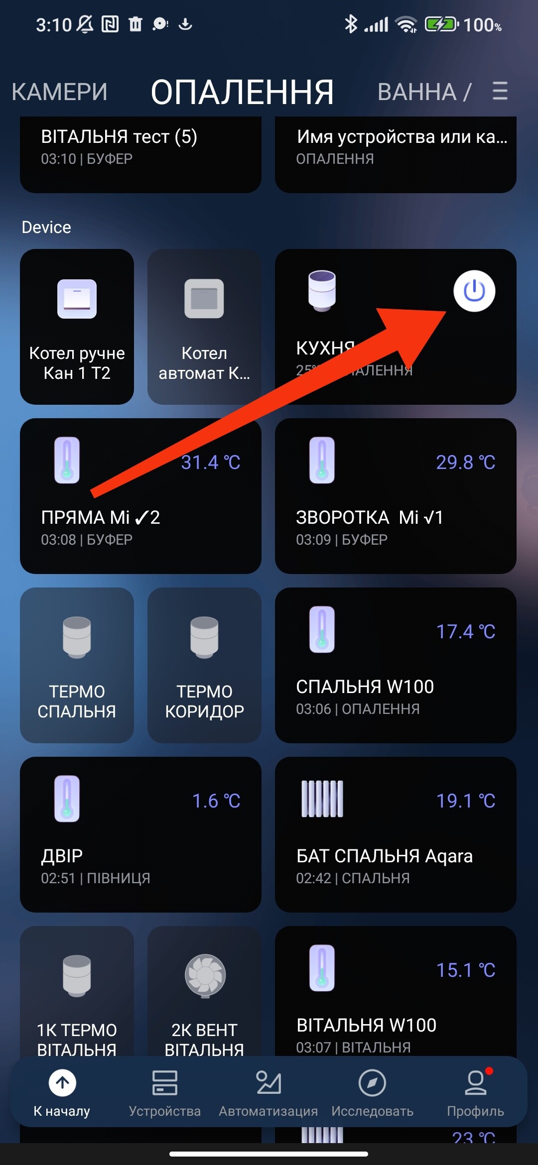

Hello, stopping the heating is “turning off the valve”. To make it easier for you to understand, this is the same On/Off button that is on the TVR E1 room panel. This function stops the radiator heating (clamps the valve) and stops the water circulation.
Personally, I don’t use it because it “eats” the batteries, it’s practically a mini calibration of the TVR E1.
