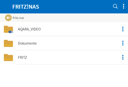

Then, unplug the USB device from the FritzBox and plug it into a PC. Rename the USB storage device to “aqara_video”. Then plug the storage device back into the FritzBox.
In your browser, go to http:// fritz.box /nas# (remove the spaces from the URL) and check whether the “aqara_video” folder appears with a USB icon, as shown in the image.
It is essential that the user account used to access the NAS has unrestricted access and is not limited to specific subfolders.
Then set up the NAS storage device again in the G5 and select “FRITZ.NAS” as the folder. Then check that the videos have been saved to the USB device.

thank you for your advise for the workaround. It is working as described. In fact I have attached a USB-HUB to the Fritzbox allowing to connect to drives to the NAS. The second one (a simple USB-memory-stick) ist only used to store the Aqara-videos. By doing so I can leave the remaining instalation untouched without changing drive-names and the storage is limited to the capacity of the USB-memory-stick not interfering with the HDD-storage which is used for various other topics.
