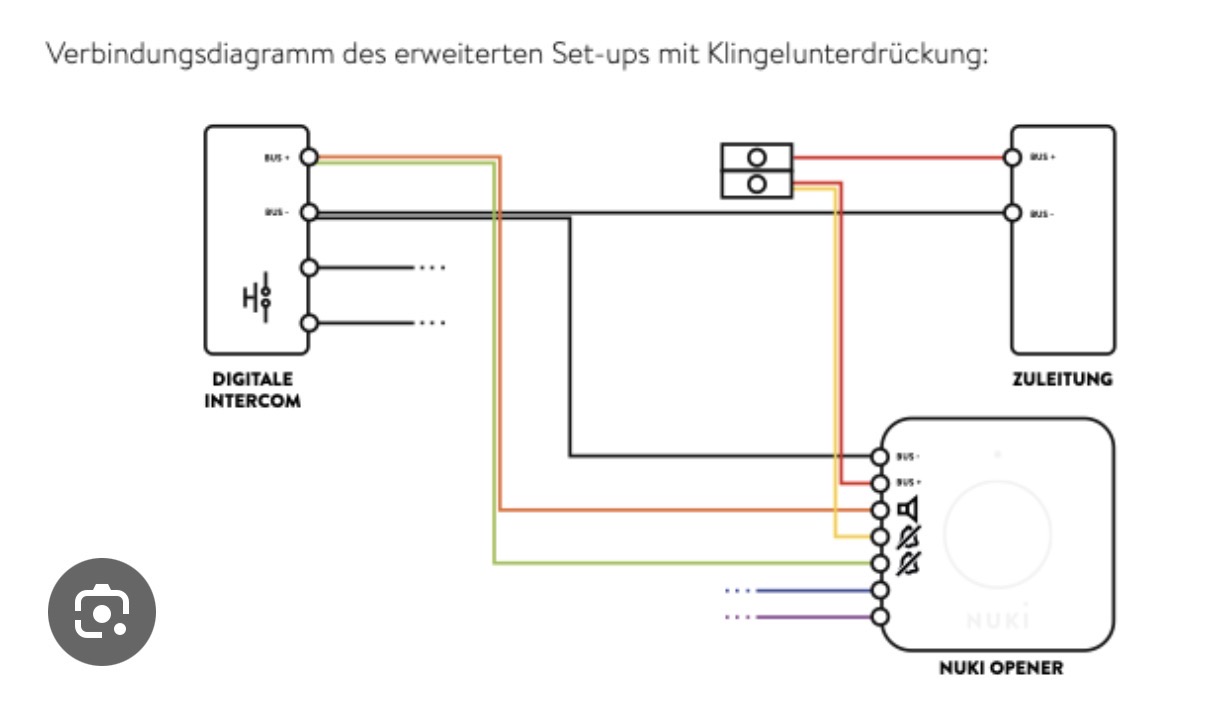

Hi There, just bought myself a Nuki Opener and don’t seem to be getting any further. Would you mind telling me which device you chose during the config. process? Was it Generic > BUS (Bticino)?
And does this diagram resemble what you did?
Thanks in advance
