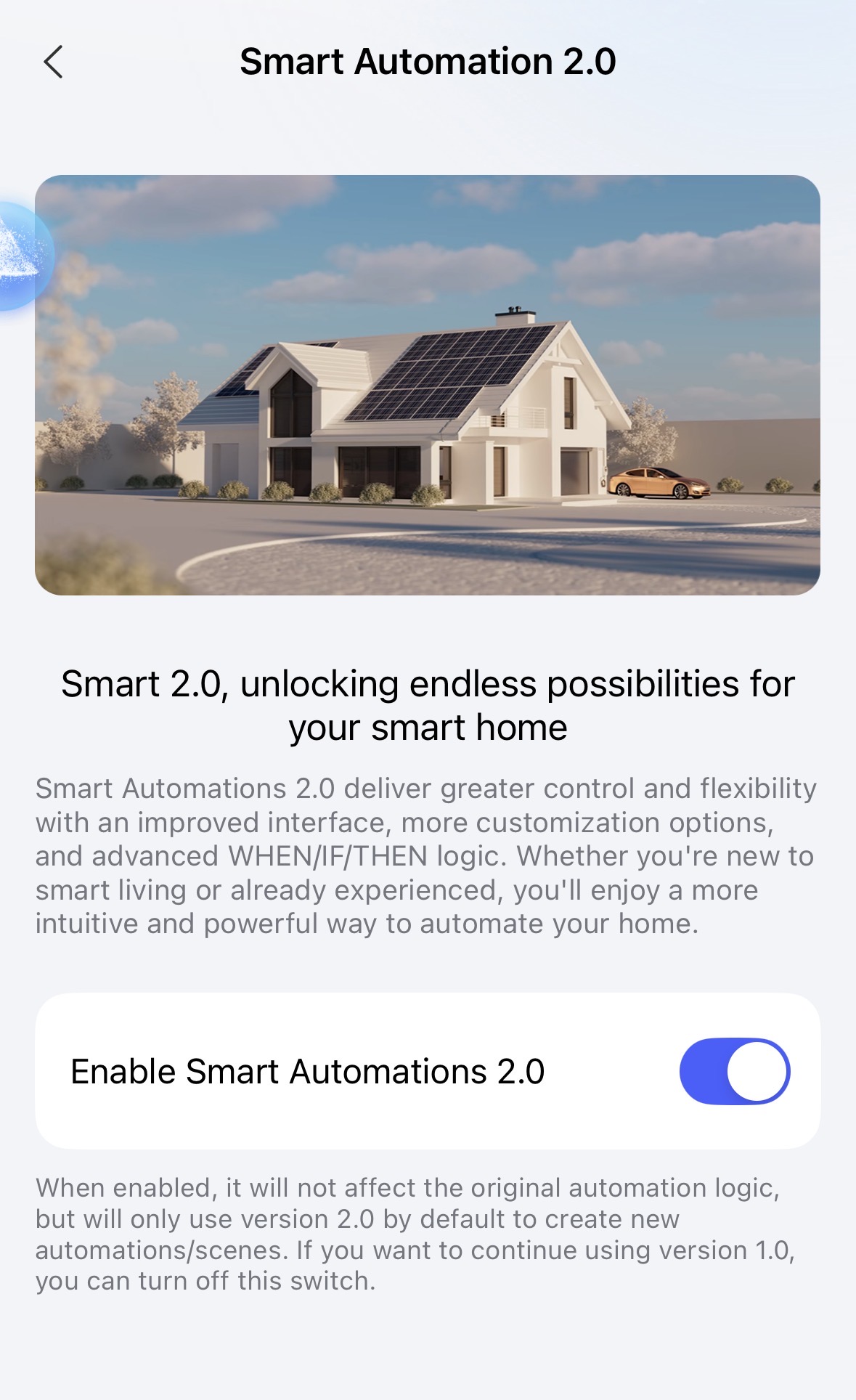

I think you are using automations not the new Smart automations 2.0
Please change to 2.0 and you can get this feature and more

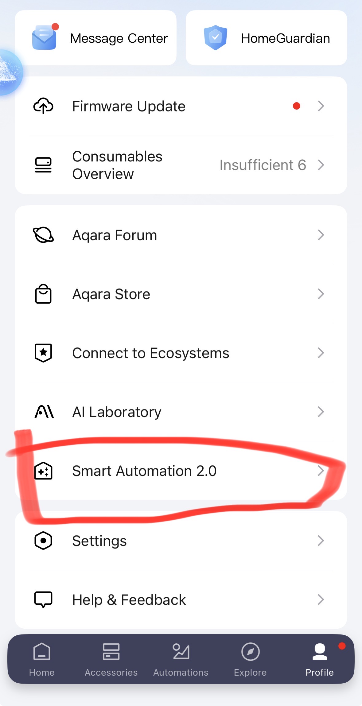

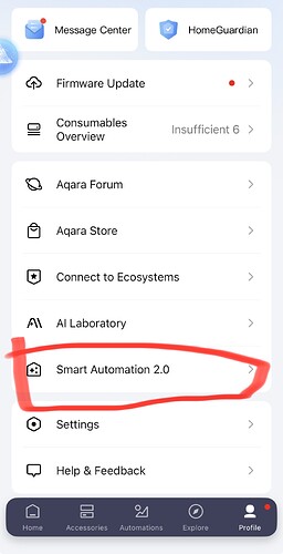

Hi and thanx for the reply but how and where do I find this 2.0? Have been looking for this setting and can’t fonds it simply
You can find in settings
