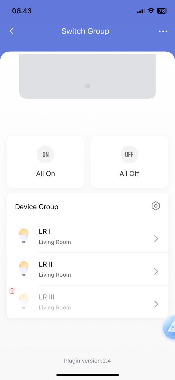

to add context:
  1. I’m not removing the accessory properly (thought there are no prerequisite when resetting the device)
  2. I have a device group with that problematic D1, but now it is offline and I cannot remove the device saying that ‘I dont have permission’
