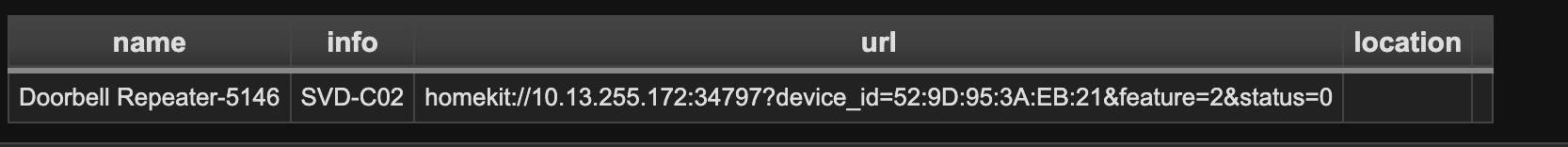

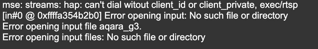

ok I’m on the way but not there yet. Installed go2rtc, found the add-on, went to the config, listed the devices to add and got

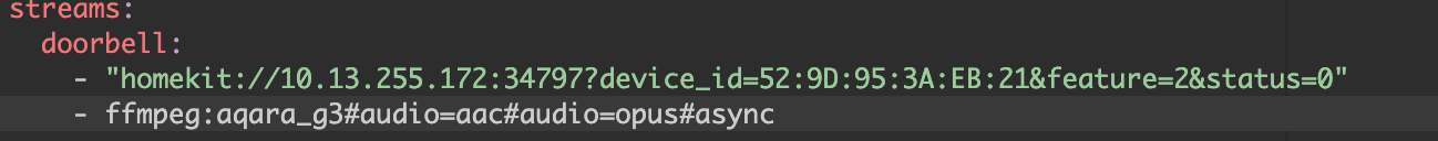

so I tried this config
but after save and restart hitting the stream button I get this.
switching to the camera name

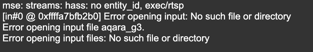

looks like I have issues with both the URL and ‘aqara_g3’

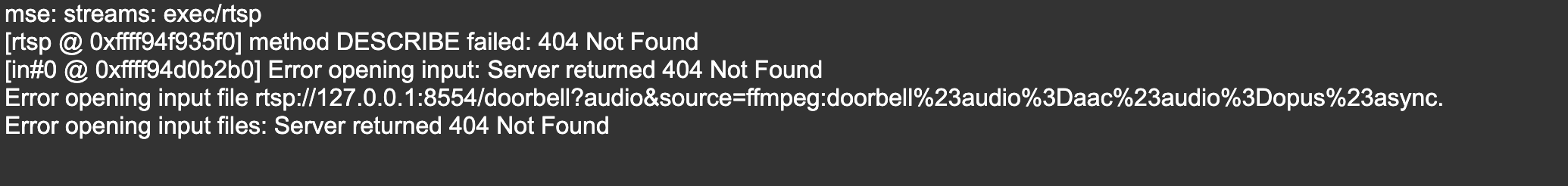

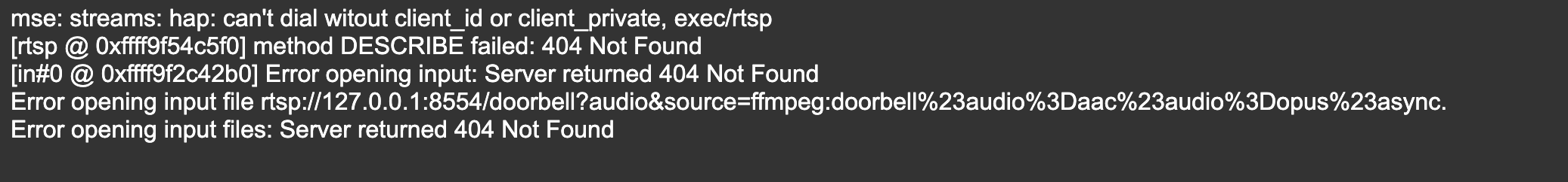

ok so the ‘aqara_g3’ in the URL should be ‘doorbell’ I think to match the stream entry name. That gets further however now I’m failing on both methods (name and url) unable to get an rtsp stream. This is the failure using the ‘homekit’ URL
and this with ‘hass’
I’ve poked around the other links but they all end up with an unable to open rtsp stream issue. Is there some piece of config I need to add to tell go2rtc that my stream is not rtsp?
also where do I get the client_id or client_private from (which I assume I stuff into the URL)

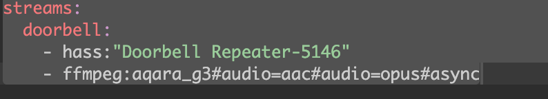

ok the magic appears to be getting the ‘hass’ line right, what I needed was
- "hass:Doorbell Repeater-5146"
It seems that just a bare ‘hass:’ was being interpreted as a map (and yes I’m pretty sure I didn’t have a space)
