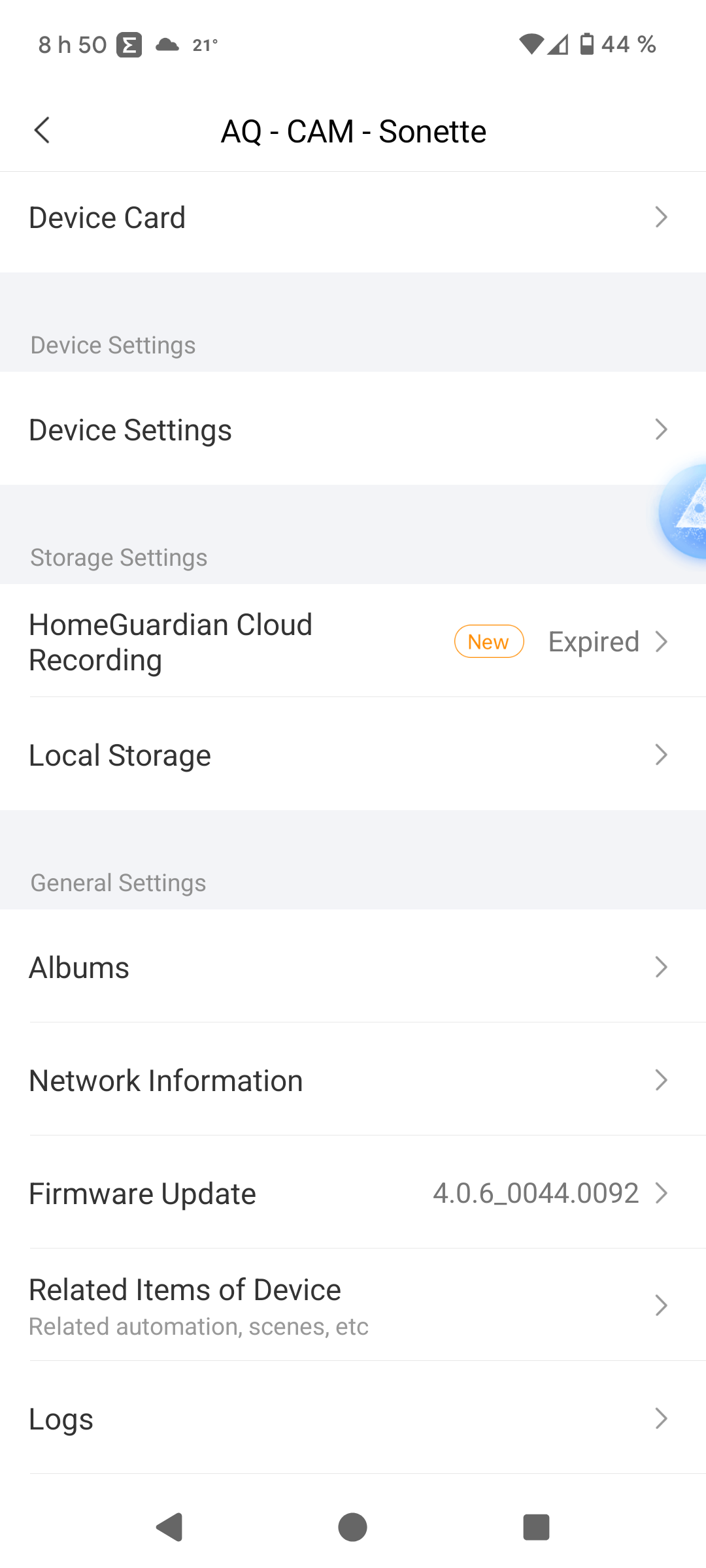

@AqaraBot I cant find this option. G4 is updated and Apps to

I also think that the bot is just AI parroting incorrect information. I too have updated the app and firmware and there is no option to enable RTSP. Also perhaps this feature is limited to the Chinese version, I have the global version, I’ve been caught by this stuff with Aqara before.

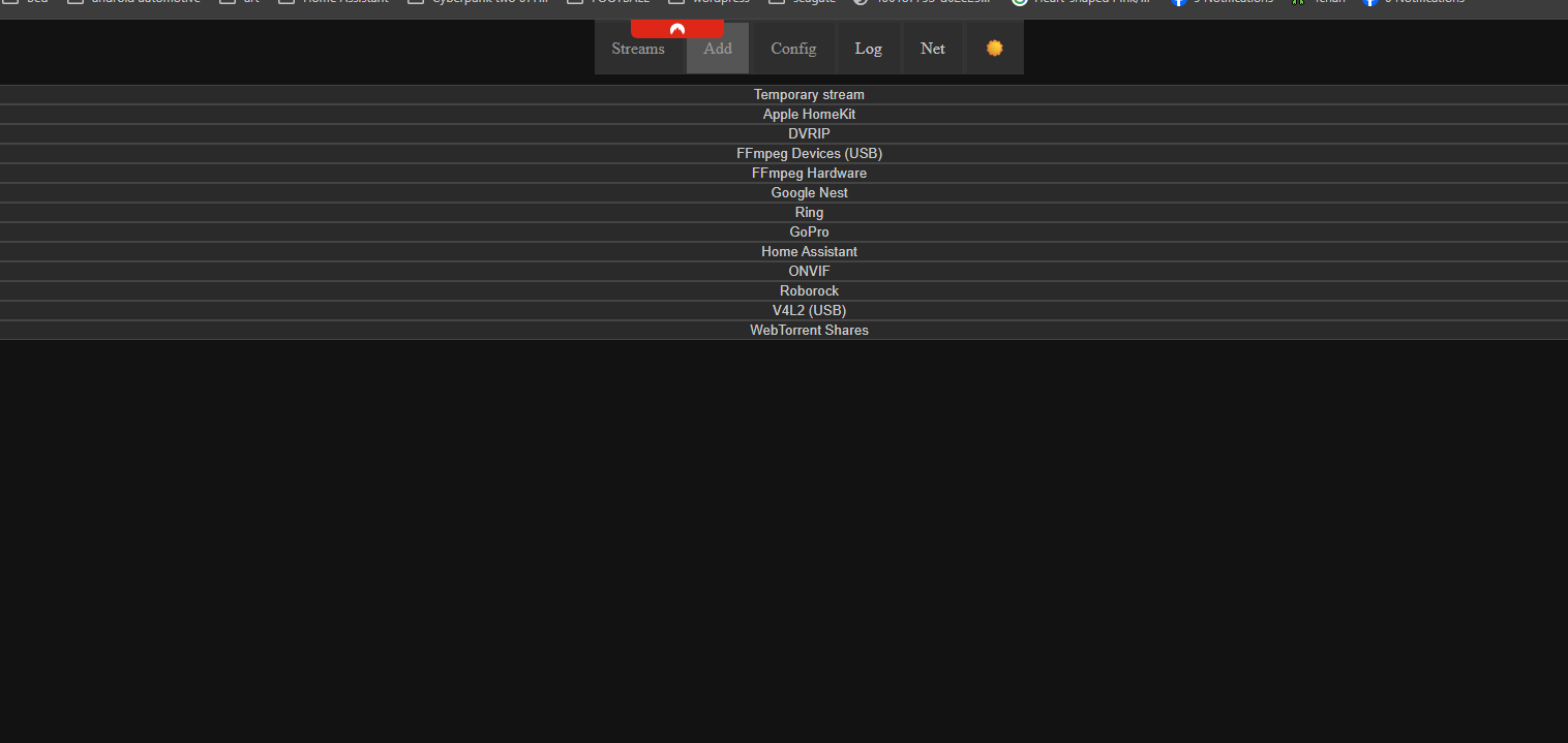

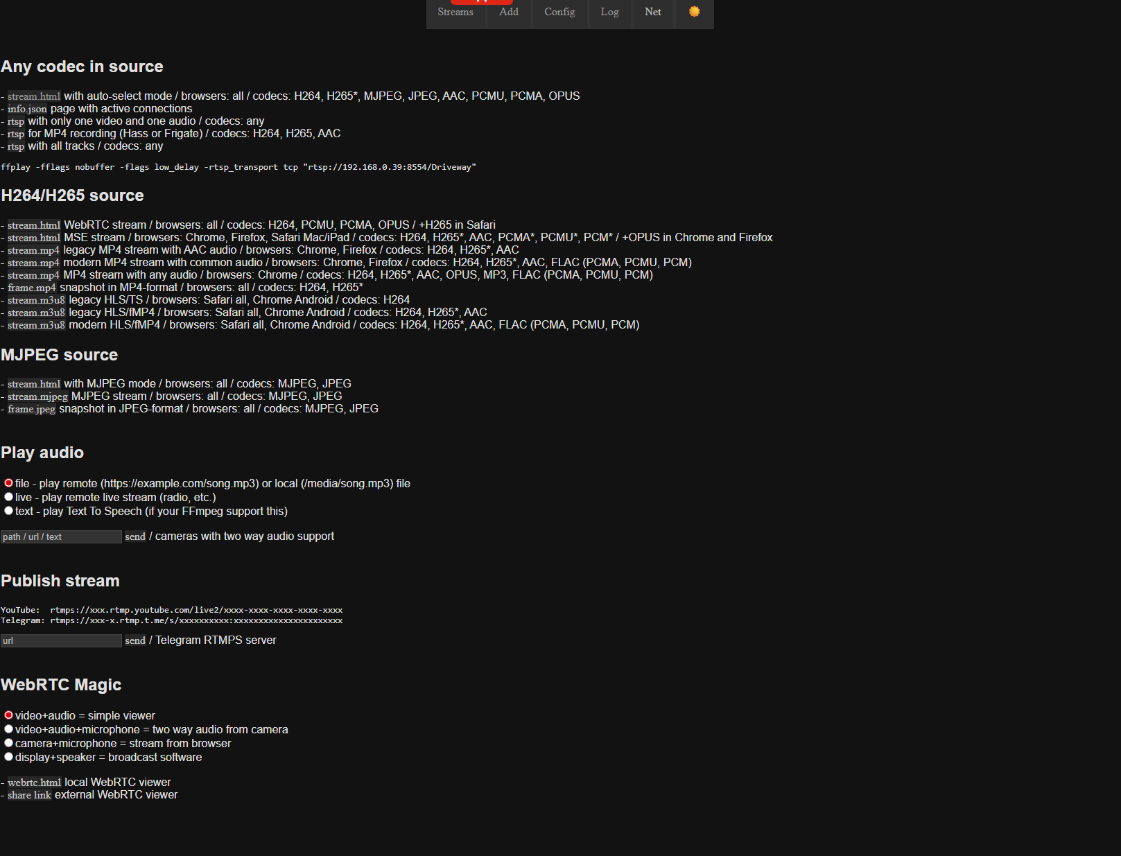

open up your home assistant instance via web browser, when you remove it from homekit, you should get a notification that ha detected a home assistant device in side menu at bottom, enter home kit code and its in :).
if you want a more stable feed in home assistant, add the addon go2rtc
when installed got to go2rtc and click add

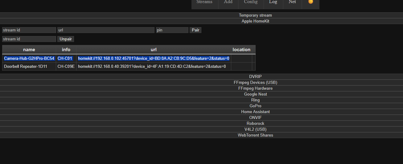

click on apple home kit

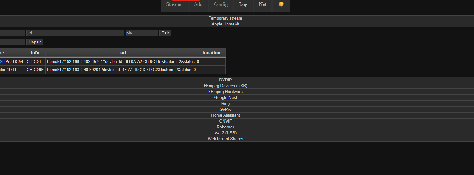

you should see a option like this ABOVE and your doorbell should be listed, copy the url listed
you only want the url, then under go2rtc conig make sure you see this (we are using the g2 pro listed for referance here.
streams:
  doorbell:
    - "put your url here"
    - ffmpeg:aqara_g3#audio=aac#audio=opus#async
if that fails use
streams:
  doorbell:
    - hass:Camera-Hub-G2HPro-BC54
you get the name from the apple homekit option under name, so -hass:“name of the camera”
only do this once its added into homekit on homeasstant.

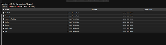

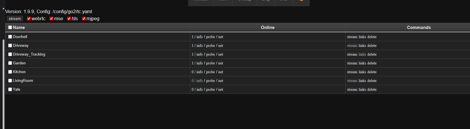

once saved go2rtc config and restarted the addon go to the interface and click on links (right hand side) of camera your wanting
go2rtc will then give you links for all these amazing options to use in home assistant.
