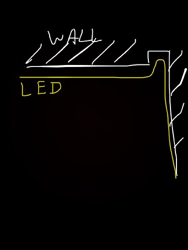

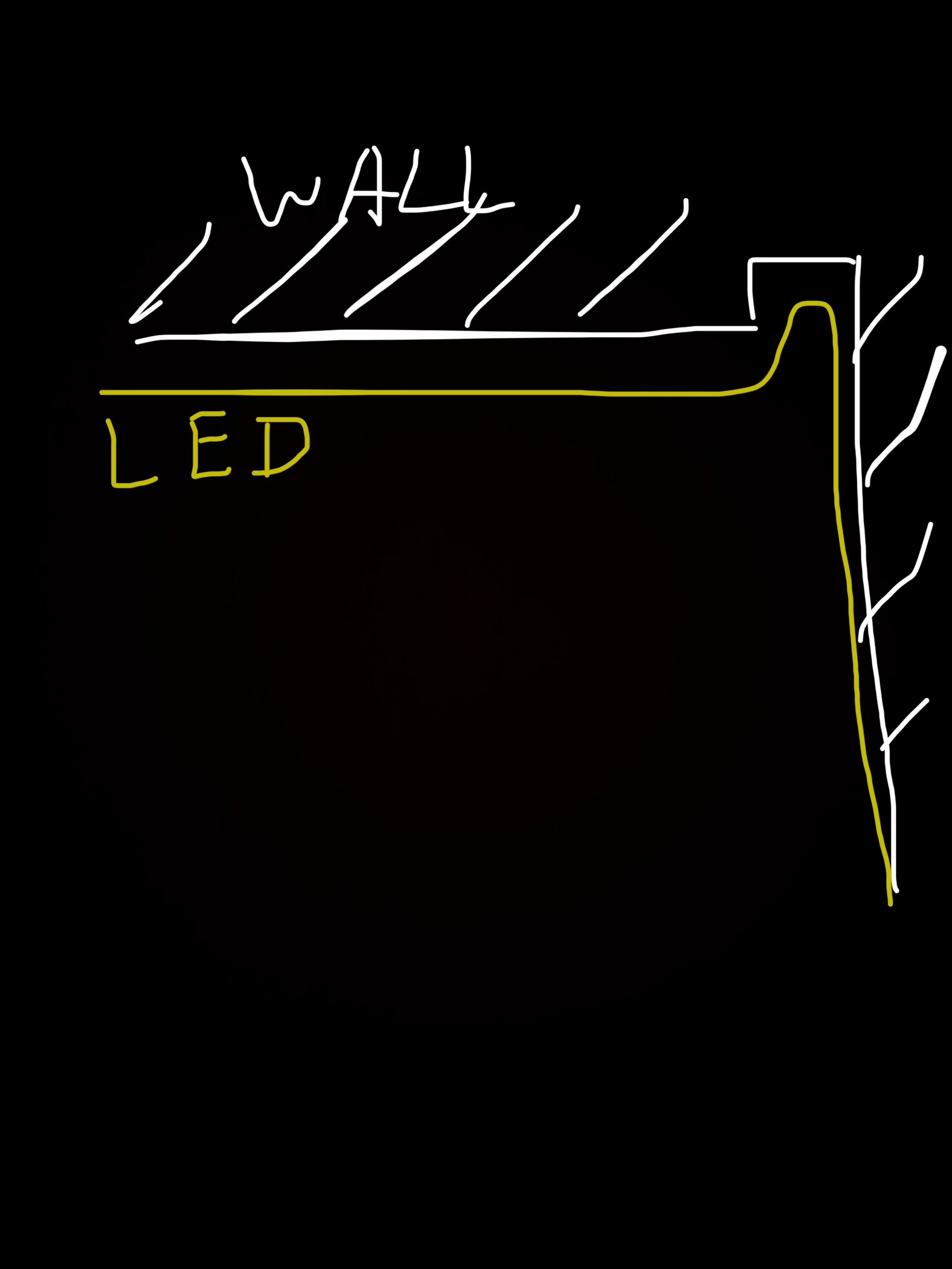

If you’re installing it along the wall, then the trick is make a nook in the wall to make a perfect 90°.
The nook is masked with a shade that diffuses the LED strip light and hides the ugly electronic elements when it’s off.

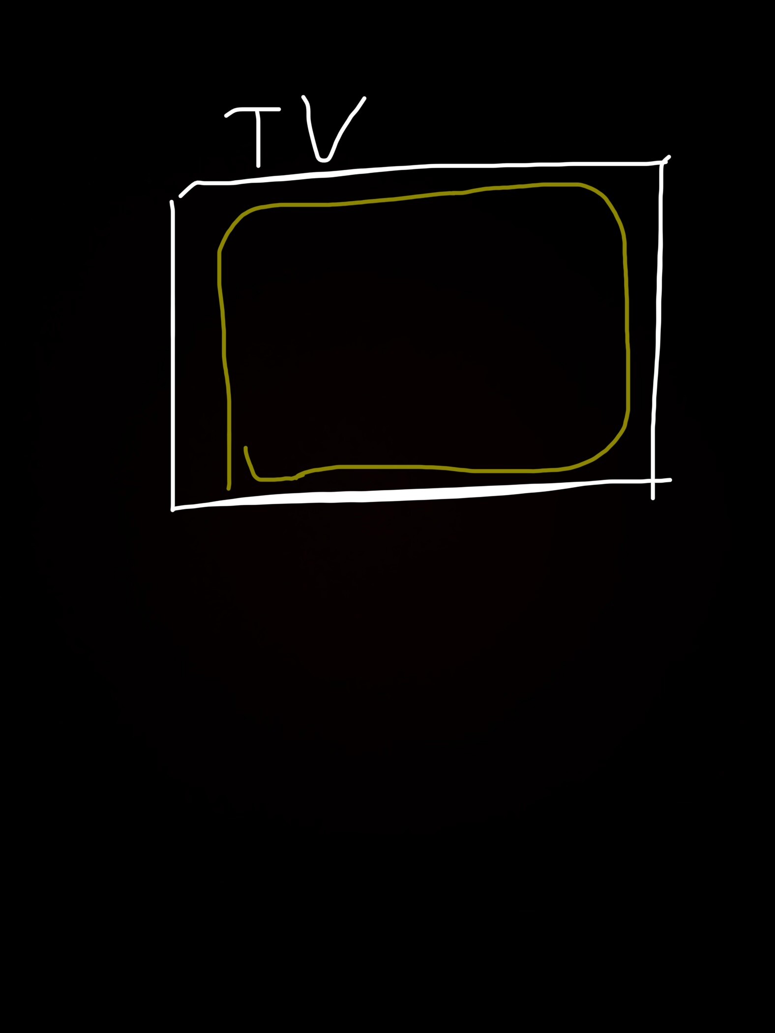

If you’re installing it behind the TV, just make rounded corners, you don’t need to make perfect 90°, because the light will be diffused anyway (due to the distance from the wall).
You can just overlay it a bit at the end for full coverage.
Just remember that Aqara LED Strip T1 needs has 20cm sections. For example: you cannot cut 310m, it needs to be 320cm.

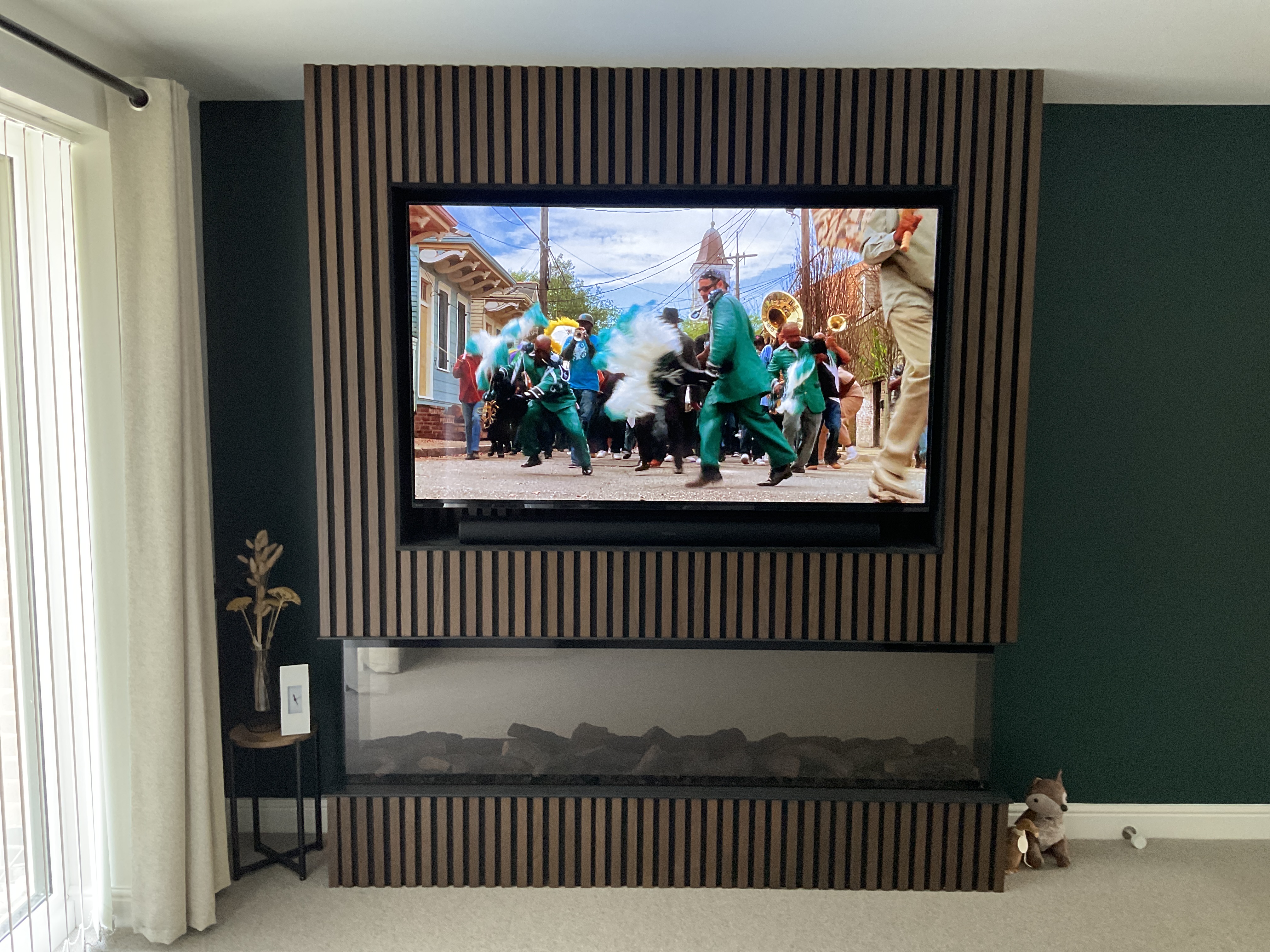

As an alternative, I’d consider putting the T1 strip to the underside of the upper cabinet, or to the left and right sides.

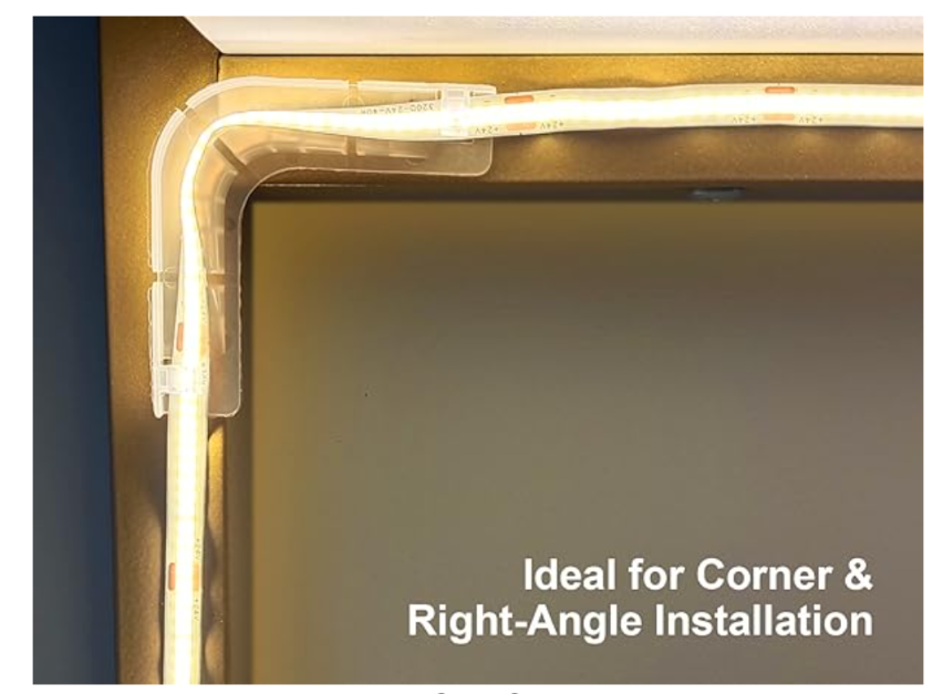

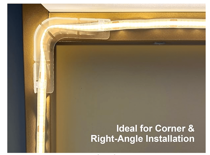

These work pretty good if you don’t want to cut the strip.
https://amzn.eu/d/05MEVvIu
Thanks for the advice. I went with those fixed round corners…
