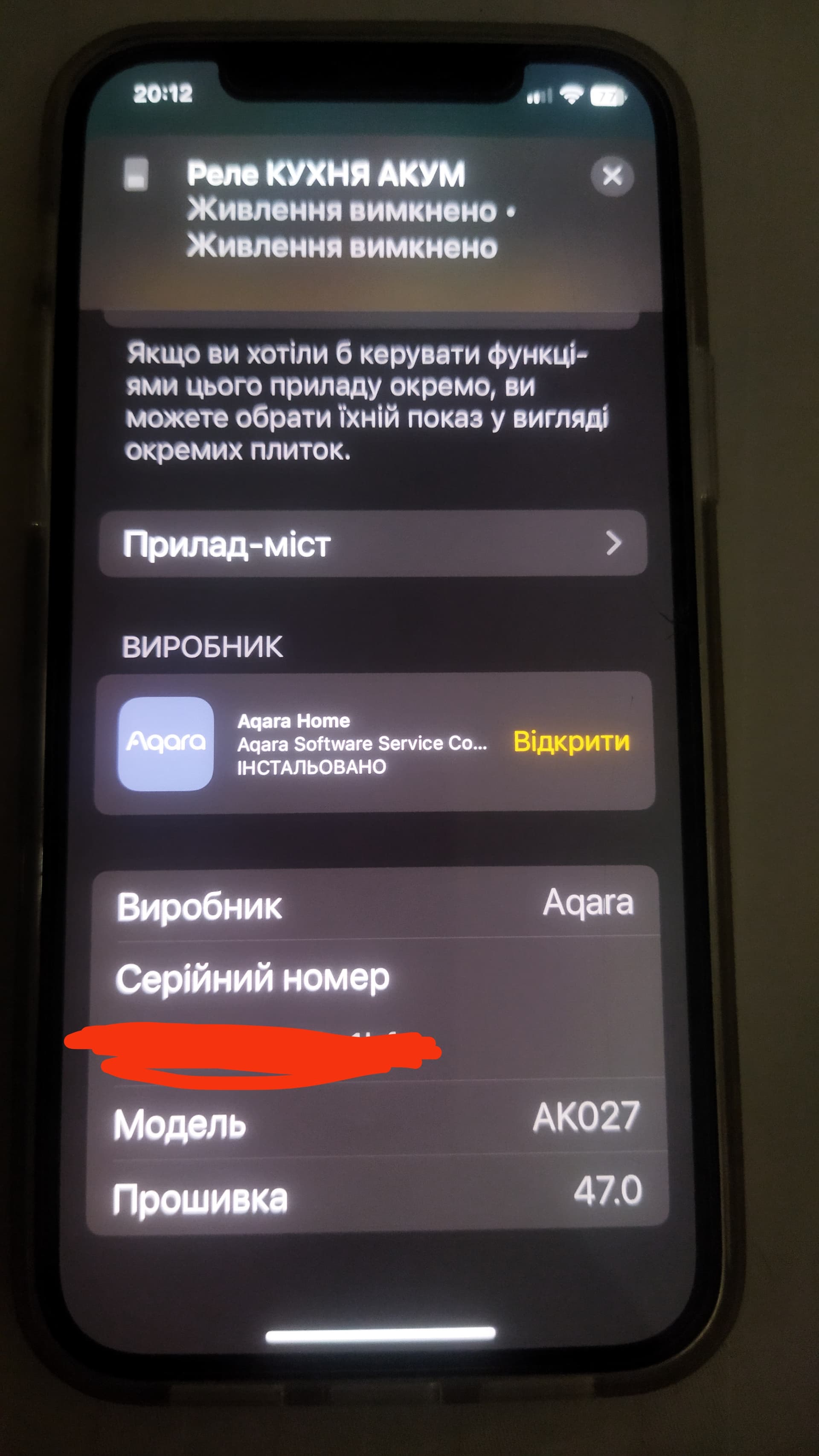

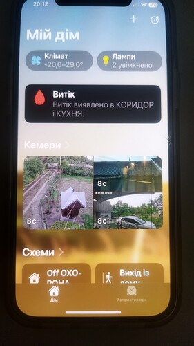

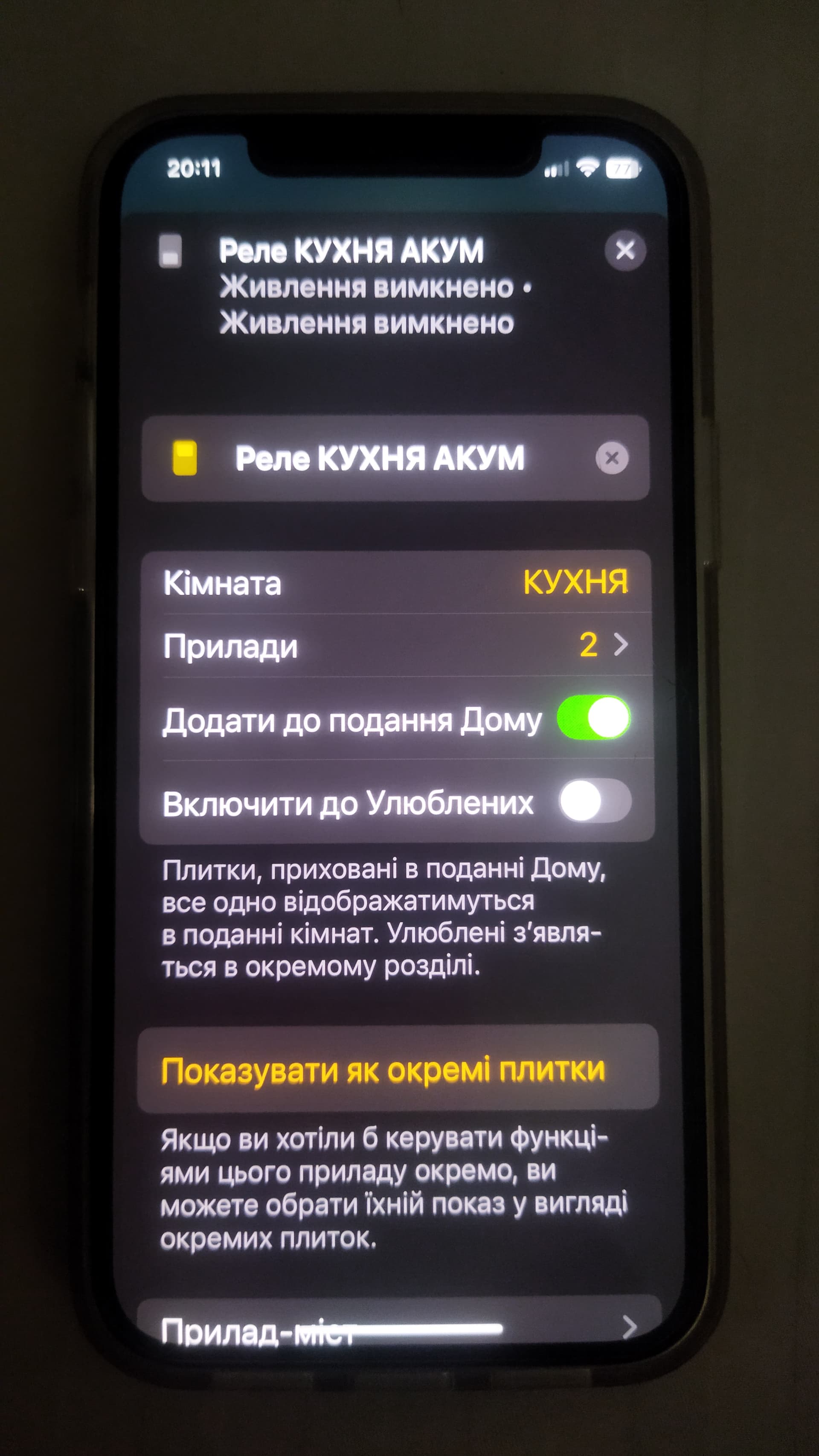

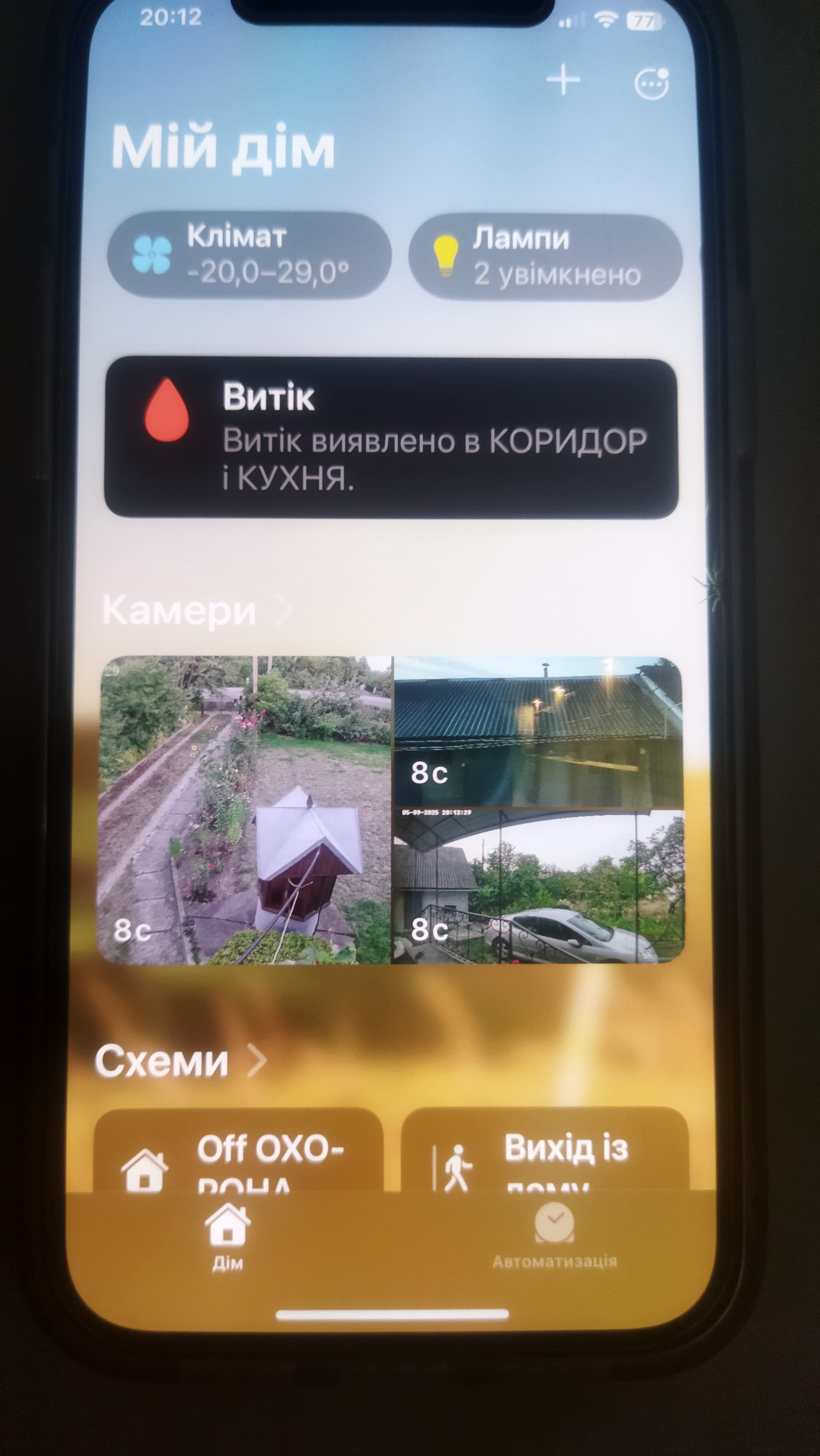

Maybe wait a while and the server will register. By the way, did you set the gateway with My Home (Homekit)? I connected and I see all the T1 relays. I’m attaching the screenshots.
