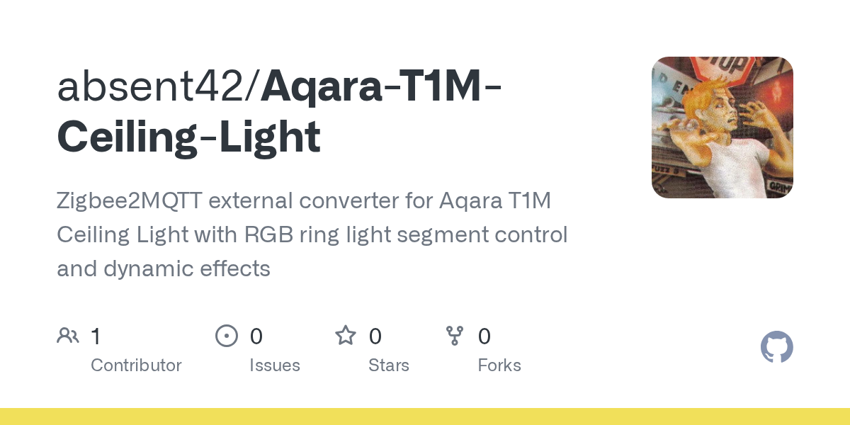

T1M Ceiling Light RGB ring support in Zigbee2MQTT
Linked below for testing is a new Aqara T1M Ceiling Light Zigbee2MQTT converter that supports ring light RGB segment control and RGB dynamic effects.
Each of the 26 ring light segments can be assigned an individual colour in static mode, and six dynamic effects can be activated, each with up to 8 definable colour slots, effect brightness and speed.
In the future I’ll add a Home Assistant blueprint for easier segment and effect control in automations etc.
If you use a T1M with Zigbee2MQTT please test it out and let me know if it’s working alright for you.
