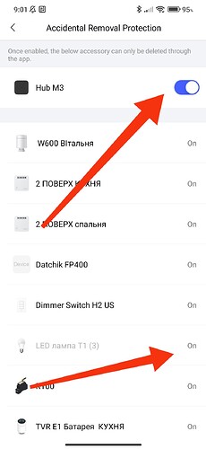

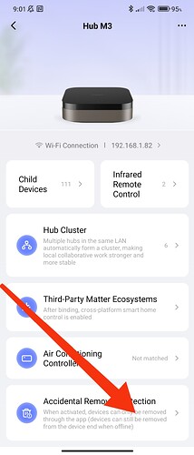

Hello, If you are using Aqara home, enable the “prevent device removal” feature on the gateway.
Thanks for the suggestion. What does this option do? It does not seem to be related to do hub. At some point the bulbs start flashing and the hub shows the device as having lost connectivity.
I’m talking about this.
Thanks @gafich10
My bulb was connected via Thread, so I wasn’t using the Aqara app. I switched it to Zigbee and activated this. Hopefully this fixes the issue; otherwise, I may need to switch to different bulbs.
