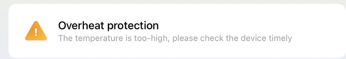

I have a large set of T2 GU10’s and last night 1 bulb turned itself off. The bulb in question is part of a group of 4 that are always on/off at the same time.

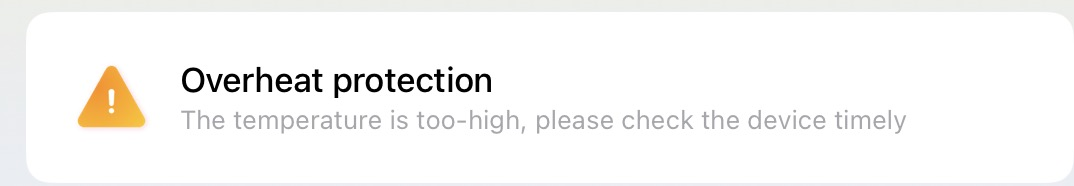

In the app, the bulb now shows the following error…
It’s now been off for 12 hours. Is there a way to recover the bulb from this or is it now dead? If so not good for an expensive LED bulb :frowning:
Thanks
Just turn the power off, wait 10s and on again. It never clears this status if you don’t cut the power.
You don’t have to wait 12 hours. You can just wait a few minutes.
So just use the physical switch basically.
Personally I recommend just turning them off (cutting the power) immediately after the overheating error. Even if the LED is off, the internal electronics may be still working. But you will be ok if you don’t do it, that’s why this safety feature exists (so it doesn’t automatically turn on and immediately overheat again)
I has this problem a few times (I have those installed in my kitchen hood and they overheat if there’s a lot of steam) and that’s how I know
Thanks, that seems to have fixed it.
Odd that only 1 bulb overheated when 3 others are nearby and all one for the same periods of time.
Thanks
Nice. Is this 1 bulb near a vent or was there a kettle nearby?
Not more than any others. Strange!
Yes, strange indeed. Let’s hope it doesn’t happen again!

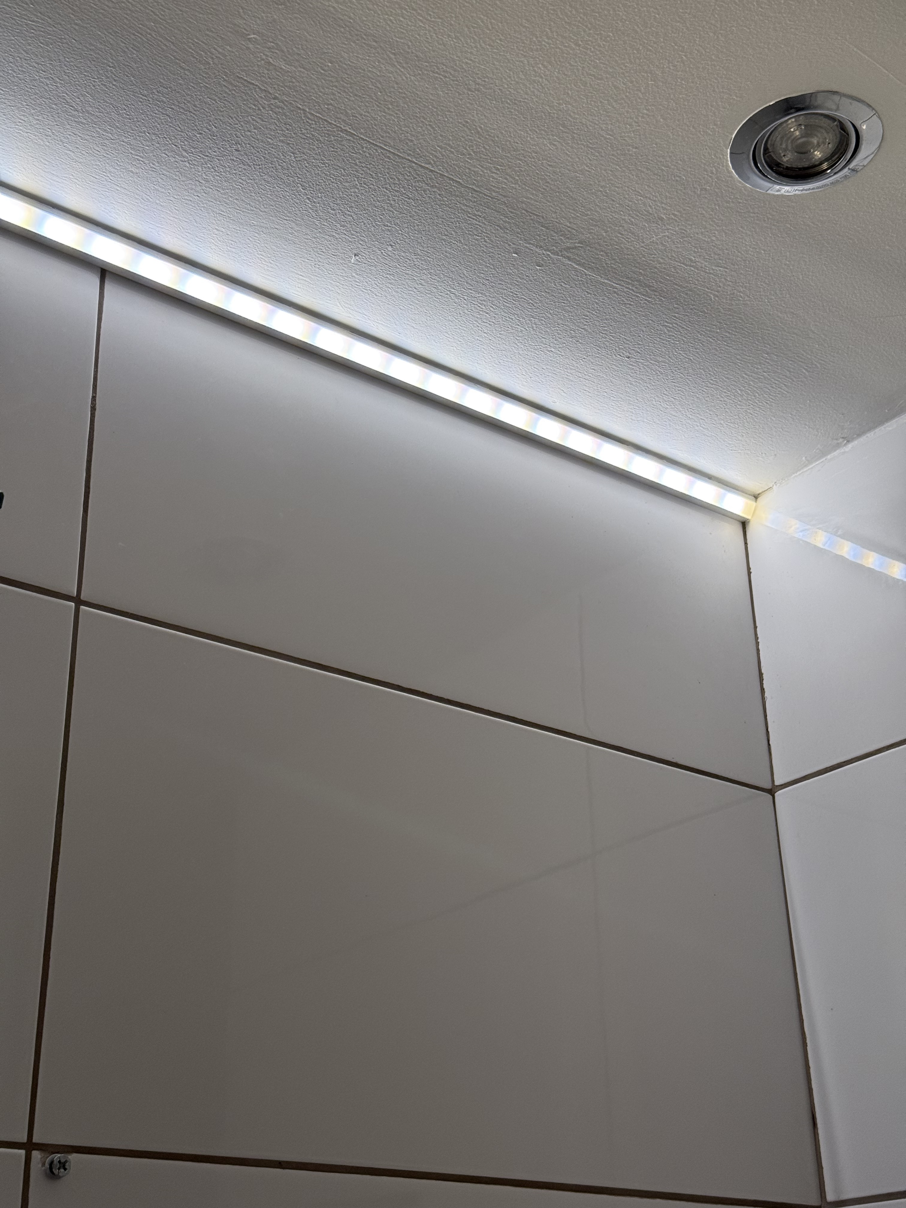

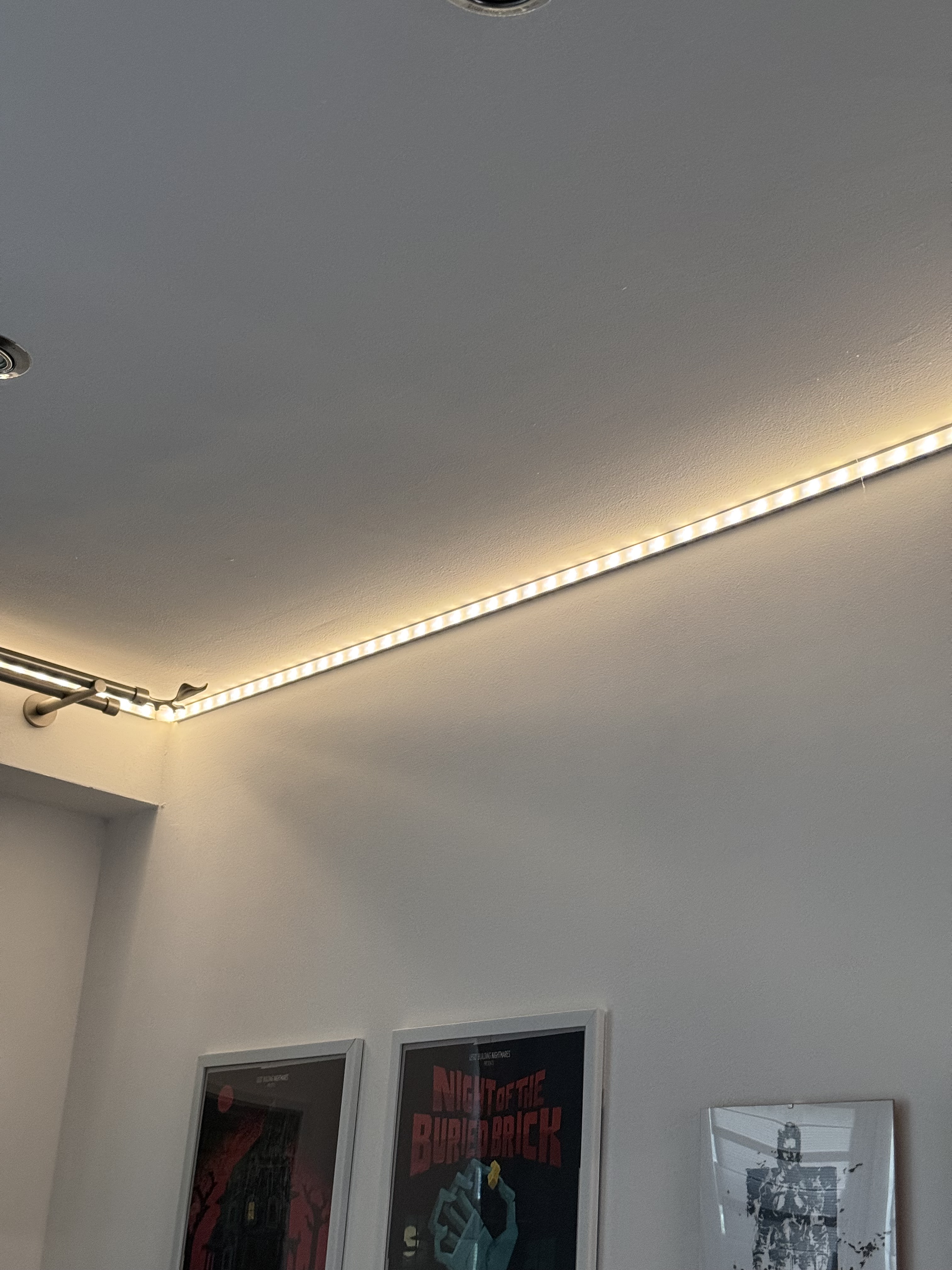

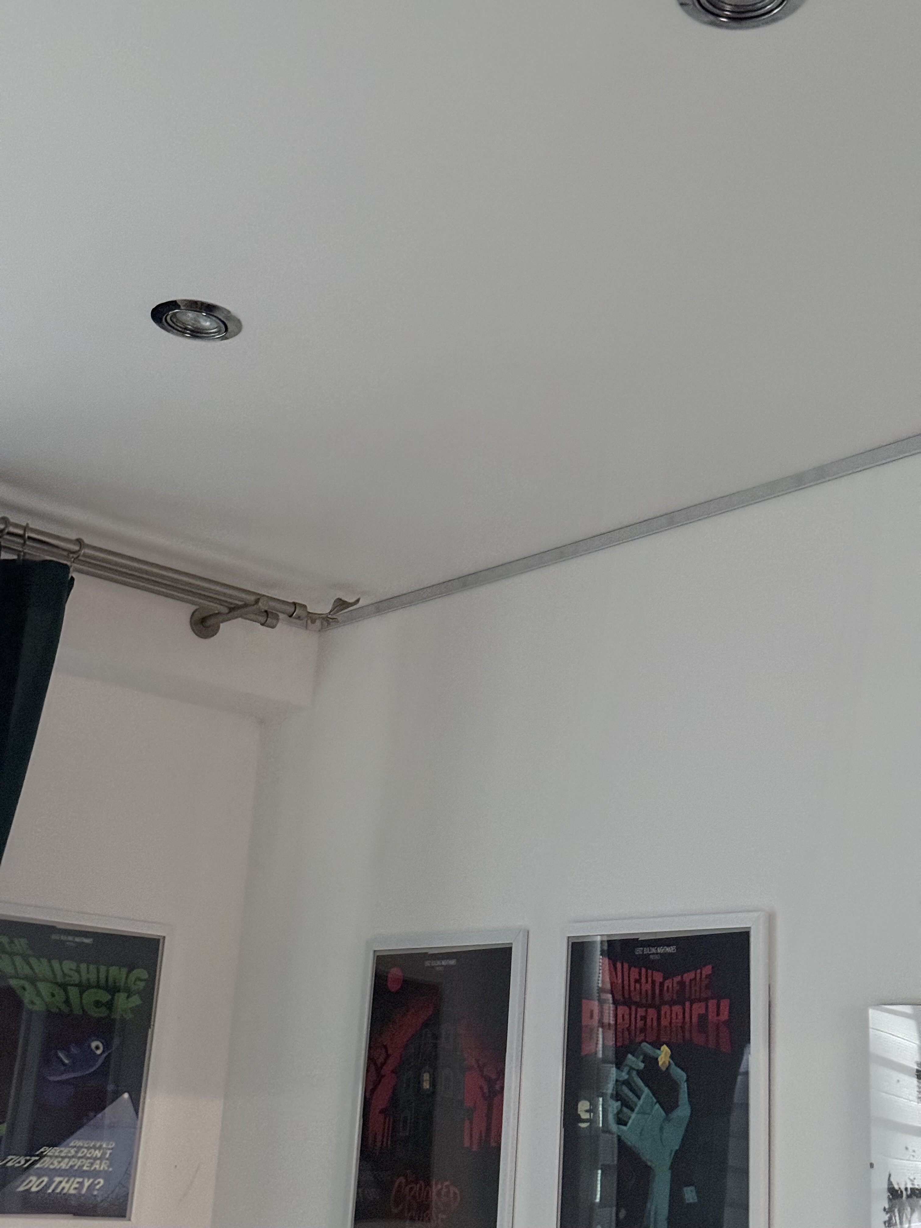

My LED strips were installed with a special channel and two sided tape, so it was not exactly a renovation. An LED channel (that you just glue to the wall) is dirt cheap, so the whole “upgrade” cost me just the price of the 8m of the Aqara LED Strip + about 40 EUR for the channels.
So the old lights had to stay - and as they were too strong (and I didn’t liked their warmth), smart bulbs were easier to do. And I upgraded them a few months later (so it was easier on the pocket).

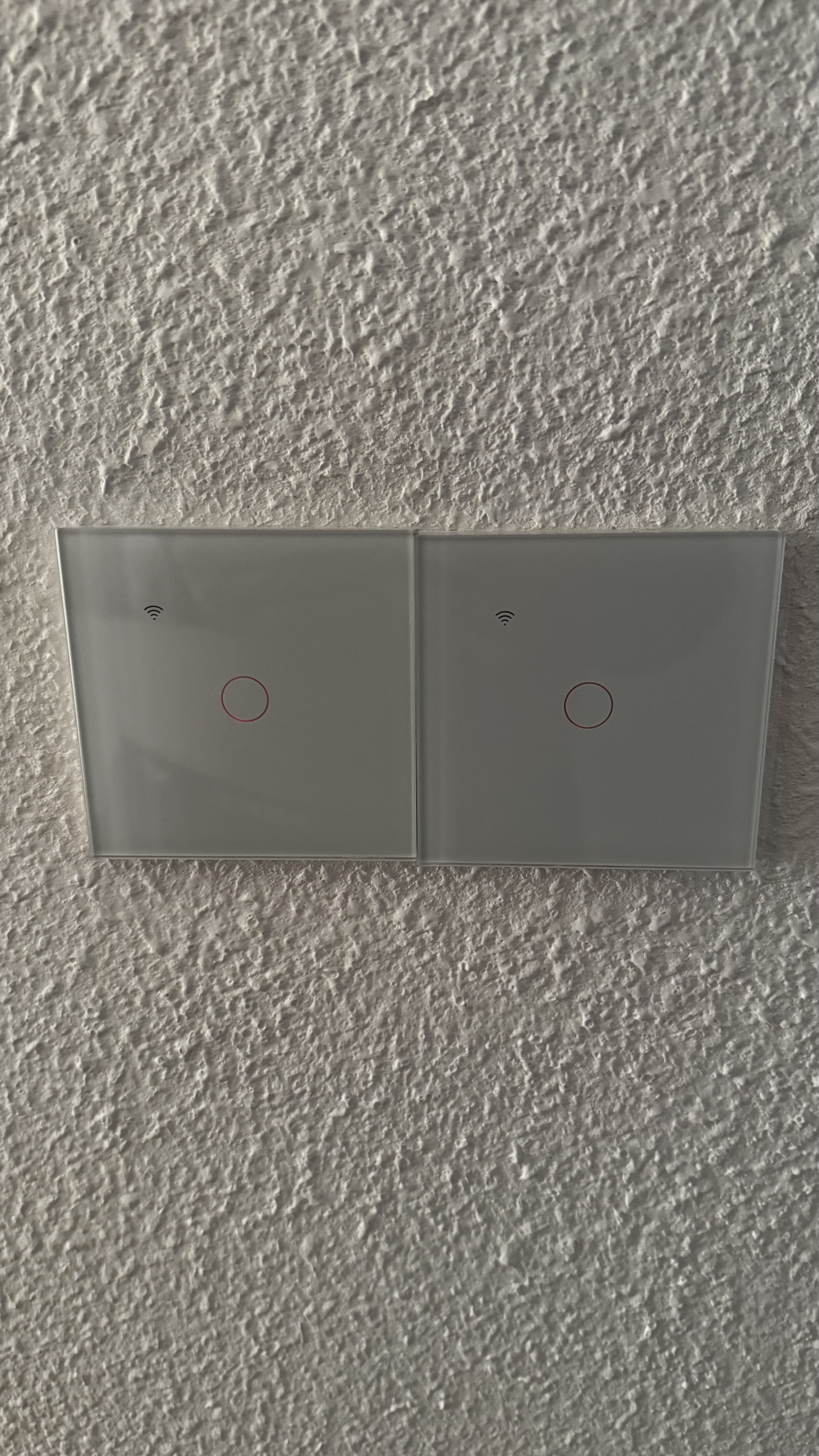

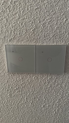

Well I am living on an rental apartment that is why I do not need to invest so much even so I changed all my switches with touch switches as blend better and I like them more then normal smart switches also cleaning the panel is much easy too this 2 control my living room lights and they are matter so I do not need an app for them beside Apple home app.plus my longing room is not so big to install LED strips on the ceiling to much work and also the cost will be way to high to do them right
