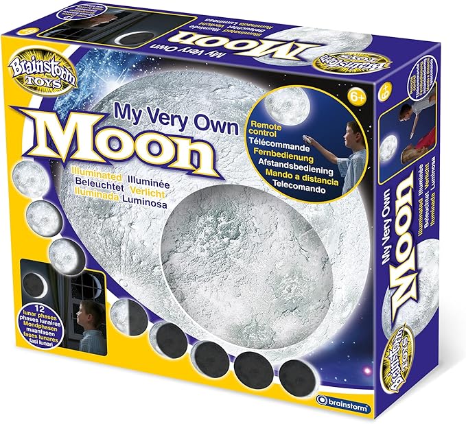

So I purchased one of these 2 years ago for my son,
its £14.99 in the uk and shows all moon phases based on a single ir press, so 1 press is on full moon, 2 presses waxing, 3 presses cresent ect etc it cycles through each changes to each phaze.
So the task using any IR blaster compatitble with home assistant is to make this device smart, so when a smart button is pushed it cycles to the correct moon phaze that is actual acoording to the moon phaze for were you are.
