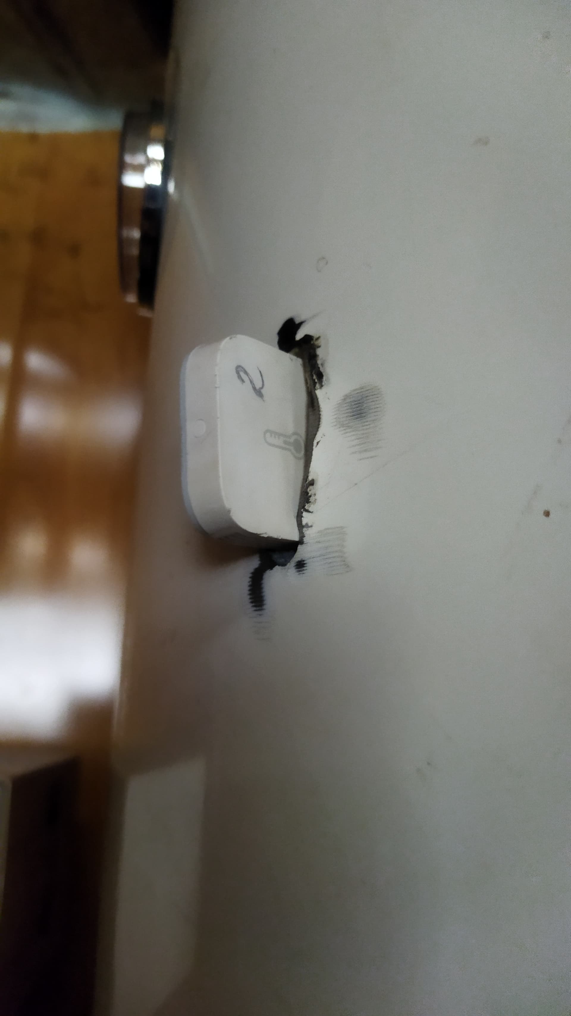

I cut a hole in the thermal insulation of the boiler and inserted an AqaraT1 temperature sensor into it (see photo). I applied a load from an electric boiler (1.5 kW) to the Aqara relay. To protect the system from overheating (emergency), I set the native heating control system above the parameters that I set in the automation.
In the automation, I use water heating during the cheapest period of electricity costs (I have three electricity tariff zones). At the most expensive time, I turn off the heating automatically. During the standard price period (electricity), I set the heating in case the water temperature drops below the set one.

Interesting, but looks dangerous.

You didn’t read it, the central boiler protection works constantly, the control temperature is lower than the factory control temperature. My system works within the boiler control system :slightly_smiling_face:
