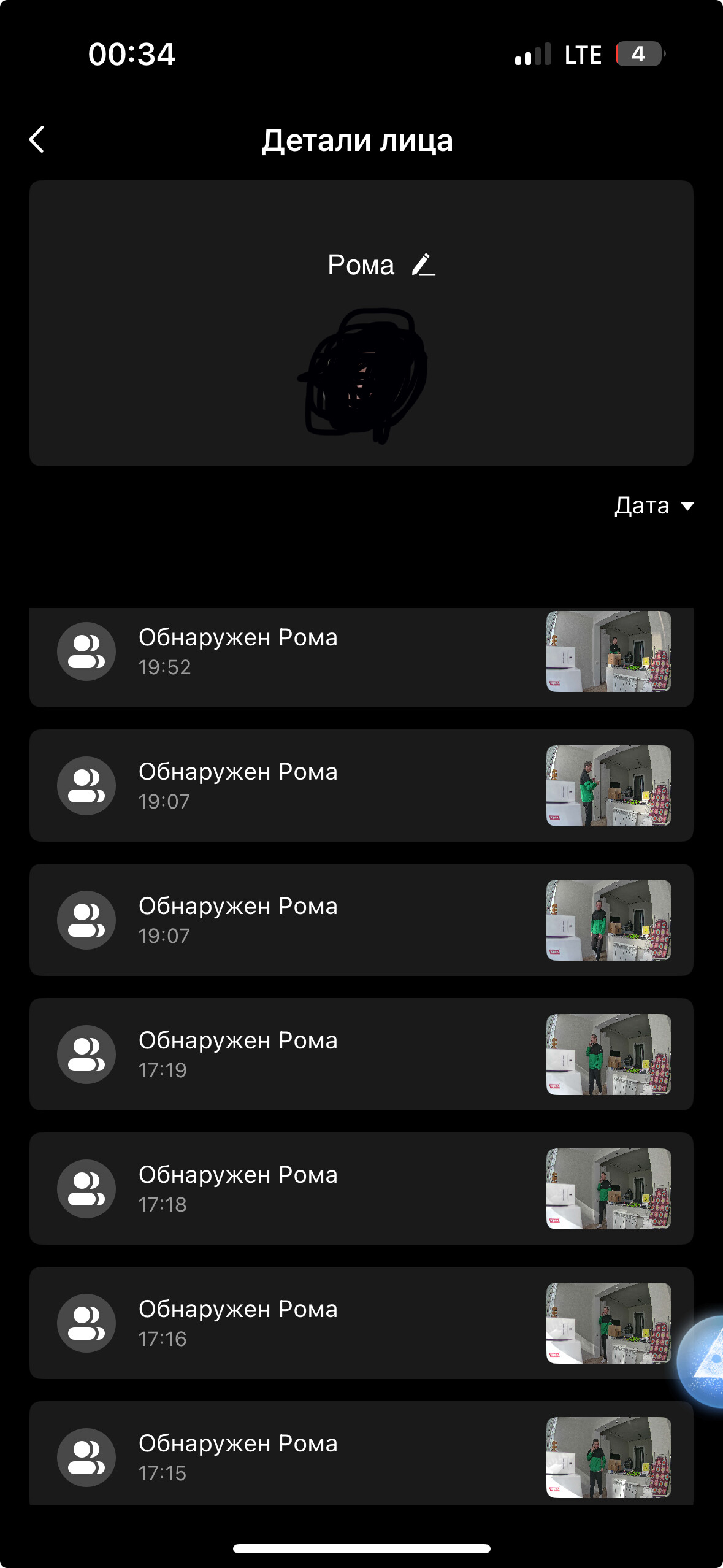

It is very strange that this does not work for you, for me face recognition always works and very well, I checked several times and it works well, it recognizes me and the child, almost immediately and you don’t have to stand in front of the camera for a long time.
