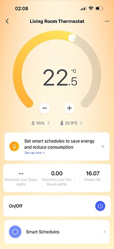

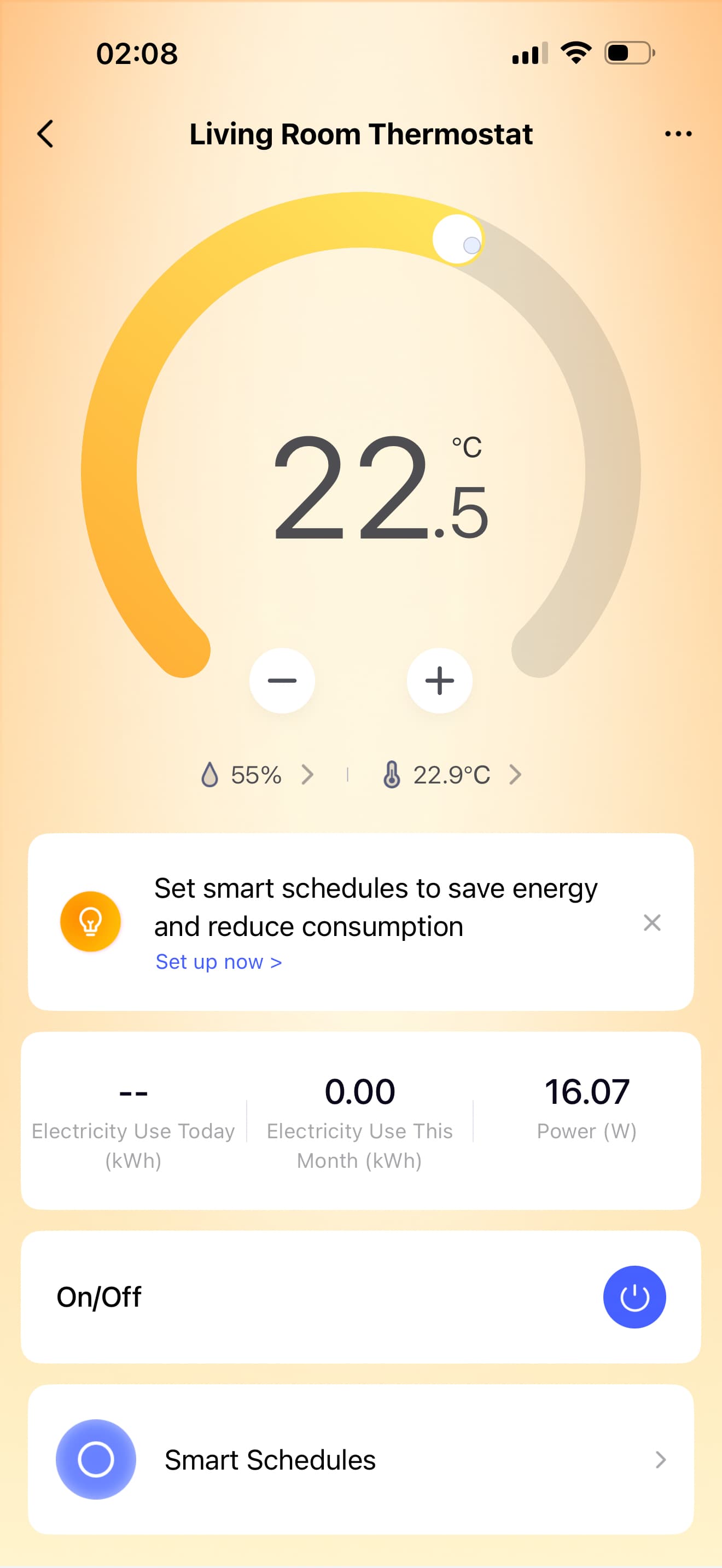

If you look at the attached screenshot, you can see the set temperature is 22.5 and the current is 22.9 yet the system is still on! That is not okay and it’s making my home warmer than comfortable.
It’s not the Matter accessory being out of sync.
It happened when configured as Thread, and when reset and configured in Zigbee. It didn’t happen with the Tado X I has before either therefore it’s a bug with the W500.
