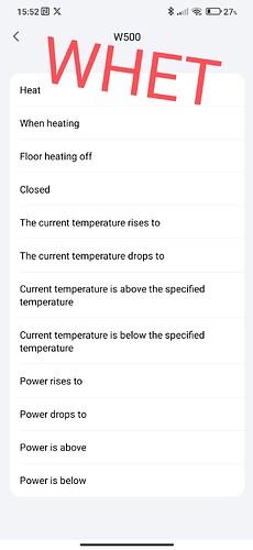

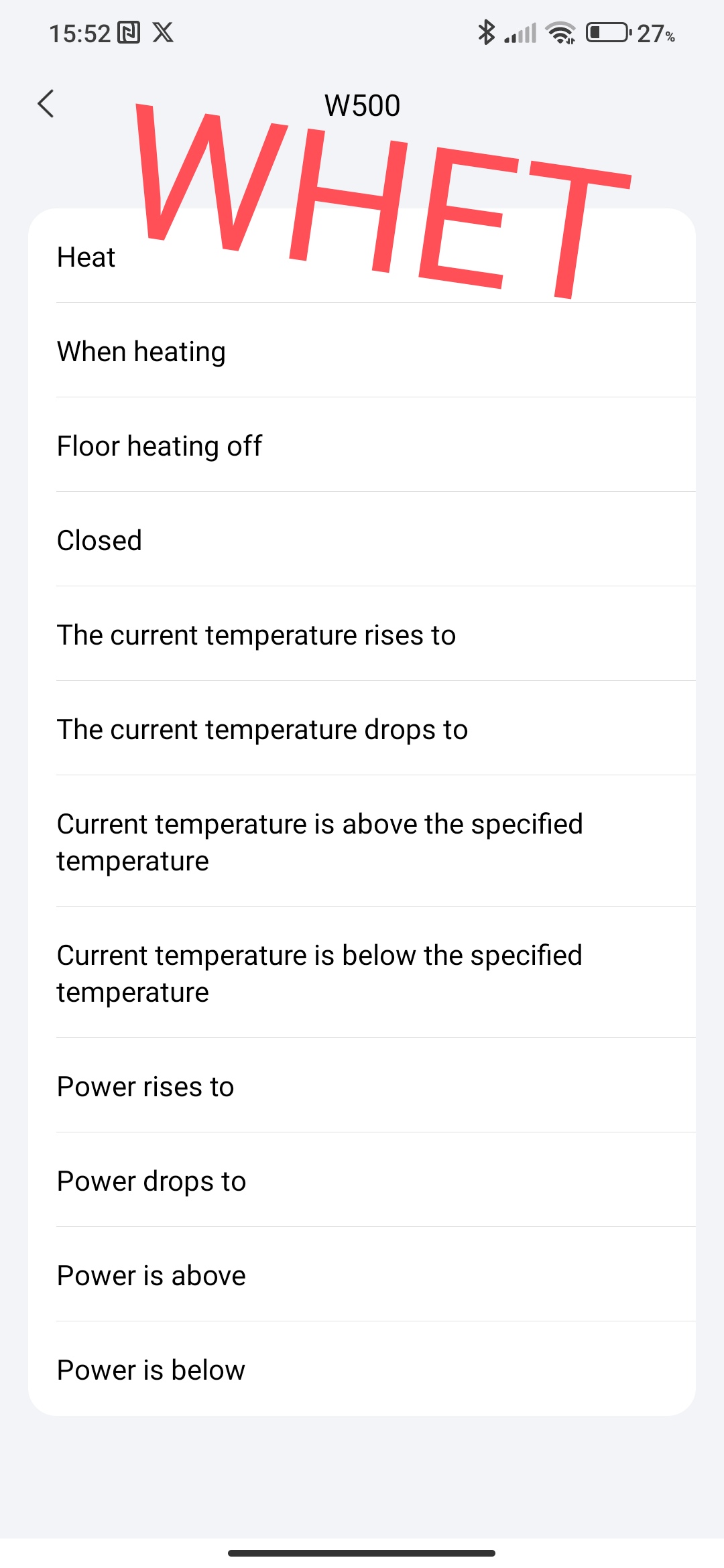

People, has anyone heard when the update of the unfortunate w500 software is planned? :grin: Okay, the remote sensor doesn’t work properly, but the fact that automation can’t be configured to turn the heating on or off is a shame. The device is half-intelligent. There are four different conditions, but they only respond to turning the screen on or off.

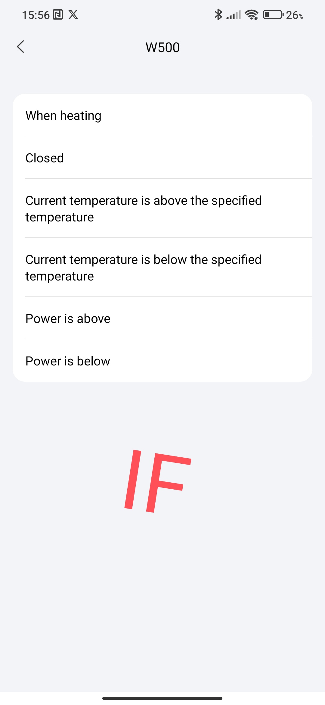

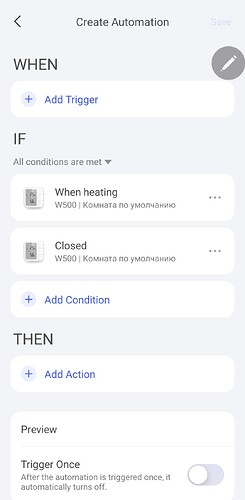

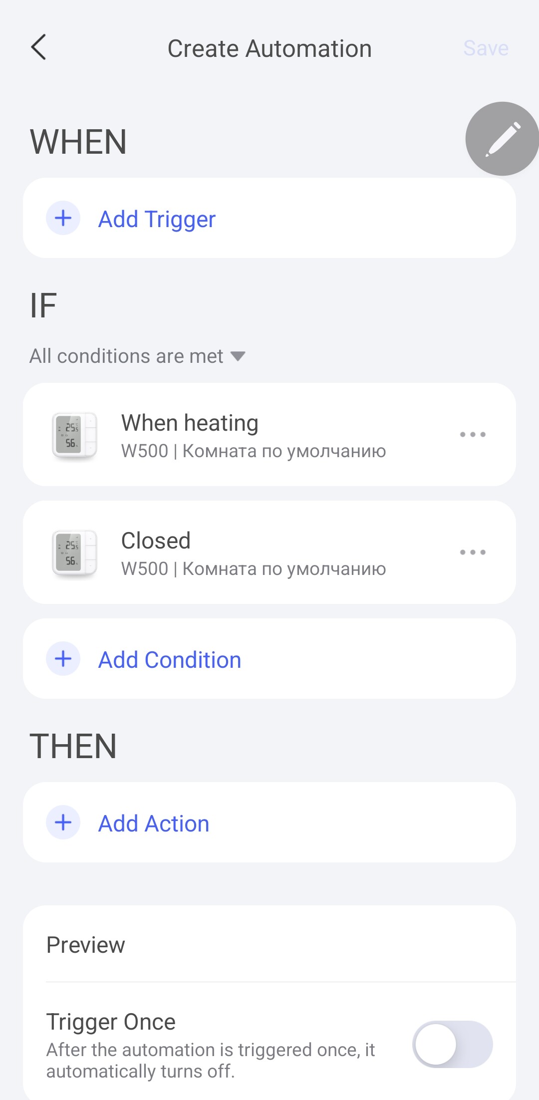

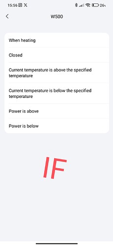

Here is the video. 4 different triggers were created. However, automation initialization occurs only when the screen is turned on and off. In this case, the status of the relay itself does not matter. But the status of the relay is a more important issue than the status of the screen.
Here is the video. Thanks
The same situation applies to the IF category. What is more important in automation - is the screen on or off, or is it still possible that the relay switches the load? Unfortunately, aqara believes that screen status is more important.

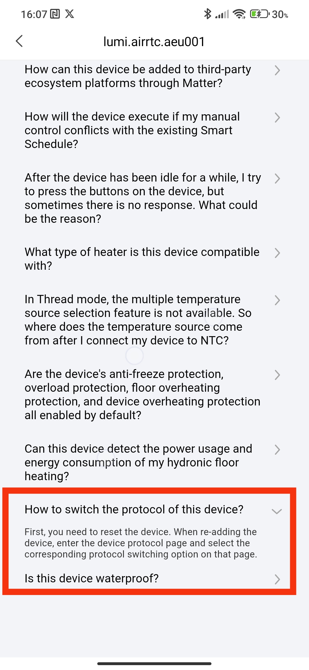

Everything is fine with the W500 relay. You did not connect it via the Zigbee channel, which is why access is so limited.
Here it says how to switch protocols.
If only it were that simple :slight_smile: Everything is activated, all conditions are met, but they all work in the same way - only on the screen. They have different names, but they all work in the same way!
