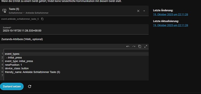

Hi, I´m using shutter switch H2 EU and Light Switch H2 EU in a thread environment with Home Assistant through the Matter integration. I´m using the non coupled buttons as trigger for automations. As trigger, up to now, only the general change of state and attributes works.
Although the device class of the pysical buttons is button, the press action does not work as trigger. It only changes the timestamp of the event.
The state of the event is basically a timestamp as far as I can see. When pressing the relating button, the timestamp changes and triggers the action.
Nevertheless, and Restart or connection timeout changes the state as well and then undesirably triggers the action.
I would expect that only the button press action could be used as trigger.

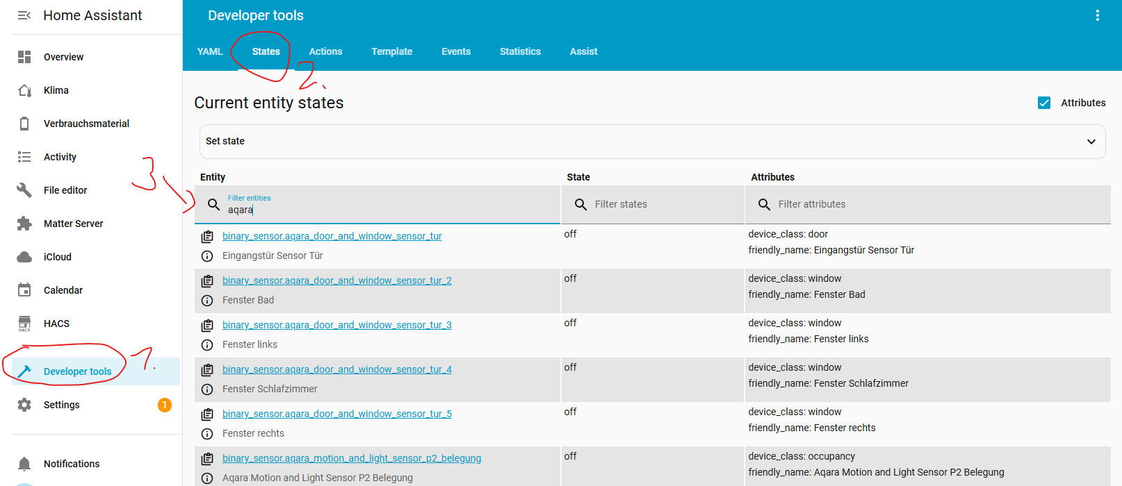

Check entity states

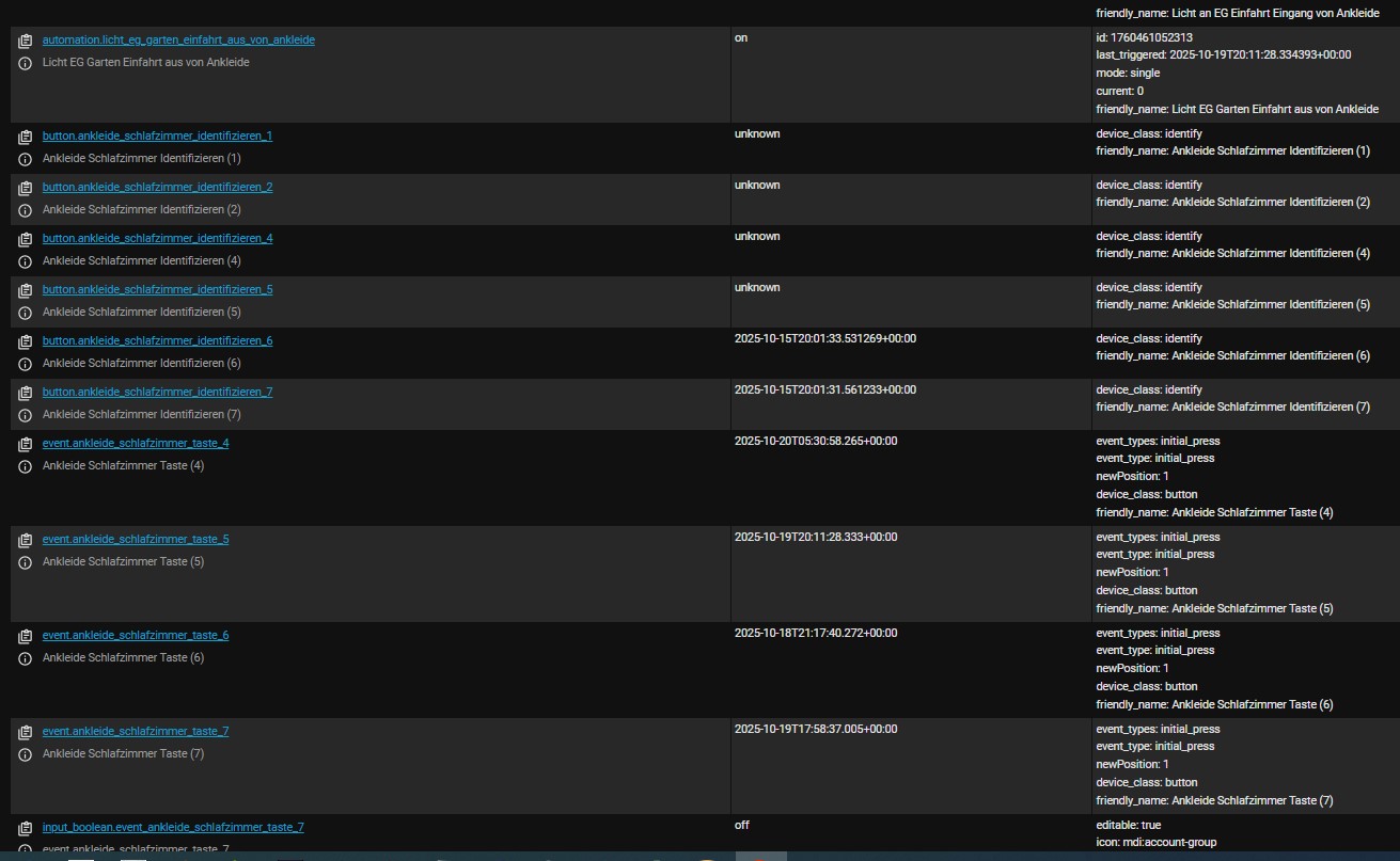

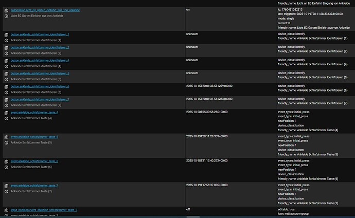

Can you check what the current entity states and event types are?
Otherwise, record the entity states while triggering the buttons.

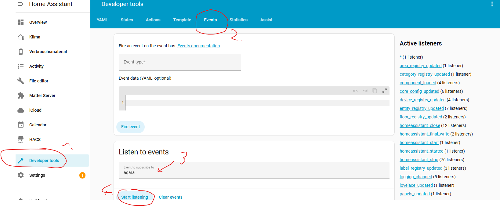

In point 3 in both pictures, you should specify the name of the entity instead of “aqara”.

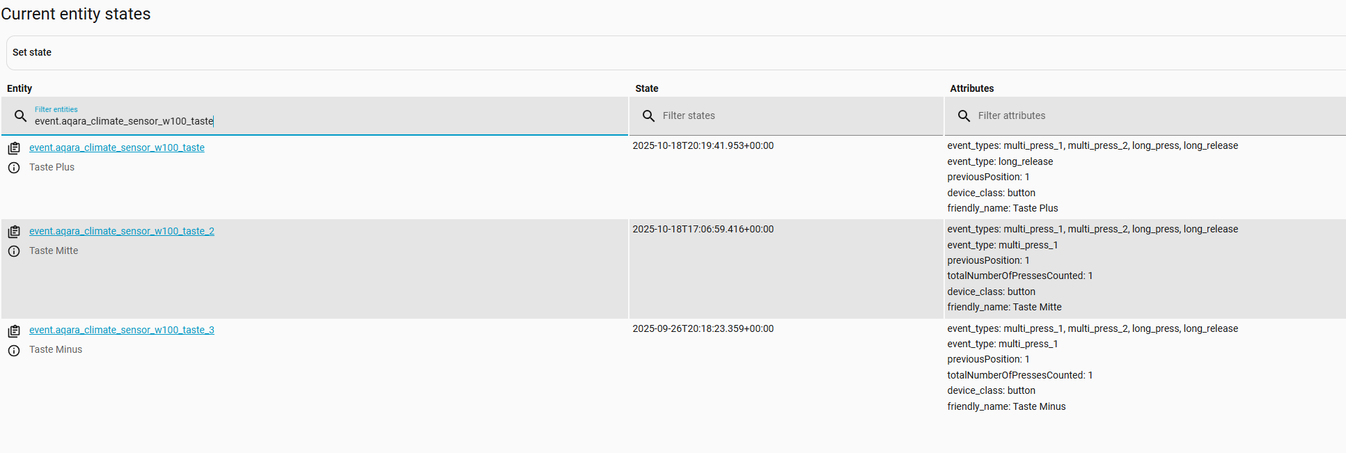

I just noticed that it’s the same with my “Aqara Climate Sensor W100.”

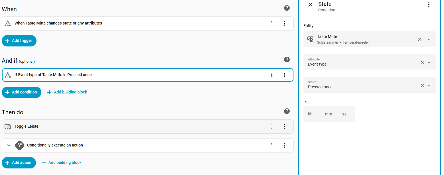

The state is the date and time of the last change. But you can check for the event types (on the right side of the image / Rightmost column “Attributes”). Check if it’s the same with your device.

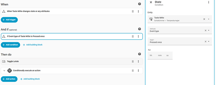

See the last image for details on how it works with automations.
Any status change triggers the event, but then it is checked to see which event triggered it.
  • multi_press_1: Button pressed once.
  • multi_press_2: button pressed twice.
  • long_press: the button is pressed and held.
  • long_release = button released after being pressed and held.
If I remember correctly, I didn’t use long_press because it caused problems.
Instead, I used long_release.
And here is the YAML for pressing the button once to turn a lamp on and off:
alias: Lights on/off
description: ""
triggers:
  - trigger: state
    entity_id:
      - event.aqara_climate_sensor_w100_button_2
conditions:
  - condition: state
    entity_id: event.aqara_climate_sensor_w100_button_2
    attribute: event_type
    state: multi_press_1
actions:
  - type: toggle
    device_id: ...
    entity_id: ...
    domain: light
mode: single

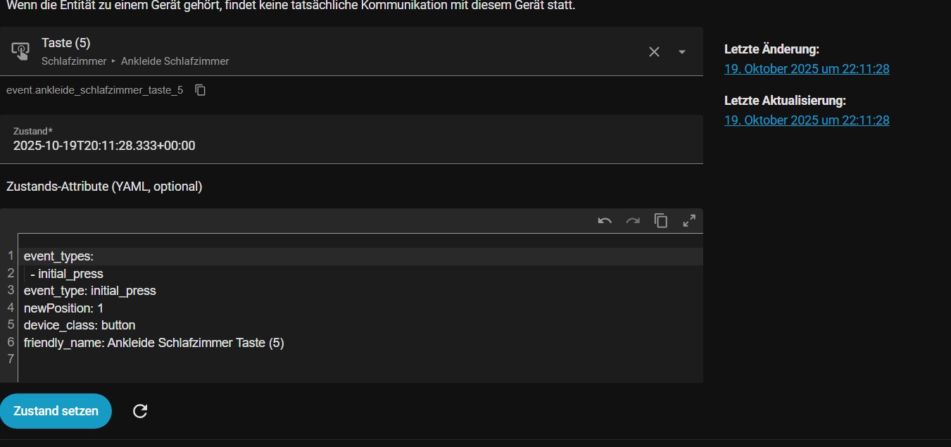

Hi, as event type, only “initial_press” is available.
There´s no other event type available that could be used as additional condition in an automation. It seems that this is not yet (?) fully implemented in thread of Matter maybe.

According to the Matter compliance document looks like Aqara only implemented the single press and didn’t add support for long press or multipress, hence that you only see the initial press event.

You don’t need the condition since the state is ALWAYS initial_press for a button that only has that event, so it will never change. You can remove that block. In fact you never use conditions for buttons, only in the actions section if needed.
You need this for buttons with multiple button press types like the W100, but here it’s not necessary.
