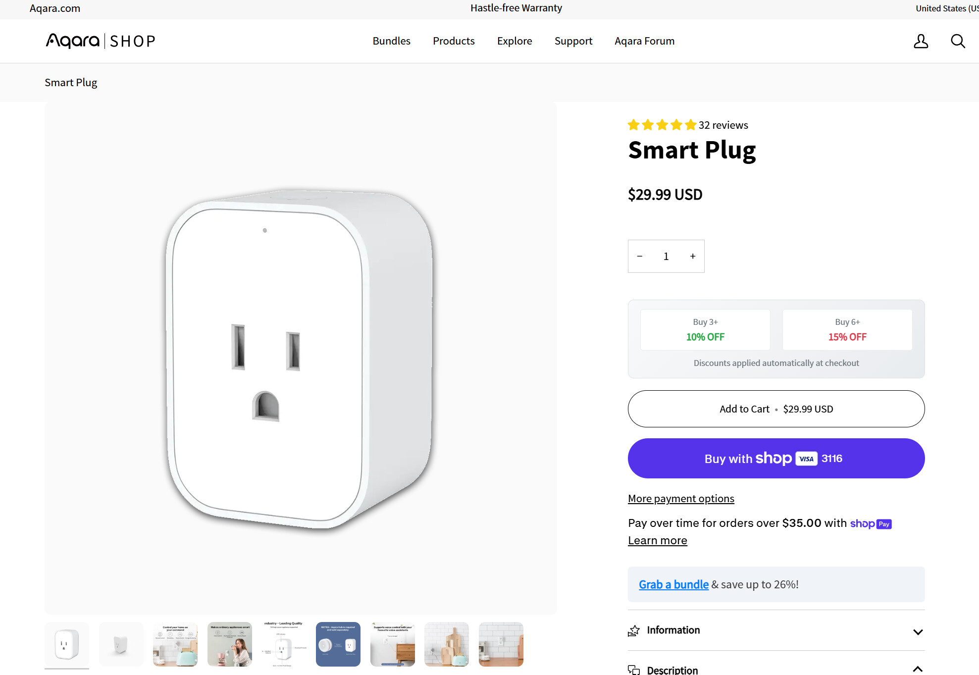

If you are referring to the following Aqara Smart Plug, then I believe the answer is no. The following Aqara Smart Plug is Zigbee 3.0, not Matter over Thread.
Yes, that was my question, thanks

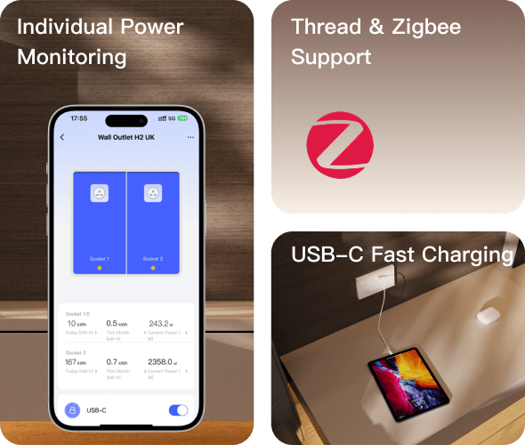

Depending on your country (You don’t say) then Smart Wall outlets certainly provide the capability. e.g. I’m in the UK and the Smart Wall Outlet does act as a Mesh extender/Router.

Are you referring to the following Aqara outlet? If so, I don’t anywhere in the documentation that it supports anything other than Zigbee… :thinking: It can be connected to a Matter Controller when used with an Aqara Hub which supports Matter Bridge functionality.
The OP was specifically asking for a device that would extend a Thread mesh network. Looks like the following would only help a Zigbee mesh network.

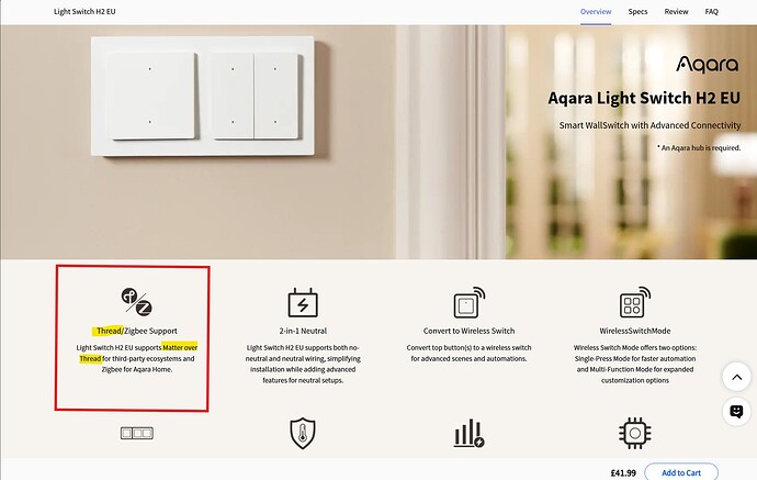

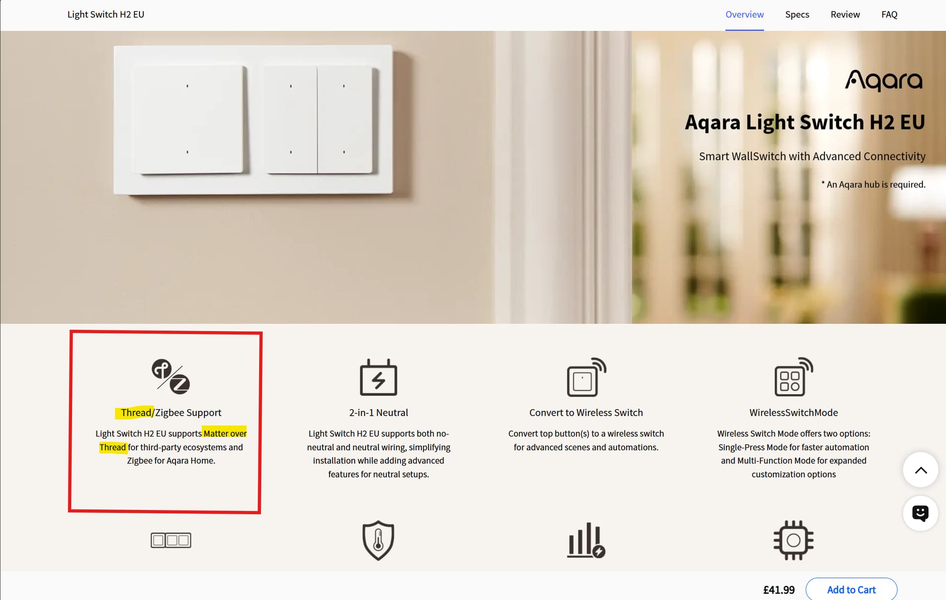

The only UK/EU mains powered device (other than Aqara hubs) that I see that directly supports Matter over Thread is the following in-wall switch.

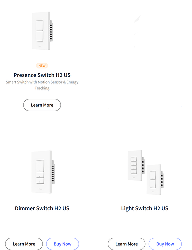

In the USA, it appears the following in-wall switches support Matter over Thread.

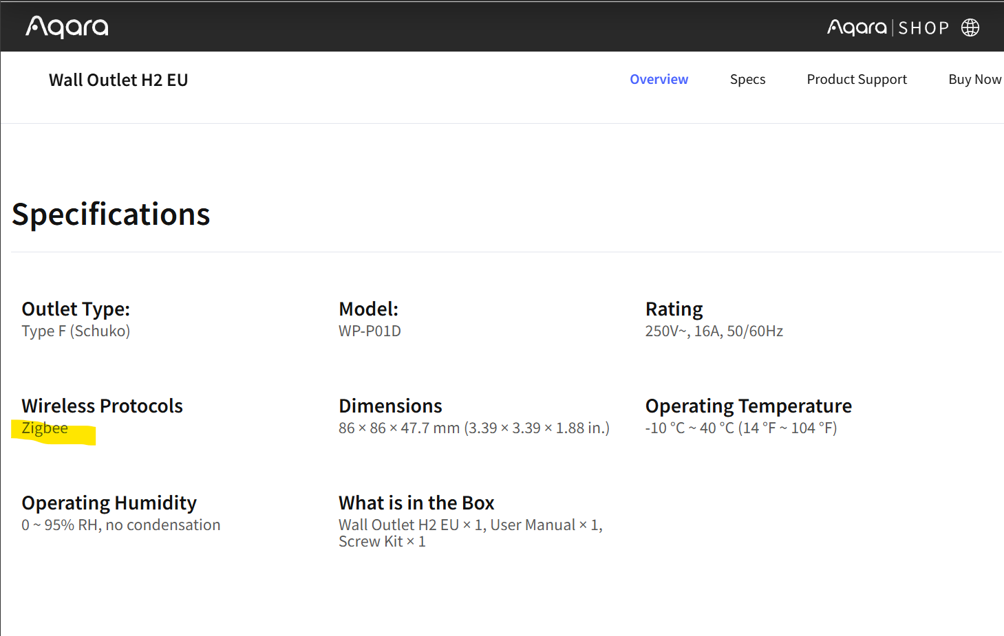

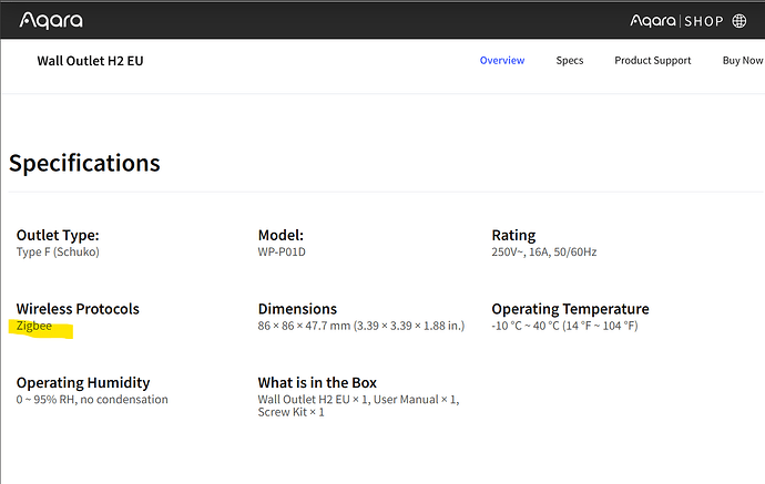

No. As I said, I’m in the UK and the UK Outlet is Thread or Zigbee. As Thread it operates as a Mesh Extender.

So, correct, Zigbee does not act as a Mesh extender.
