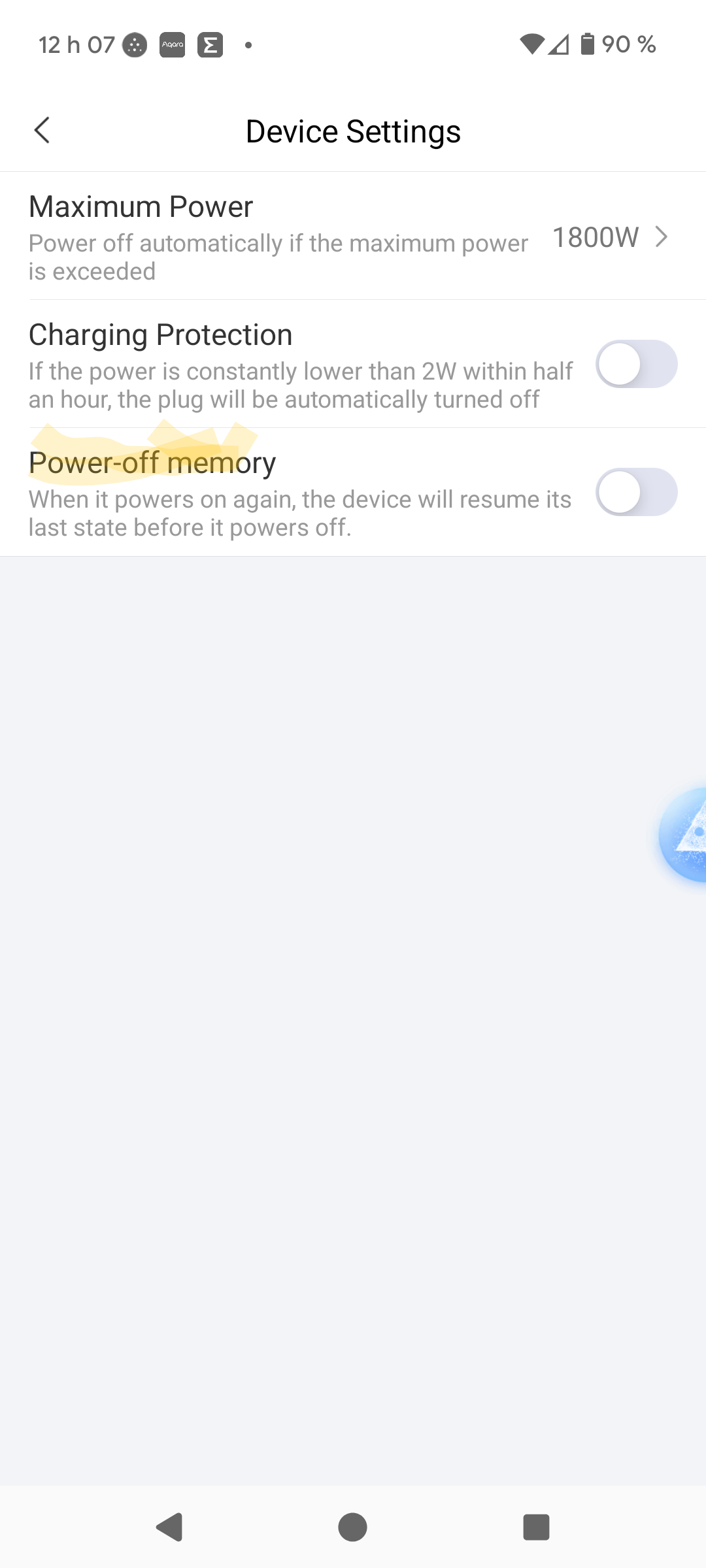

Just to let you know, there’s an option to keep the power off after an outage.
Fo you mean an option of a smart outlet?
That would be really helpful.
Yes. If that option is not enabled, the outlet will remain off after a power outage. I use it for all the devices in my home theater.
