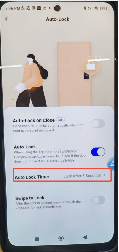

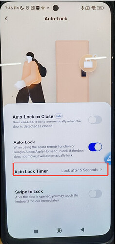

I’ve turned on the Auto-Lock on Close feature for my U100 locks but I’m getting some weird behavior. Sometimes the door tries to relock immediately after I unlock it and before I can finish going in the house and closing the door. After this happens when I unlock the door again, it’s also tried to relock a second time while I’m unlocking it (basically fighting me). Really confused why it’s doing this since I have it setup to only try to auto lock after three minutes. Any suggestions for how to fix this or better configure the auto lock feature?
You can try to change the auto lock timer to 5 seconds to see if it work .
