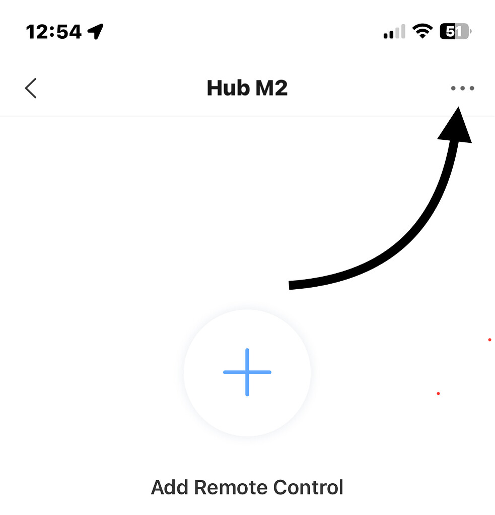

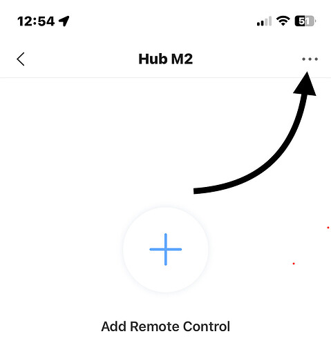

Does this video and guide help you?
https://www.youtube.com/shorts/v6yxzcsc1y4
I saw that post but unfortunately one of the prerequisites is having a Aqara Hub which I don’t have and originally didn’t need for the U400. Matter code was listed on the U400 lock.
