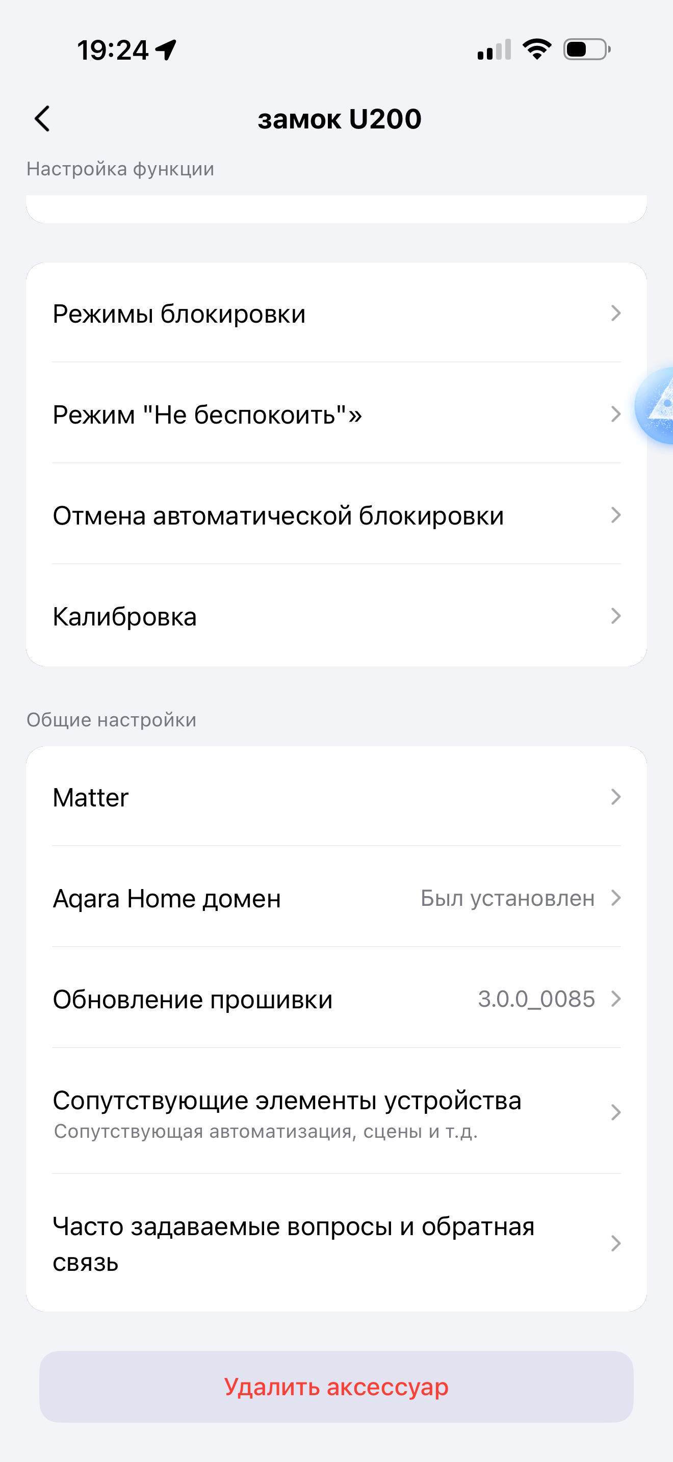

U200 After the last update, jerks began to appear after the opening
The problem with the lock appeared after the firmware update, the lock clicks the gearbox for a while after closing.
It’s not just me who has the problem, my friends have it too.
Listen to the sound after opening and after closing, the gearbox, something turns off. I did the calibration several times
