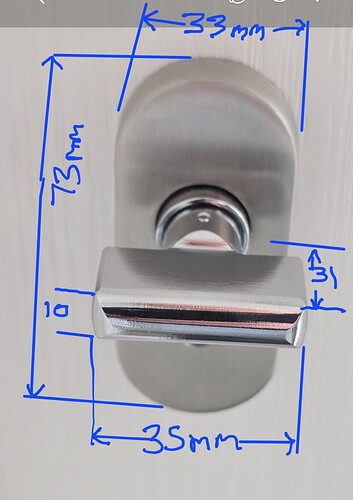

Here’s a photo with some dimensions
When I turn the key on the outside the thumbturn on the inside turns as well, is this not good for the U200?
Yes, that’s just fine. I thought you had a two-way key.

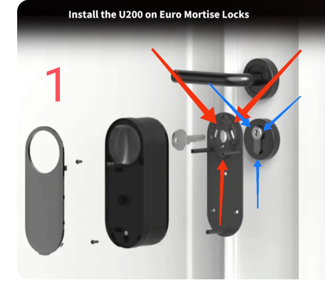

There are two options for attaching the lock.
  1. Using the hexagonal mini-slots in the mount, the inserts (red arrow) are clamped onto the secret body (blue arrow).

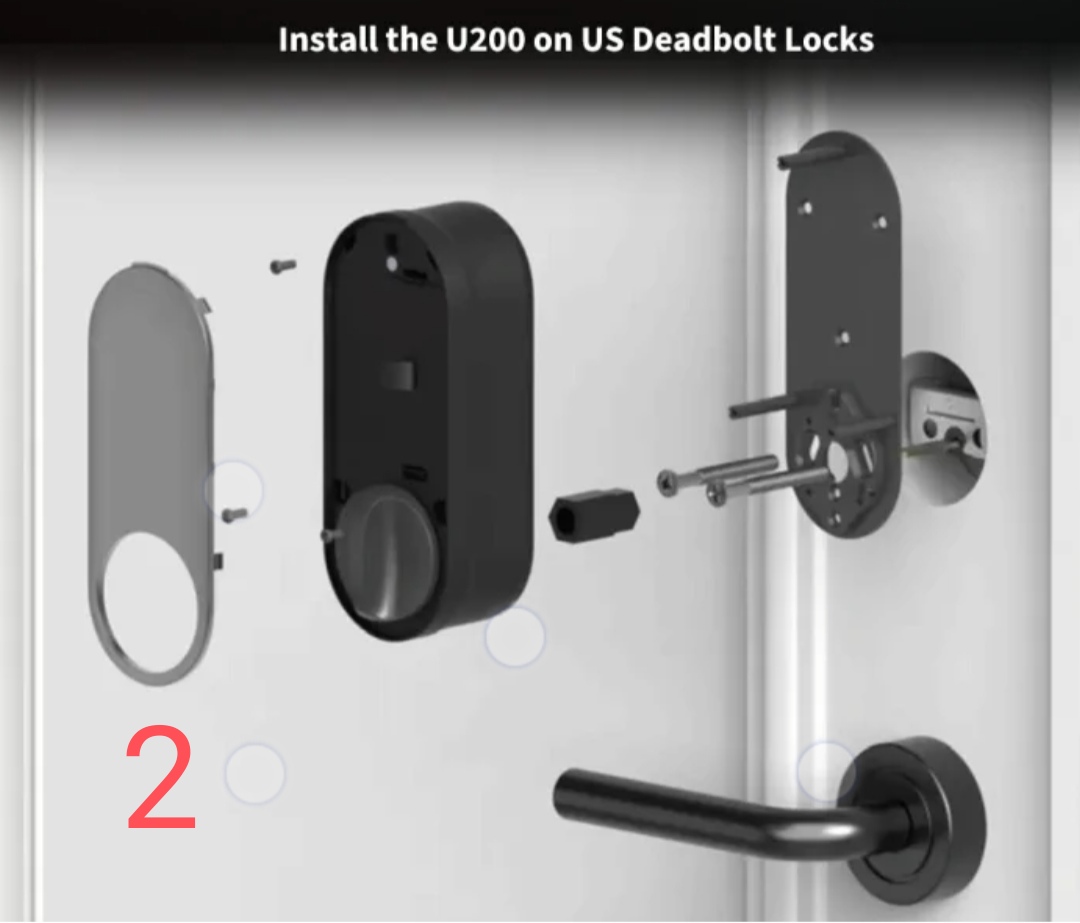

  1. Figure 2 shows quite clearly how the lock is attached in another way. There is a drawback to this method, the holes do not always match the lock.

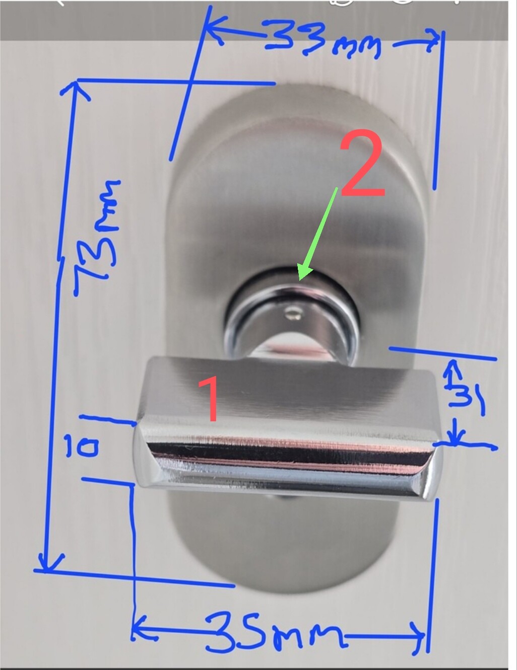

The rotation handle is too big.
I had a handle (1) like yours, I removed it and made an adapter (it came with the kit) to replace it. To replace it, I used one of the adapters in the kit and fixed it with the slot that held the handle (2, blue arrow). To be honest, I had a little trouble with the alteration.
There is another way, buy a new key insert that has a key on both sides and a mandatory condition! The keys inserted on both sides should turn, there should be no blocking of each other!
Thanks for the info. unfortunately I don’t really want to change the key barrel as I have 4 door all keyed alike and all have thumbturns. Maybe I can remove the barrel and drill out the pin, remove the thumbturn and use the adapters.
