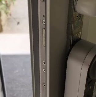

It is bought on 11/2024 but until now, it was not installed (was shrinkwrapped and no seal was broken)
OK… Sounds odd. Please provide a video!
Here the video from calibration process.
