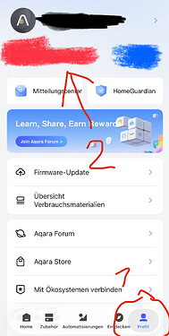

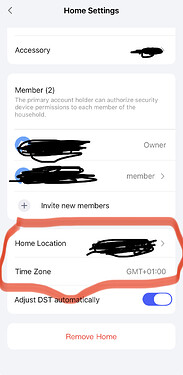

Which “Home Location” and “Time Zone” have you set in the Aqara Home app under:
Home Settings > Home Location / Time Zone
