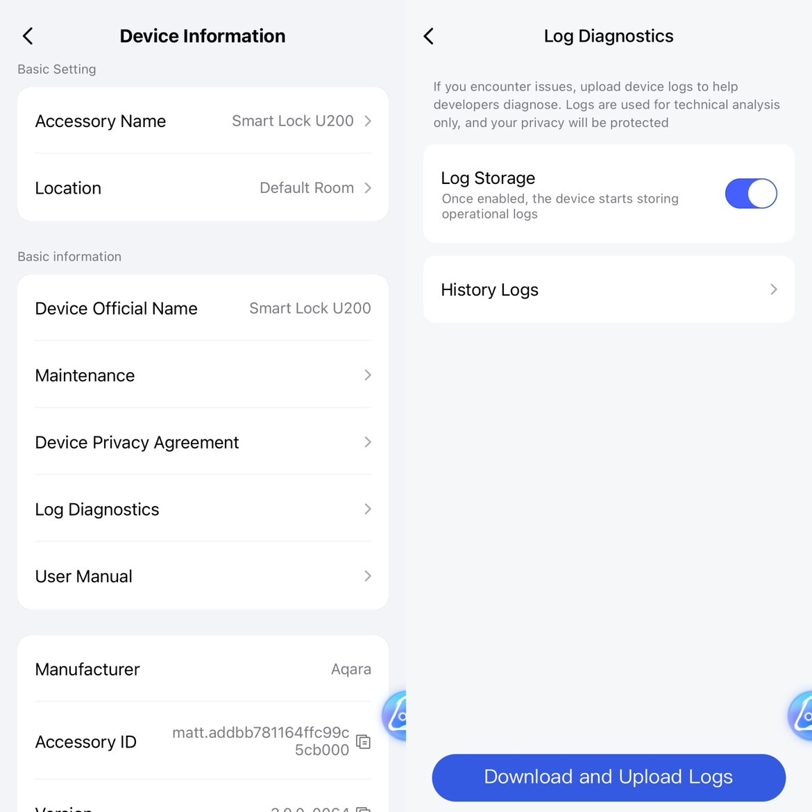

  4. Please follow the instructions below to provide the lock’s log files for our analysis.
Please make sure you go to the Aqara Home app>Profiel> firmware>"…"on the right upper corner>enable beta firmware> then reproduce the issue and upload the log on the Aqara Home app, please check the video and screenshot to upload. Please send the Log file to kaiming.yu-a1550@aqara.com

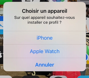

Hello,
I successfully installed the diagnostic profile on my iPhone.
However, I’m having trouble installing the one for the Apple TV.
When I transfer the HomeNetworkDiagnostics_tvOS.mobileconfig file to my iPhone, it only offers to install it on the iPhone or the Apple Watch — there’s no option for the Apple TV.
I tried downloading the file multiple times but the result is always the same.
I also compared the Home Network Diagnostics for tvOS and Home Network Diagnostics (HomePod) for tvOS profiles — the contents of the files appear to be exactly the same. This makes me wonder if there might be an issue with the profile available on Apple’s website.
Would you happen to have a working version of the profile specifically for Apple TV?
I’d really like to retrieve the logs from it, as I don’t have a HomePod — only an Apple TV 4K.
Thank you in advance for your help.
