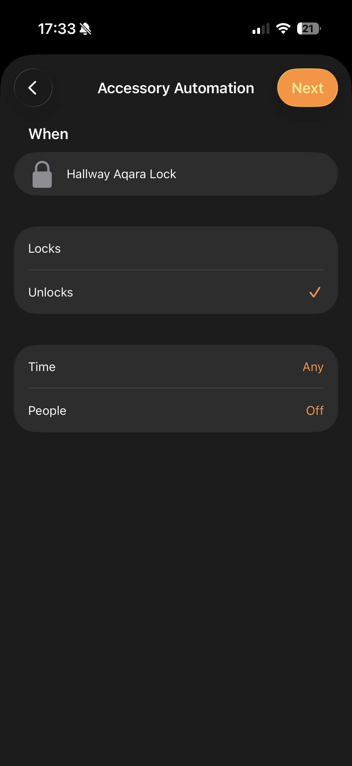

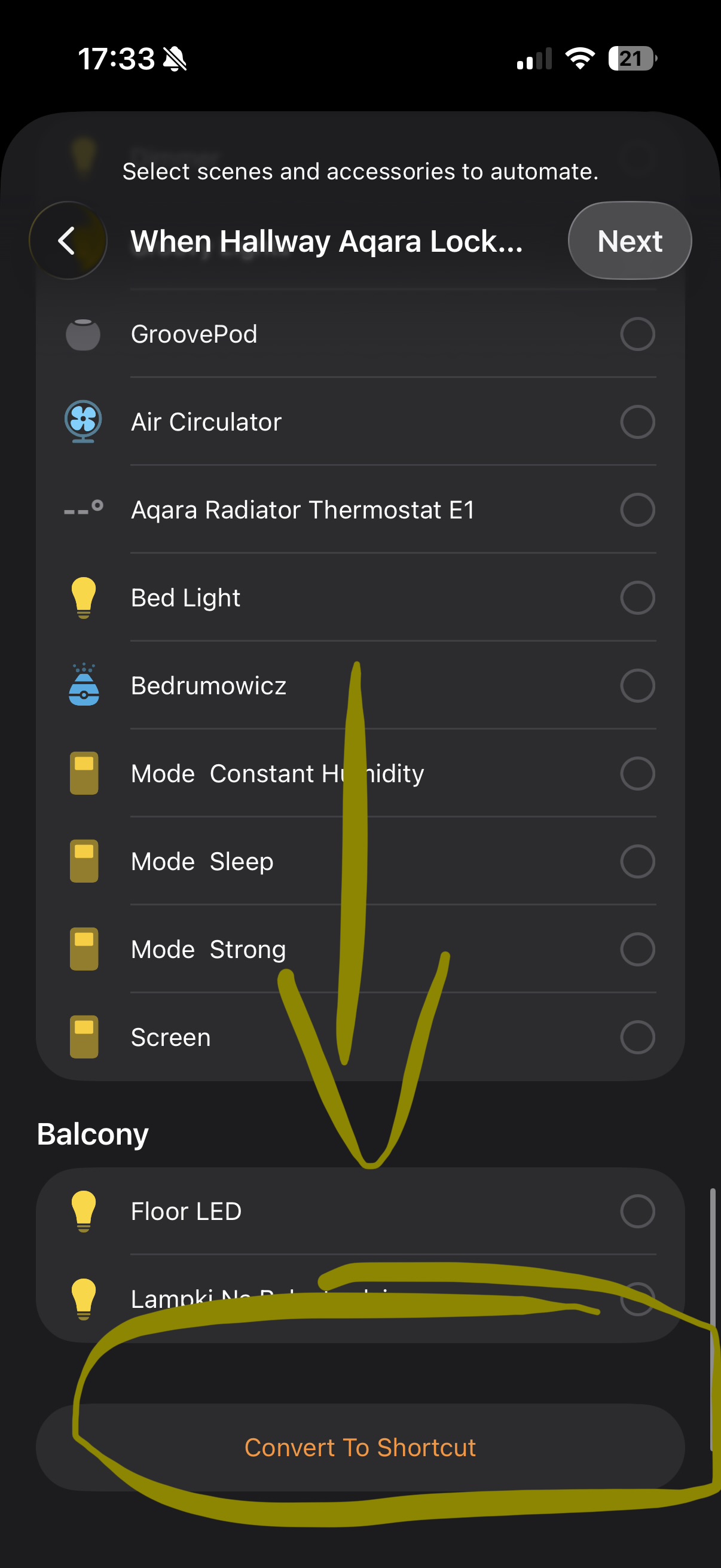

Hi! Actually, Apple Home supports this, but it’s more complicated.

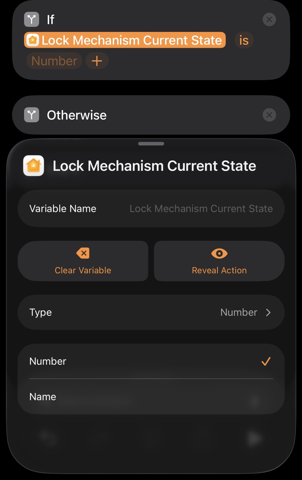

You need to use “Convert to shortcut” to make more sophisticated automations.
When you select accessories to be controlled (after selecting the trigger, which is Aqara Lock Unlock), scroll to the bottom.

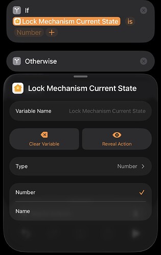

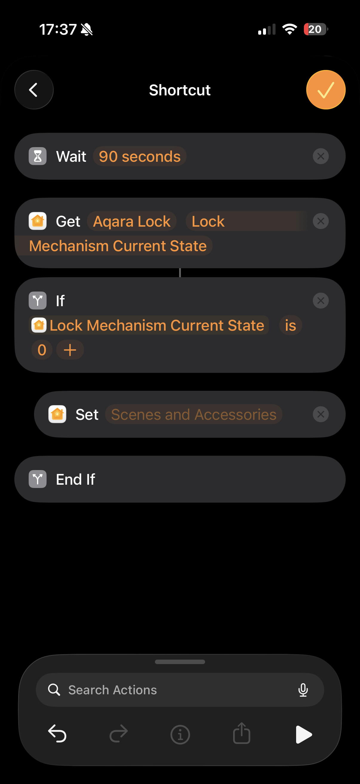

As you can see, you can make the automation wait, and then check the lock state again. As you can see, you can use the “if” action to set a scene or trigger something (like play a sound from HomePod) to notify the residents about an open door.
If you sync a scene from Aqara Home to Apple Home, you will also be able to activate it here, but you need an Aqara hub (like the M3) for full features.
Btw sometimes Apple Home works very strangely and “is 0” doesn’t work in this if condition. You can try changing it to “text” and entering “Unlocked” because sometimes Apple Home registers the state as “Locked” and “Unlocked”, and sometimes “1” and “0” works in this type of automation

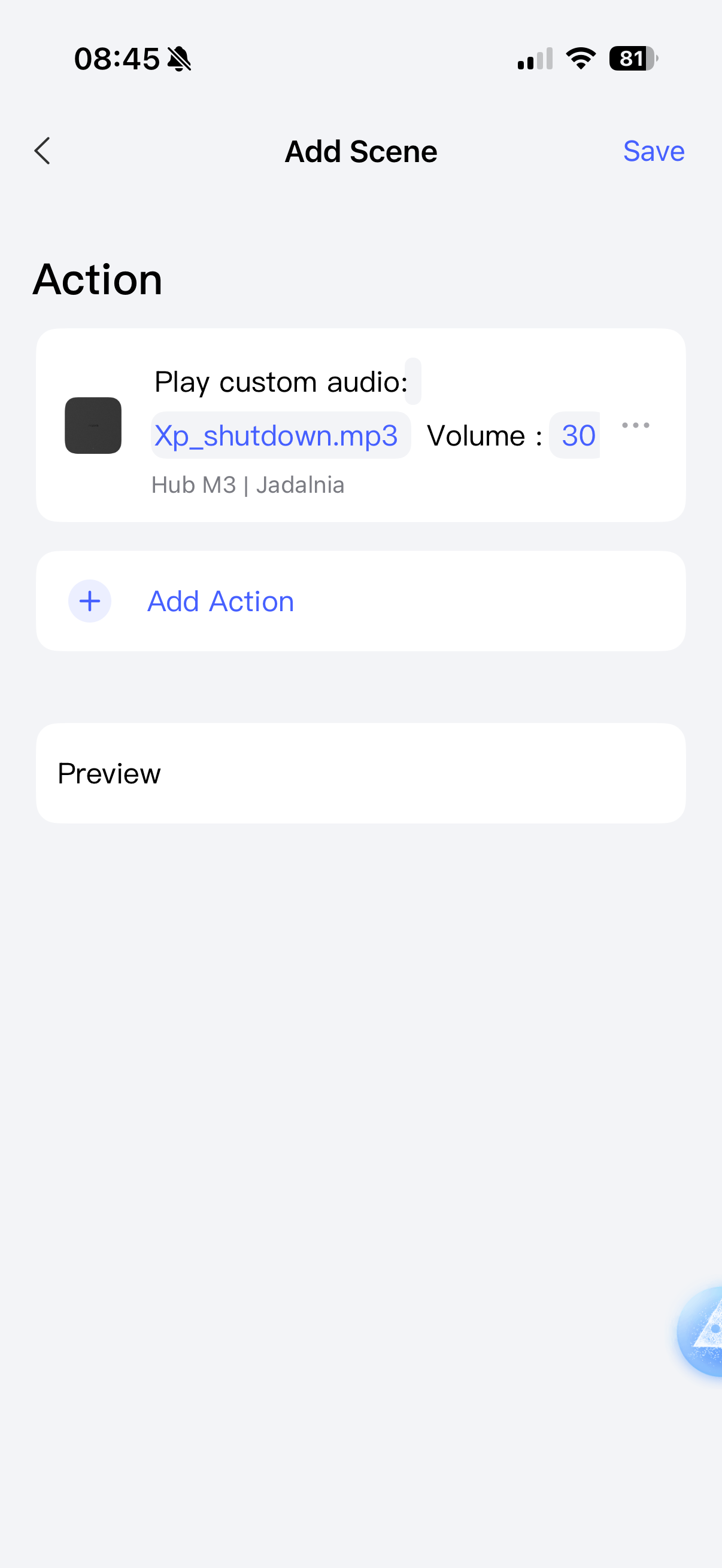

Optionally if you have an Aqara Hub M3 (or an camera hub), you can setup a scene in Aqara Home to play audio through the hub, and then sync this scene to Apple Home.

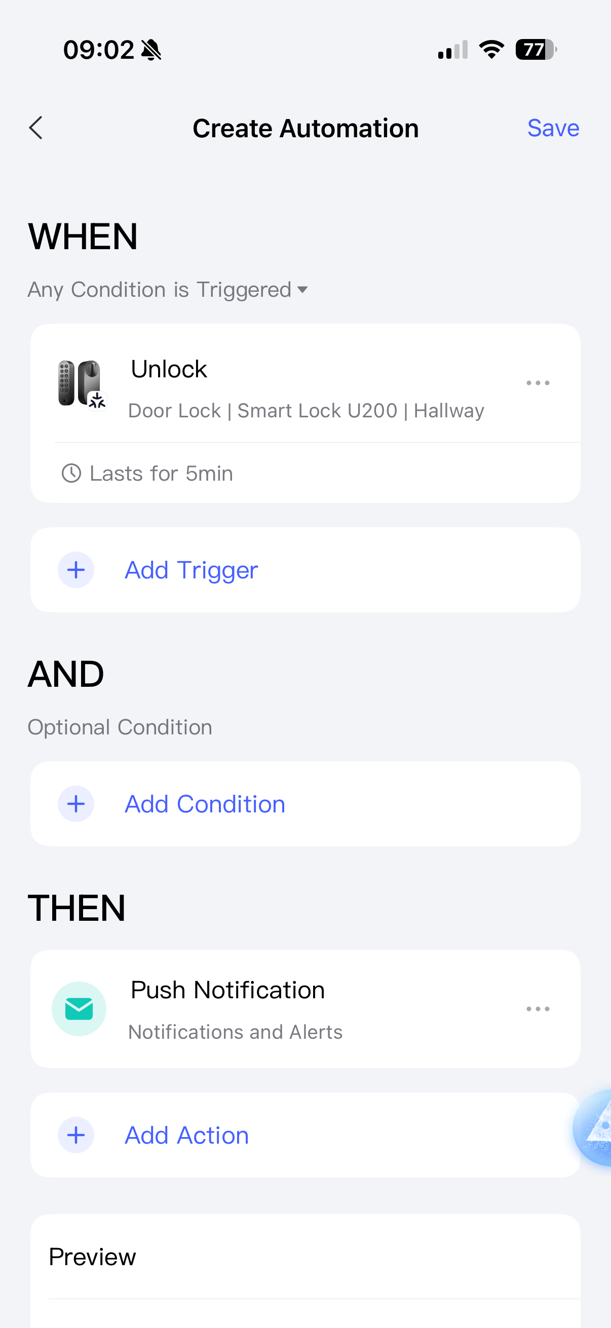

Aqara Home can send a push notification, but only via an automation, so the whole automation needs to be configured in Aqara Home instead of Apple Home.
I need to think how to configure such an automation that will recheck the open status, because “unlocked for more than … minutes” is not currently easily possible to automate in Aqara Home.
Aqara Home has other capabilities regarding automations so gimme a few minutes to think

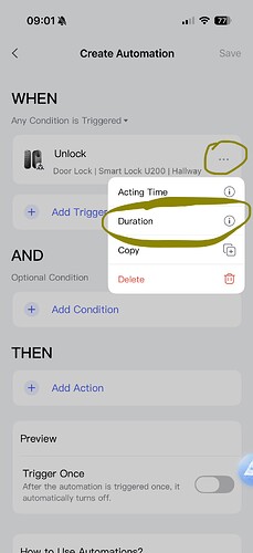

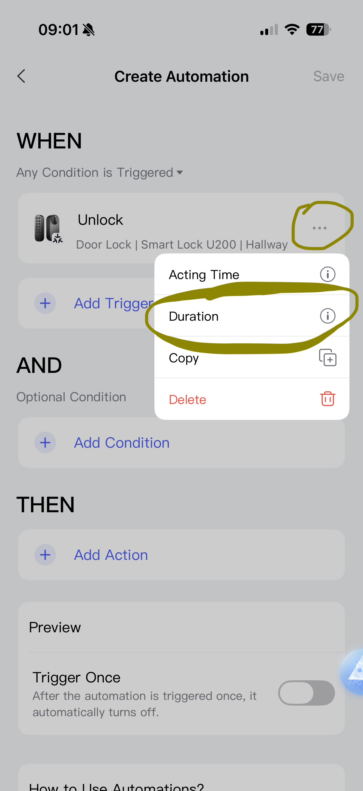

While configuring the automation in Aqara Home, you can just add additional check that will ensure the trigger (in this case: unlocked state) will last for a set duration
Okay, that was easier that I thought :grin: I forgot about one nifty feature in Aqara Home.
Note: You need an Aqara Hub with Matter (like Aqara M3) to be able to configure this automation
