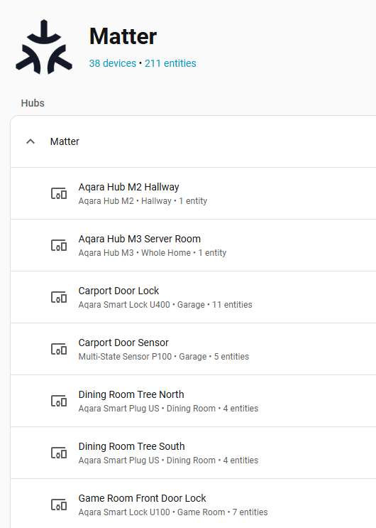

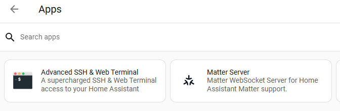

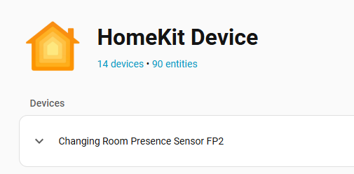

I have a single U400, multiple U100s, Hub M3, and Hub M2, all exposed to HA via Matter integration. Add the hub to HA first and then any devices you connect to the hub will come in automatically. I can’t speak intelligently on the Apple HK as I am only using it for the FP2 presence sensors and g410 doorbell camera. You will need to install the “Matter Server” add-on in HA before adding the hub.
