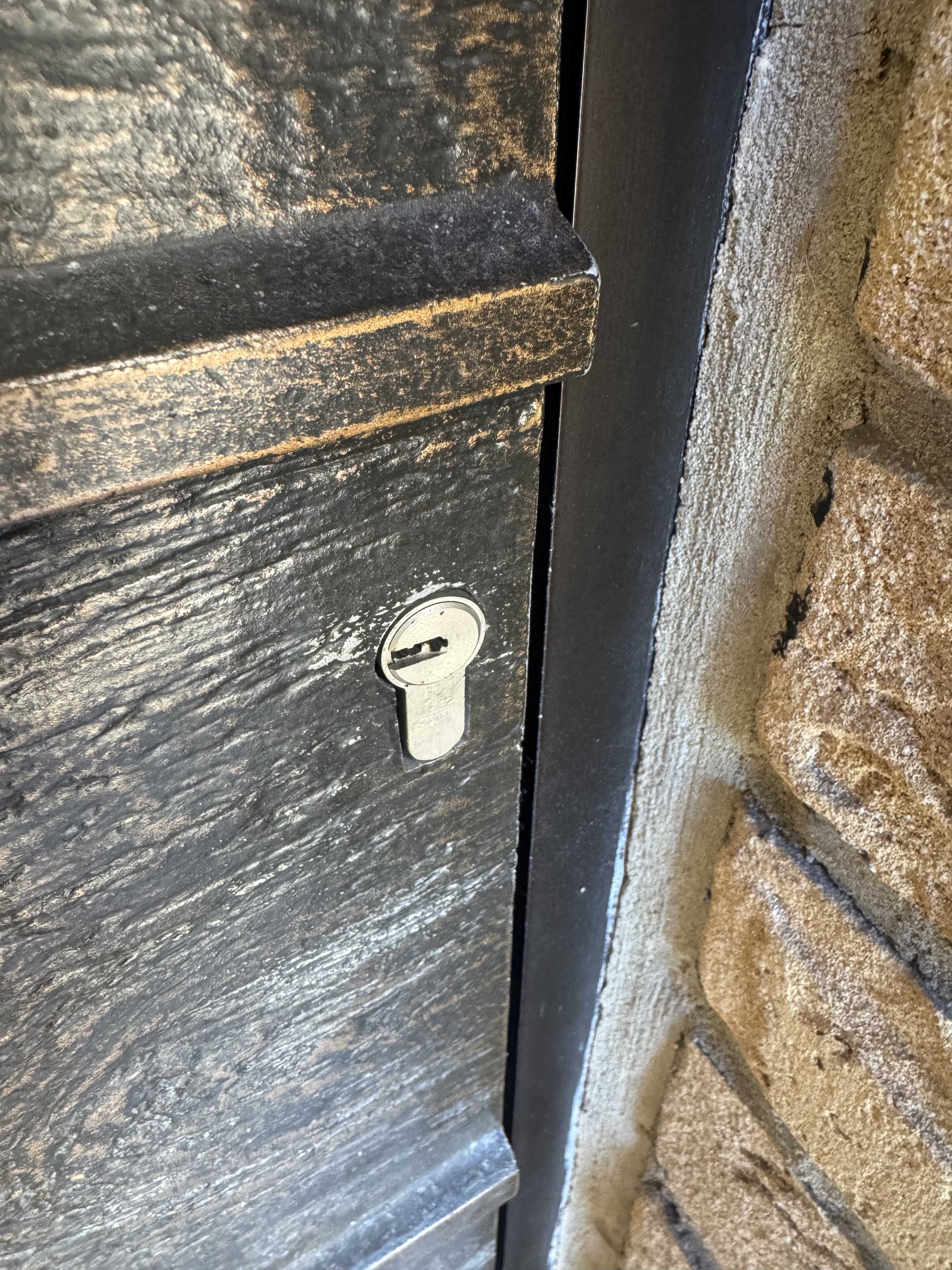

In the US the lock is on the outside as well. In Europe it’s only on the inside. So we would need something like the u200. An external keypad that can support uwb. So the next question would pop up. Where would one put the keypad.

What do you mean by “lock is only on the inside”? The eurolock is a cylinder that can be opened using the key from either side (inside or outside) that is inserted into the lock mechanism.

So in Germany the outside of the cylinder has to be flush with the door. Otherwise the insurance, in a case of a forced entry, may say that the door was not secure enough and won’t pay anything. So for the UWB lock to be outside of the door, like in the US, it needs to be glued, which for me at least does not seem like a great idea.

Generally what you said is because if the cylinder can be grabbed with pliers, then it can be broken in half. But if the smart lock outside is breakable (as if - it will break first when you grab it with pliers) then it’s compliant. Or if it’s the keypad/UWB module is a separate device, like U200’s keypad
See this video for a demonstration (00:15-00:23). You can install a cap/shield that prevents this (as shown in the same video).
I’ve installed a shield like this myself, because my cylinder is a few mm too long for my door, and it’s great. Another benefit is that it helps if you have a problem with a freezing cylinder during winter
