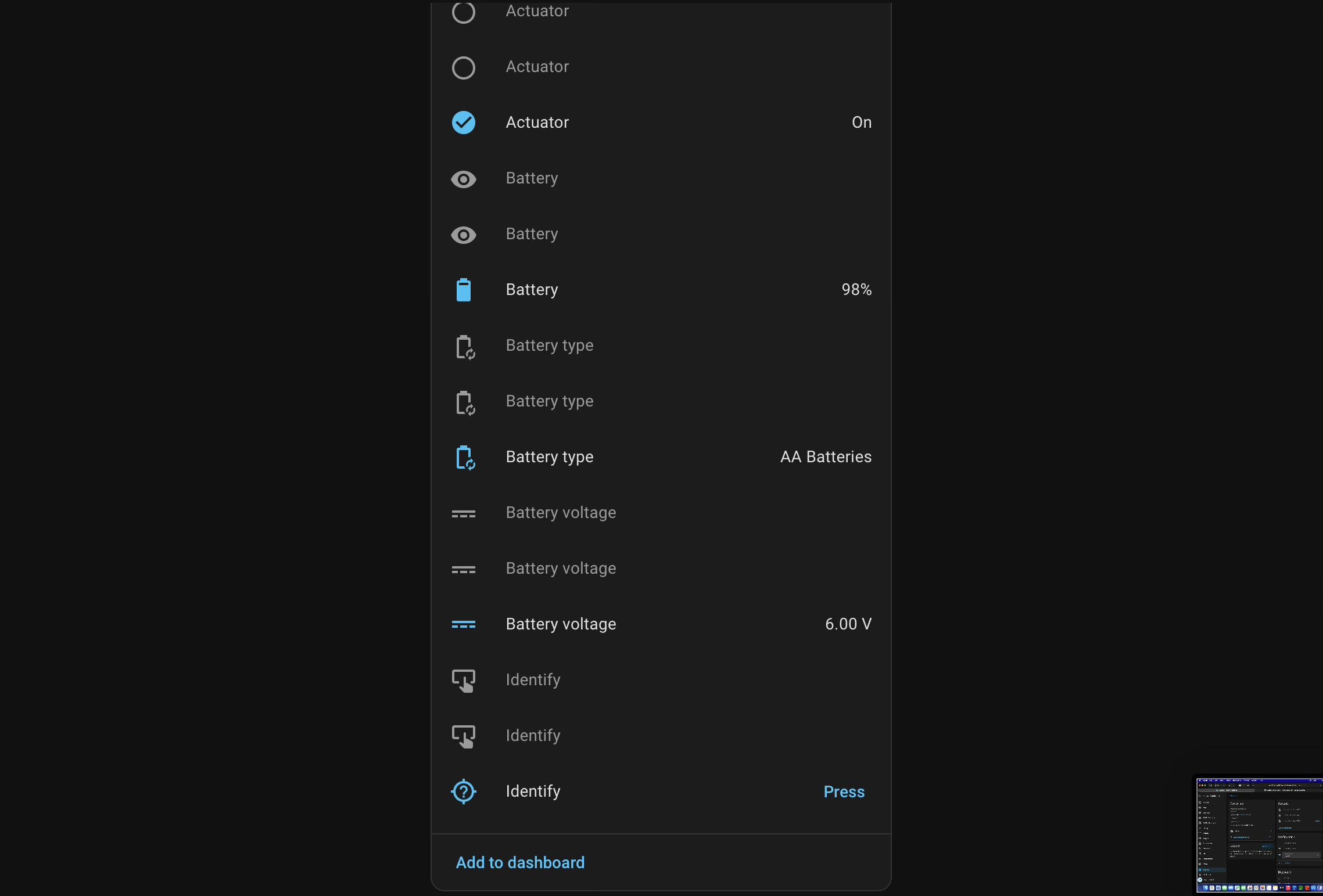

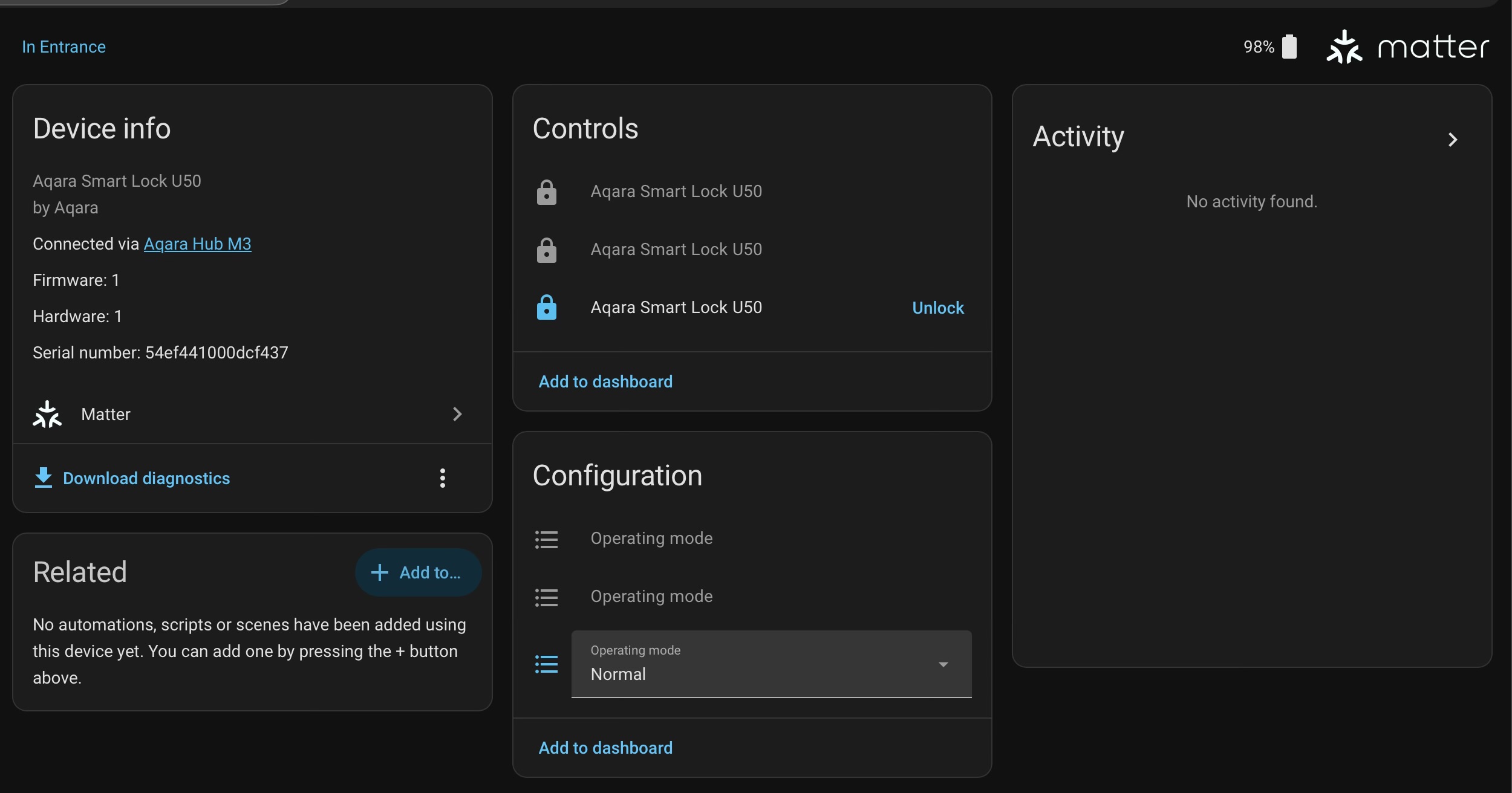

One thing of note, I also have the lock in Home Assistant via the matter bridge using my M3 hub. And I noticed after resetting and repairing the device, now every entity for the U50 shows up 3 times (screenshots attached), with 2 of those being “unavailable”

Those greyed out entities are old stale entities that aren’t coming into Home Assistant anyone. Presumably the reset etc changed the ID of the Matter entities HA is picking up and it created new ones.
It’ll be safe to delete the old one since they’re no longer active, but any automations etc you have will need to changed over to the new entities since they’ll not be working currently.
