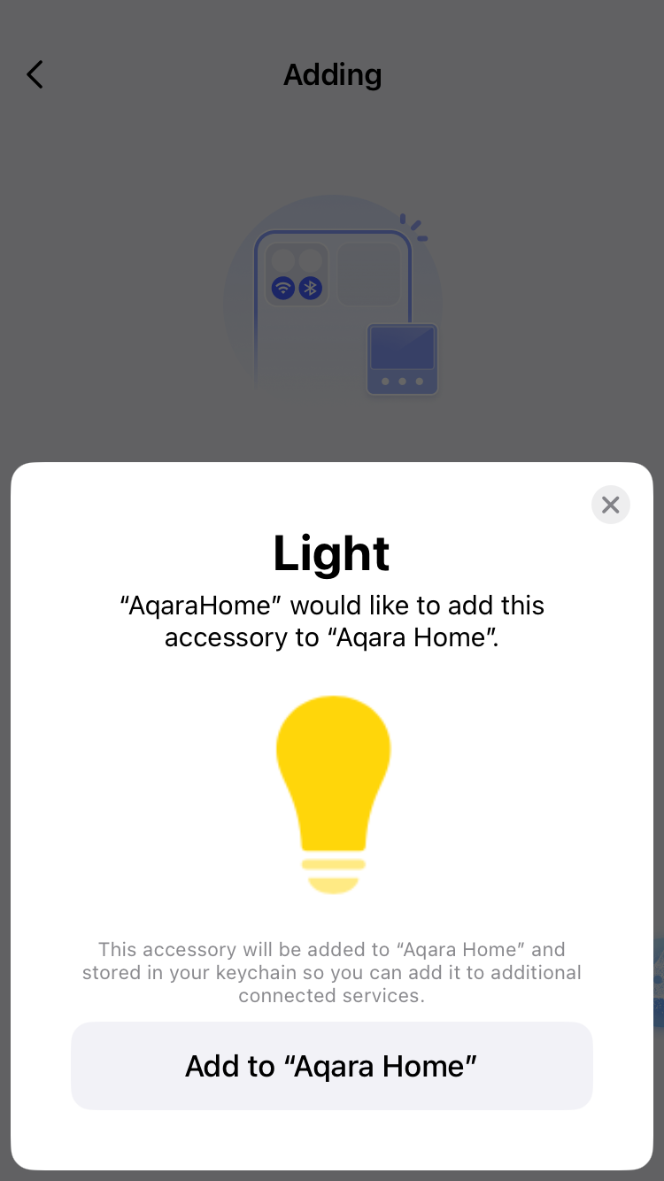

So the issue I’ve been having and reported to Aqara Support is that I’ve purchased 4 more T2 bulbs (currently have 2 fully working and attached to my M3 via Thread/Matter) but none of the new T2 bulbs will add to the M3. I get the errors “Unable to add accessory” and then “AqaraHome-8952 Connection Failed”.
So for what should be a really simple task and one that I’ve completed twice before. However the response I got from Aqara was…
“They will fix this on iOS 18.6, but it will take a very long time. We recommend that you connect the T2 bulb to the Apple Home app first if you have an Apple Home hub(HomePod mini or Apple TV), then expose it to the Aqara Home app by sharing its matter code via Apple Home app”.
What? First off I don’t have a Apple Home hub and secondly, do all Aqara T2 bulbs / M3 connections have this issue or just mine. Seems crazy to me.
Anyone else having the same issue or have a fix that Aqara don’t know about?
Thanks

We’ve looked into this issue and found that some Matter-over-Thread devices, including the T2 bulb, may occasionally fail to be added to the Aqara Home app via iOS devices. This appears to be related to changes introduced in iOS 18.4, as the issue does not occur on iOS 18.3 or earlier. We’ve already reported this to Apple and are actively working with them to find a solution.
In the meantime, we recommend using the Aqara Home app to add your T2 bulb and selecting the ”Zigbee Mode“ during setup. This can help avoid the current Thread pairing issue, and the ”Zigbee Mode“ also supports more features compared to the Matter-over-Thread version.
We understand how frustrating this must be, especially since you’ve successfully added similar devices before. Please rest assured that this issue is not specific to your devices — it affects certain combinations of iOS 18.4+ and Matter-over-Thread pairing, and we are doing our best to get it resolved as quickly as possible.

I found that the bulb T2 can be successfully added as a Matter over Thread device in Apple Home and shared successfully with Aqara Home as a Matter device. Why would Aqara Home not be able to handle the inclusion of a Thread device while Apple Home can?
Yes, we’ve also noticed the issue you mentioned. We implemented the device onboarding process using Apple’s Matter commissioning API, and it appears that the bug is related to that. As a workaround, you can try adding the device through the Apple Home app first, and then share it with the Aqara Home app.

Crazy solution but I managed to borrow an Android tablet and used that to add the Thread / Matter devices to Aqara M3.

Problem with ios, adding devices should be fixed in the next ios update.
Recommendation to first add devices to HK and from HK add to aqara home, or temporarily use the Android system to add thread devices.
