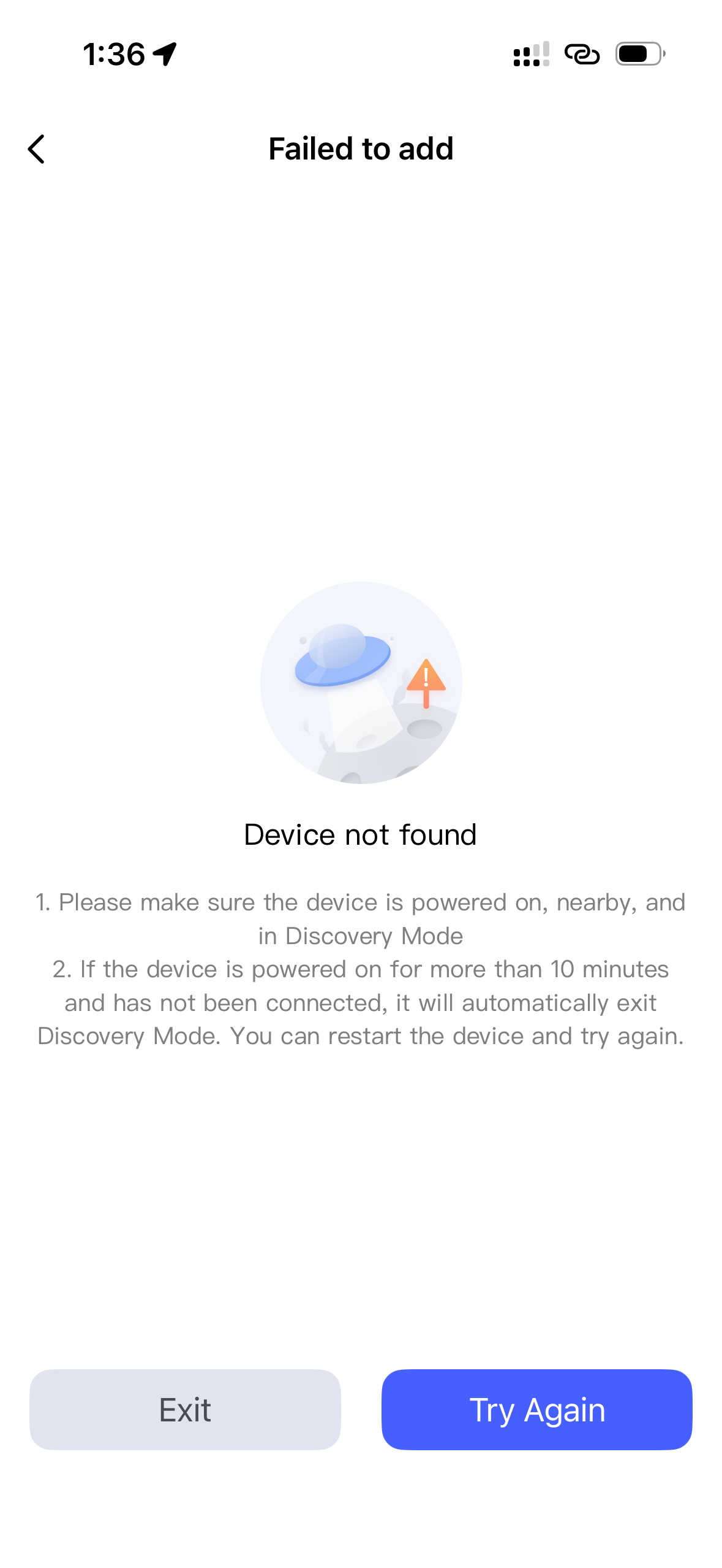

I am trying to bind it to aqara home app in UAE, my app region is china and I have several other aqara devices on my account including G4 doorbell
I am getting the attached message “device not found”
Device connects to homekit normally and streams and records normally

I did, they said normally I should get a message to request location change and then they will receive the request to process it, but this doesn’t happen and I never get it
and they couldn’t reproduce the fault in their labs for testing

I tried changing location in app but didn’t work
Ok, so I would ask for a replacement :person_shrugging:t4:
