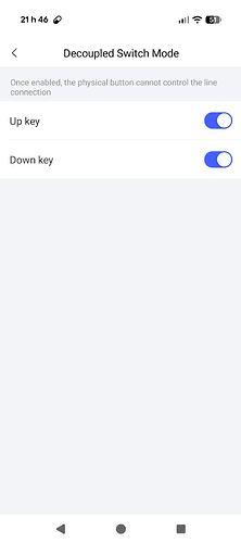

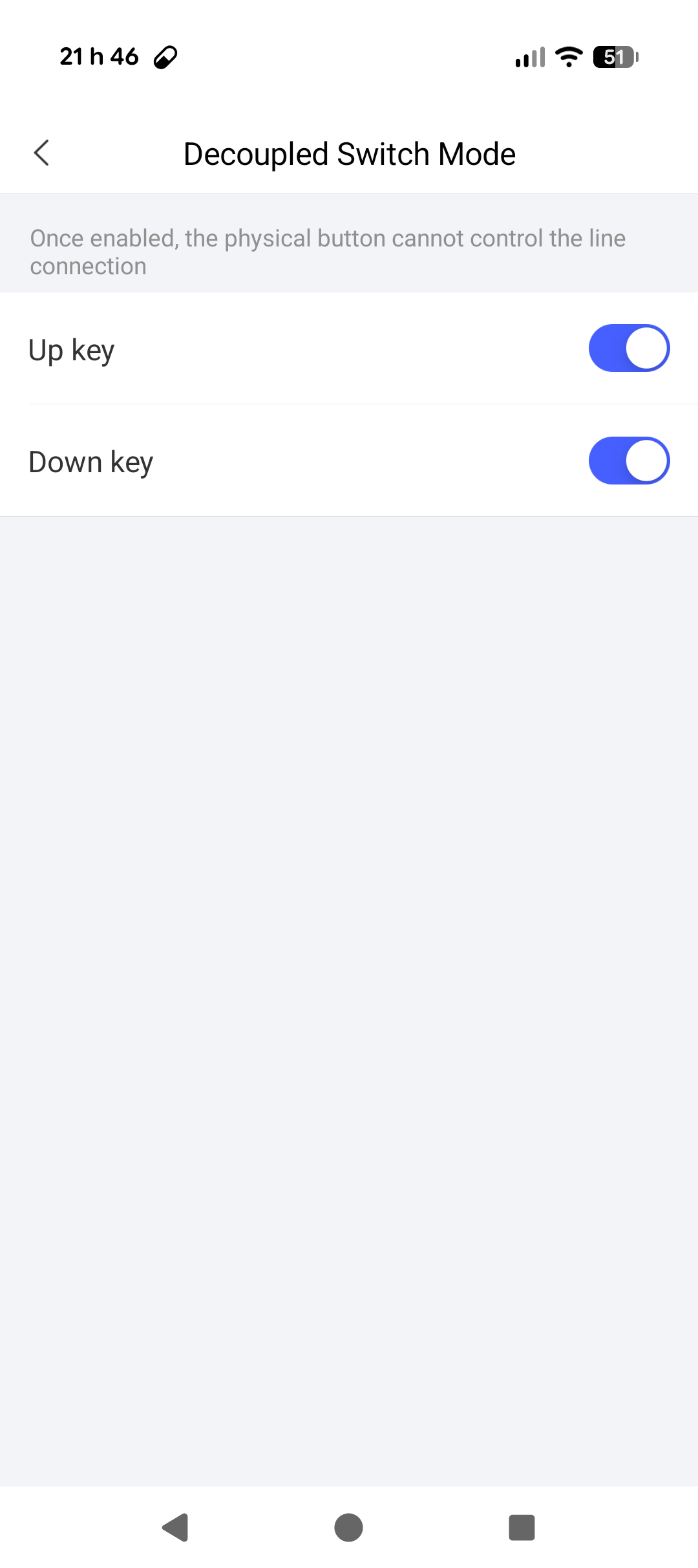

Personally, I would start by removing the new devices from the app completely and starting fresh. First, install your new switch and connect it to the hub that’s closest to it.
After that, make sure to enable Decoupled Switch Mode on the switch. This is important because it keeps constant power going to the light.
Once decoupled mode is enabled, the physical button will act only as a wireless button and won’t actually cut power to the light anymore.
Also, double-check in the Aqara app that the switch is set to “On” so the light is receiving power.

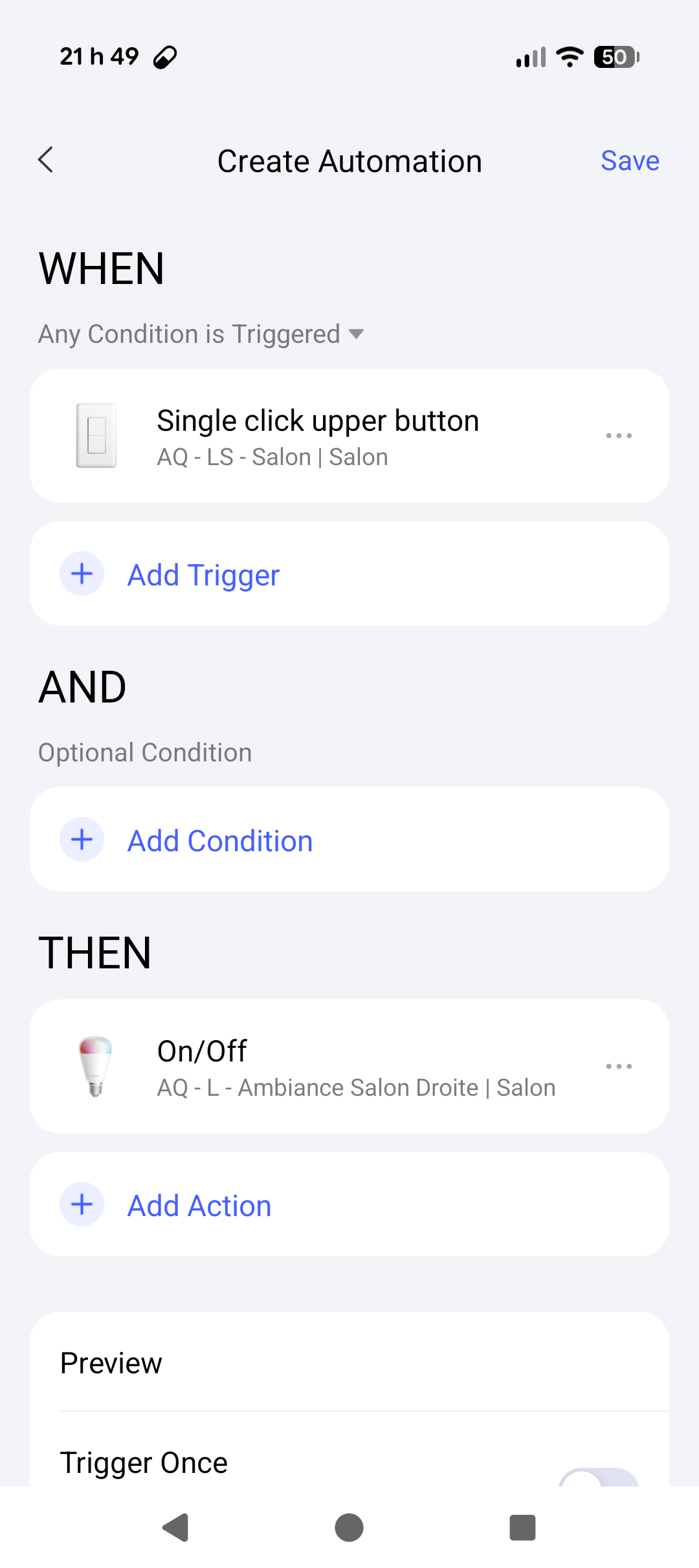

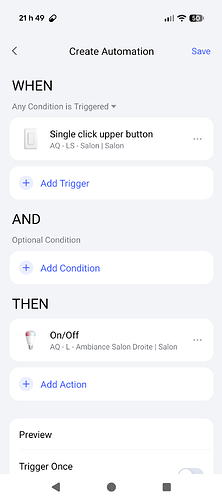

As a second step, you can then install and configure your ceiling light.
After everything is connected, you’ll need to create automations so that when you press the switch button, it turns the light on and off.
That should get everything working the way you expect :slightly_smiling_face:
Let me know how it goes!
so what this does is keep the light smart, Basically without this mode your switch is cutting power to ceiling light which then means the app can not see it, its really all it is, as with any smart light once power is cut, it becomes dumb as it has no power at all running through it.
By enabling decouple switch mode on the switch when its on, it want cut the power to the ceiling light (the light will then only draw roughly same power as some left plugged in to a socket but switched off. to keep it alive on the network.
