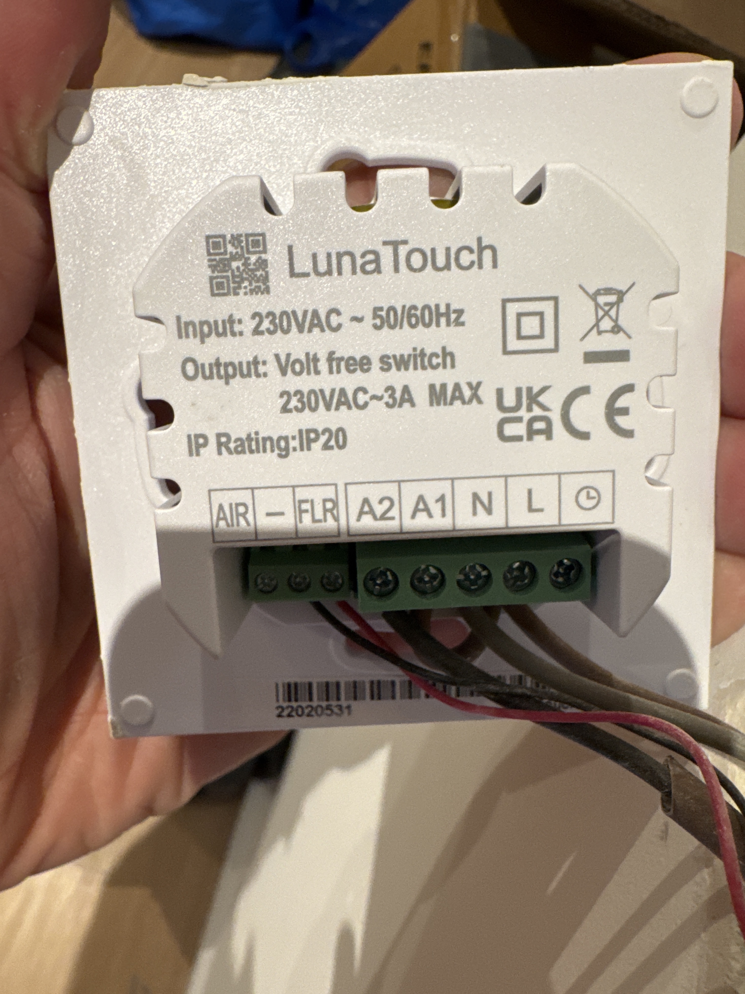

I got today two thermostats for my underfloor heating and trying to replace my ambiente thermostat which was originally installed. I am a bit confused with the wiring as I don’t know how to connect the N (load).
Here are the pics or the current setup of Ambiente thermostat.
From what I checked, I am missing cable for neutral (live). Chat gpt said that I may not be able to connect this thermostat and would need to use this ambiente.
Anyone had the same problem and knows how to solve it (connected it)?

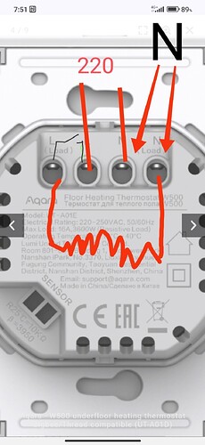

Hello, check out this topic, I described the connection. W500 Floor Heating Thermostat - wiring question - #2 by gafich10
Attention!!! W500 DOES NOT HAVE dry contacts!
Attention!!!

I connected it already as I found in the manual the way to skip the N (load). Also chat GPT said to not to do bridges between. But your picture indicates to make the bridge between L (load) and N (load). Is this correct?
No, I drew a LOAD (electric heater)!!!
