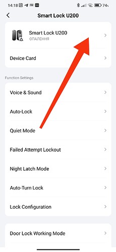

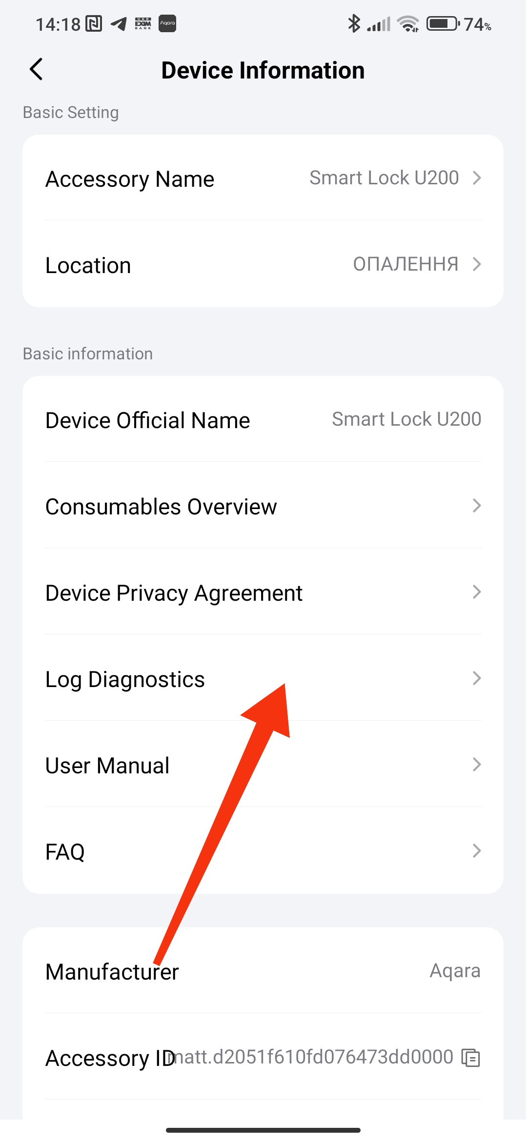

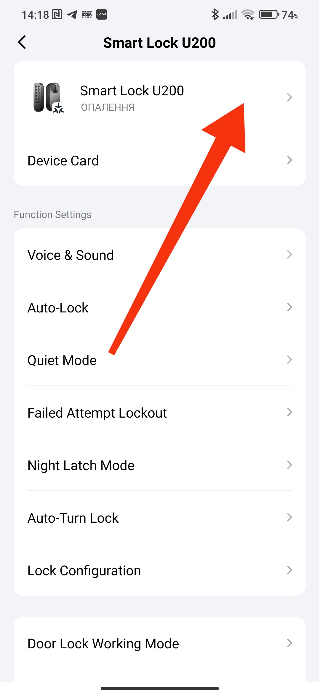

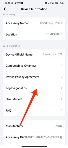

By the way, prepare an event log for the castle. Do you know where to find it?

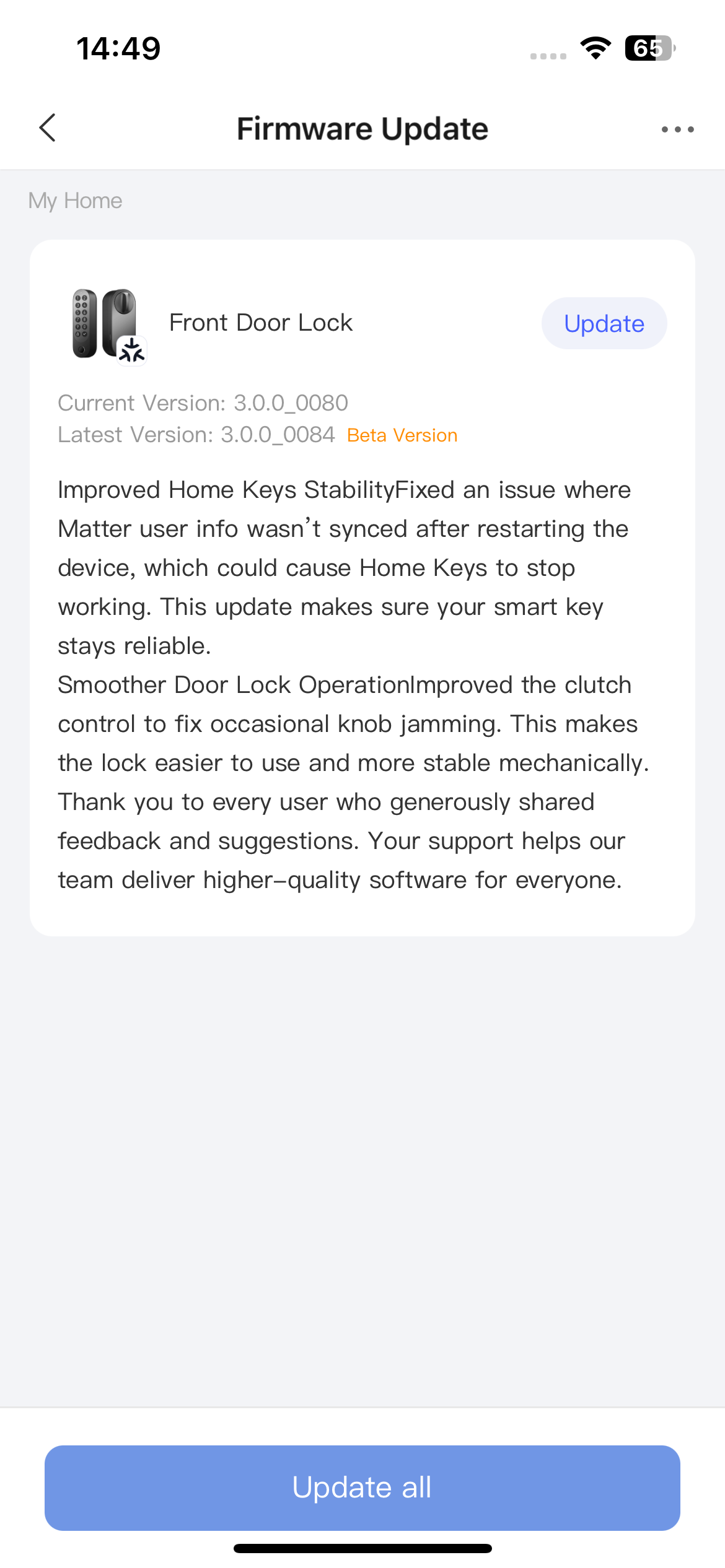

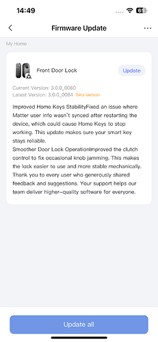

Just to be clear, as of today 31st August 2025 firmware V84 is beta and should not be installed unless support asks you to or you are happy to test beta software.
Thank you for your feedback,
when I updated my U200 I did not notice it is Beta version.
