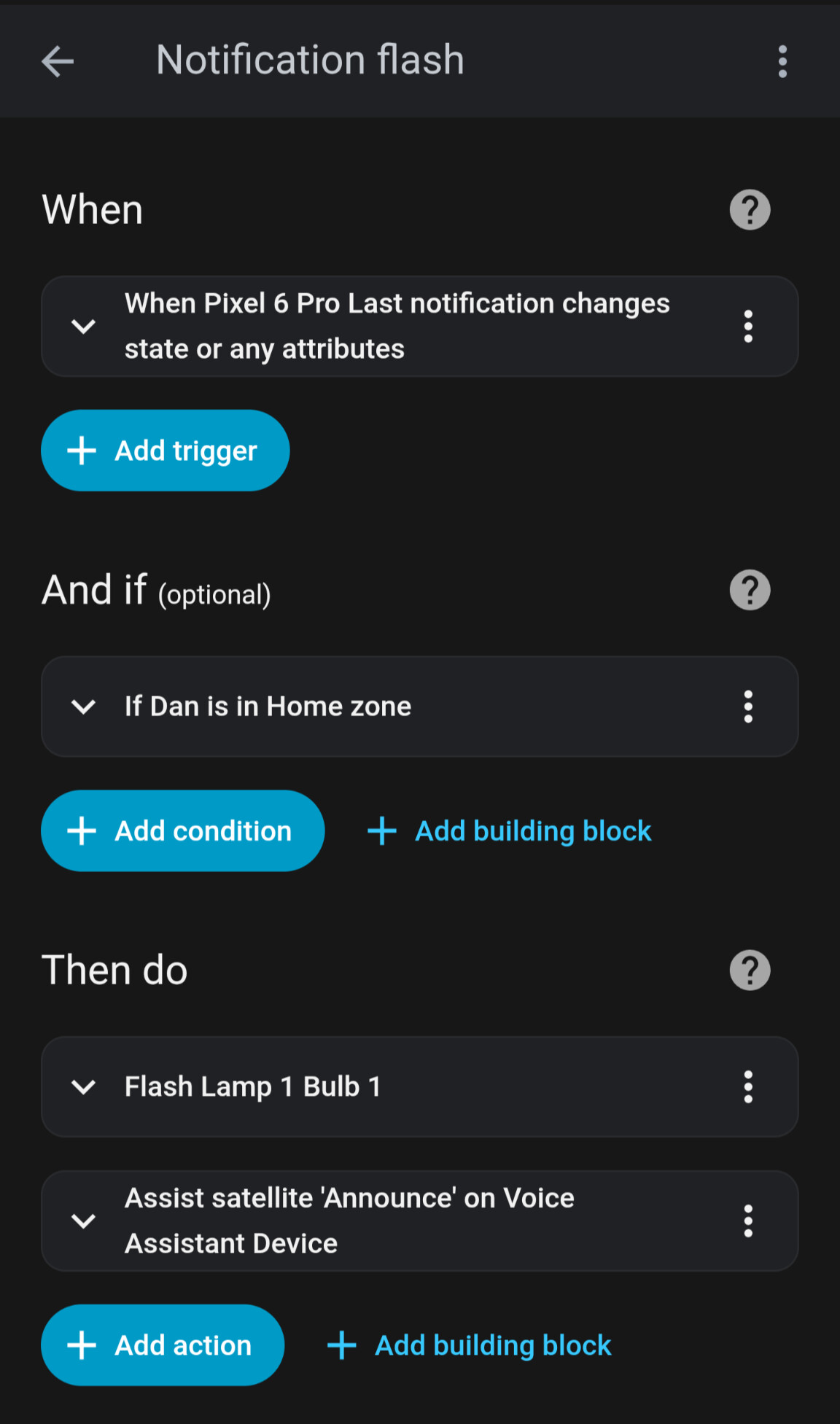

Yes it can. In the Home Assistant app on your phone, go to settings → companion app → sensors → manage sensors → notification sensor → last notification, enable it, then set up an automation with that sensor entity as a trigger and a flash action on the light/s of your choice.

I have done that but still struggling to create the automation i have enabled the sensor and don the if condition it just senor entity
Not sure about ios, but if you’re on Android make sure you’ve set up the allow list for which apps are allowed for notification monitoring. And enabled the location sensors if using them.
A simple automation will look like the below image.
