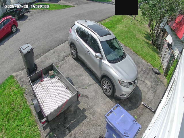

Hi everyone! I wanted to share a cool automation I recently built using the Aqara Camera G5, Home Assistant, and a bit of AI magi* to help me remember to take out the trash and recycling,without any manual effort.
Every hour, Home Assistant checks if we are within ±12 hours of a scheduled trash or recycling pickup (based on calendar events). If we are, and the corresponding bin hasn’t been marked as “already at the curb,” then the system triggers a snapshot from the G5 camera, pointed at my driveway.
This snapshot is then analyzed by AI (via the google_generative_ai_conversation integration). The AI is asked a very specific question:
“Is the black (trash) or blue (recycling) bin closer to the street than to the house?”
If the AI says true, that means the bin is already at the curb, and an input_boolean is turned on to reflect that. If the AI says false, then Home Assistant sends me a notification to remind me to take the bin out.
:repeat: This runs automatically and quietly in the background, with zero false positives once the bin is detected.
:white_check_mark: If the bin is already out, no unnecessary notifications are sent.
:date: It works independently for both trash and recycling, based on my calendar.
This has been incredibly helpful for keeping up with pickup days; especially when life gets busy and routines change. It’s a great example of how Aqara’s devices can work beautifully with Home Assistant and modern AI tools to solve small everyday problems in a smart way.
