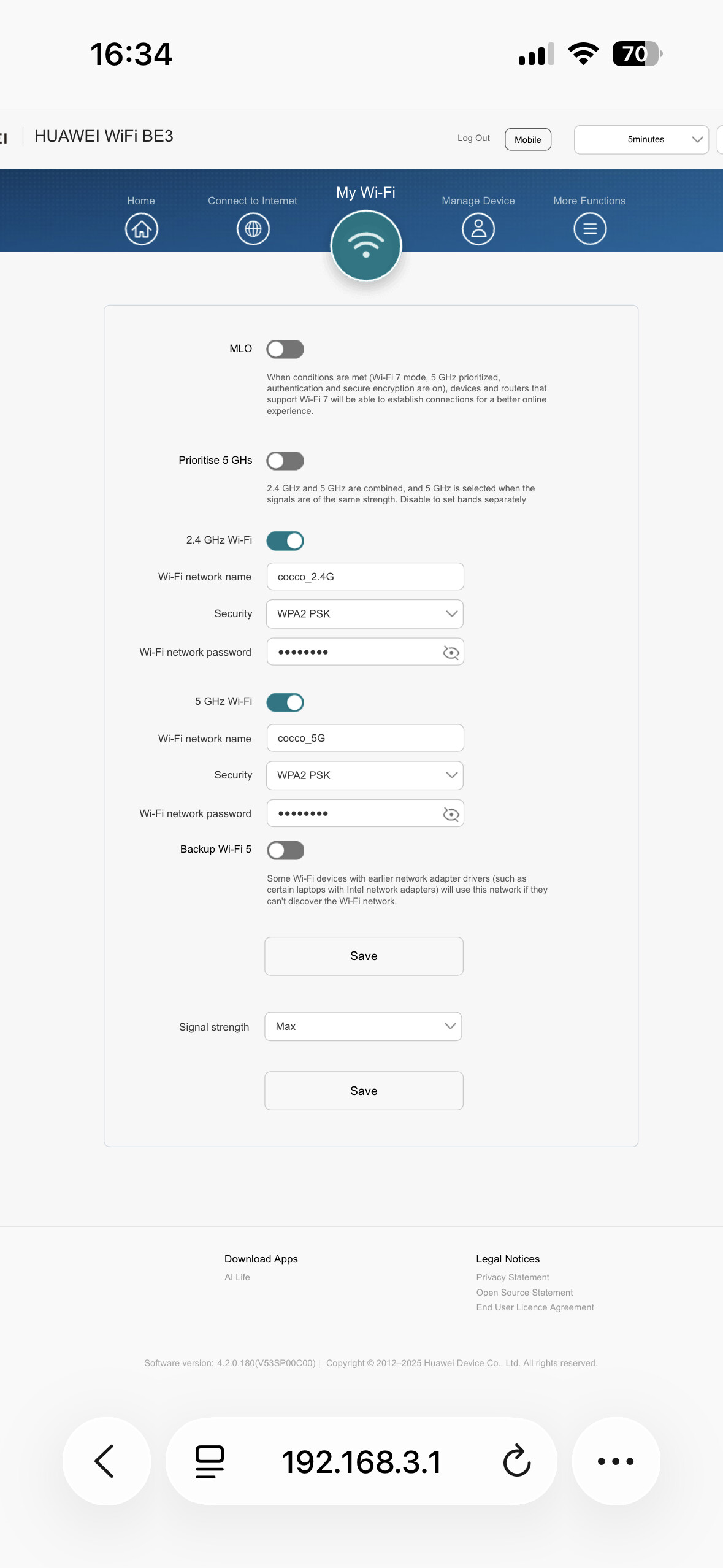

Well I know for fact that Apple home app is unstable as I had issues with network issue but I changed my router and Gemini help me set it up the right way so Apple home comunícate with Apple devices and in the end to all my matter devices I also had an WiFi switch with turned ON the light by himself because of Apple home app and now after I made all those changes on my router everything is great now.what you need to try is change the smart WiFi off and make 2 separate bands 2.4G and 5G then on each band chose an stable Chanel o the 2.4G chose Chanel 1,6 or 11 see Whitehall gives you the best connectivity also on the bandwidth chose 40hz now on the 5g band set Chanel 36,40,44 or 48 I have set mine on 36 and the bandwidth 20/40/80/160 this way you get almost the speed you have but by WiFi after all this are set reboot your router ether from deco app or just unplug it and plug it back but make sure that if you have made those changes to save them before you reboot.then restore your cameras and connect them to the 2.4G band as it is more stable and cover more distance and see for a few days if your cameras still connect and disconnect as I think this would fix your issue.here some screens with my router setup mine is an HUAWEI but the steeps are the same for each to make those bands as independent by the way it is better you go to router web page were you do all those changes and not on the deco app.
Hi, thank you so much for your message. In the case of the Deco, I have a dedicated IoT network. It doesn’t allow me to make as many changes as you do, but I’ll investigate and try to make it as similar as possible to yours. Let’s hope I have some luck.
Thanks for your help.

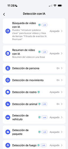

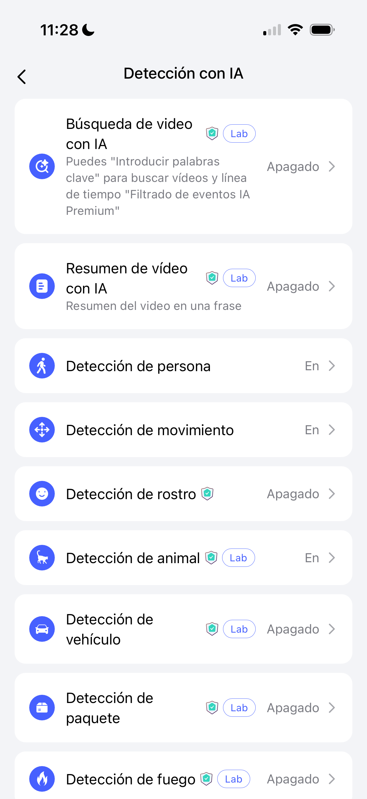

If configuring the router does not solve the problem, try disabling unused AI detection features; this helps resolve the issue.
I do not think that is the issue here,because this cameras are made to work with AI detection if disabling a feature then what is the point have such feature added in the first place?makes no sense that an feature from the AI detection cause connectivity issue.2 days ago I was changing the Chanel on my 5G band but I was doing it on web page of my router and I save it but I didn’t restart my router too and I was on an fitness plus sesión and from no were it freeze and the issue was that my router was changing Chanel and all my devices that were connected to 5G band including my Camera G3 my M3 hub were offline during the Chanel changing.now yesterday I changed the Chanel on my 5G band to 36 save it and rebooted my router and had no issue since then

Thanks for your help. Actually, none of my cameras seem to have any AI functions connected. I only use person detection and motion detection. Is that correct?
