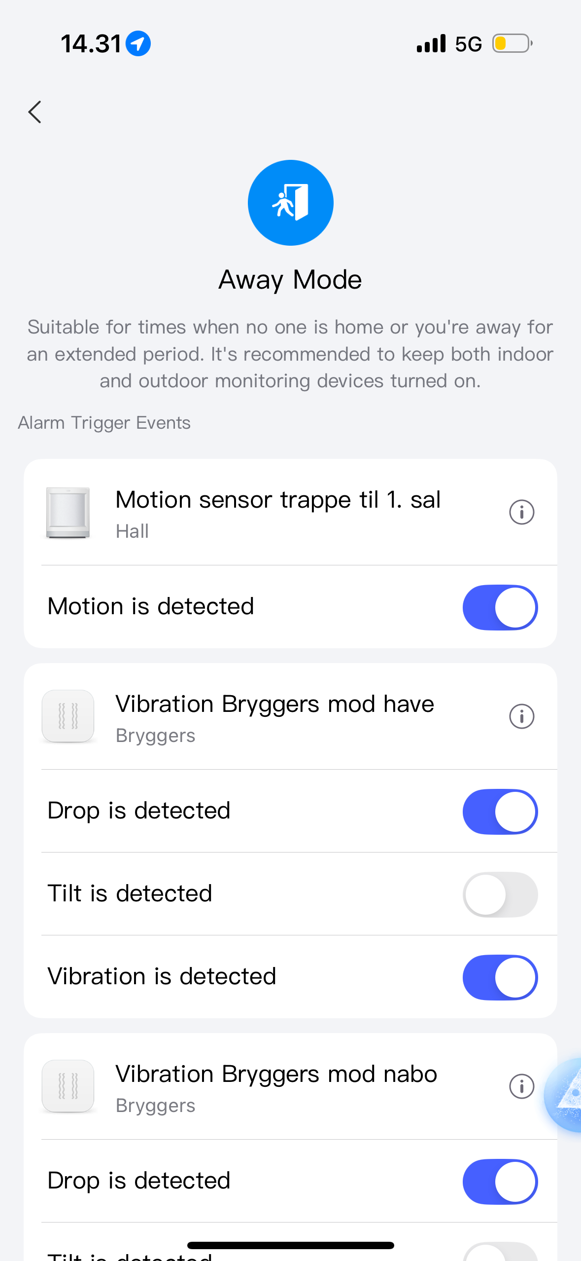

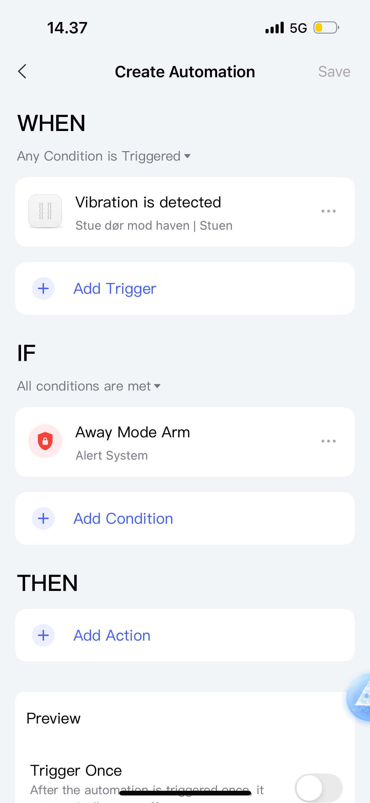

Well loved your suggestion at the get go but in home/away mode you can’t add anything but the device and what feature should trigger the event so that won’t do it, but perhaps if you make a very long automation you could make a work around but for sure that’s not how the system should work
and having looked at it you can’t really tell the system that if it happens 2 times e.g working 2 min. Then it should sound the alarm so the suggestion don’t work in the app unfortunately. If you have a way it works please share. ![]()
Yes, my suggestion was not for the Aqara app itself, but if you had access to Home Assistant. I think you’ll be limited here for now in the native Aqara alarm functions unfortunately.
