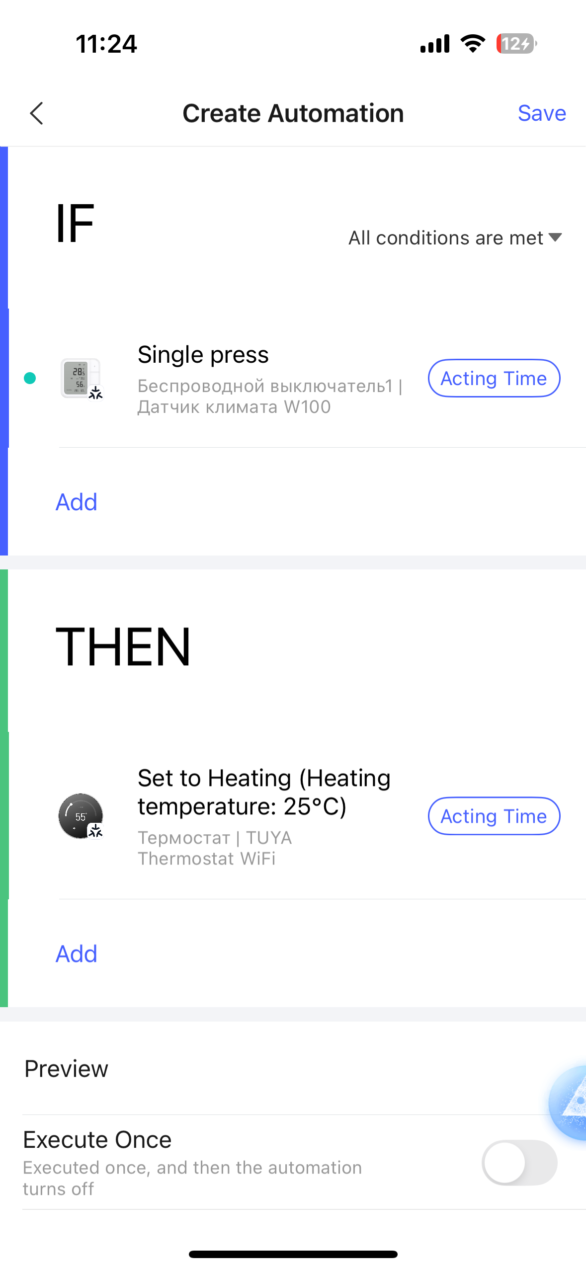

w100 can be connected to third party thermostats
How does it work? I couldn’t find a way to do it
I think it’s done through automation of + and - keys in Aqara Home or HK.
