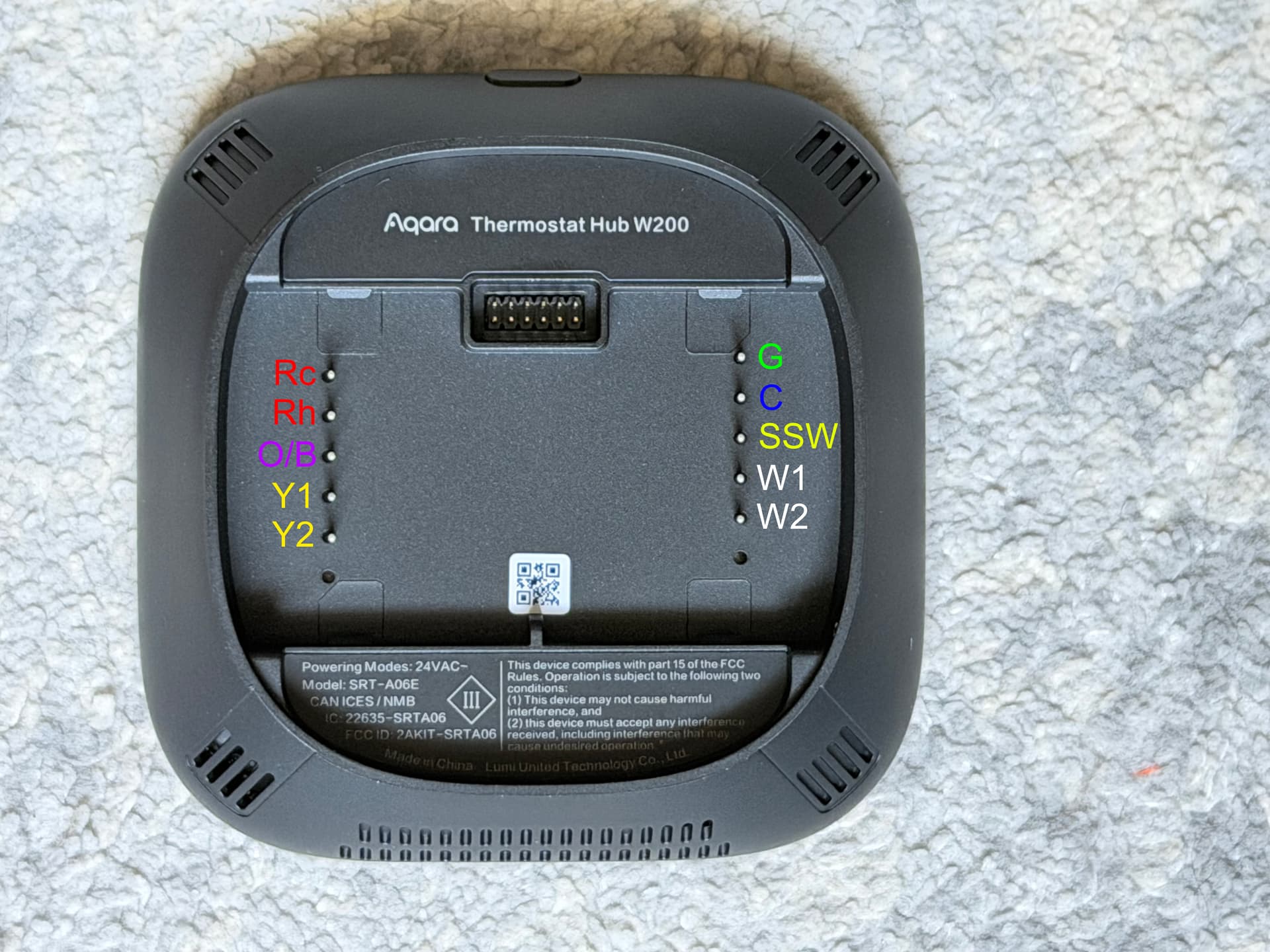

I was asking support. But does anyone here know the pinout on the back of the device without the baseplate? I want to power Rc and common with a 24VAC to see if it reboot loops while off the wall.

I agree this could be. I don’t have a good way to test that which is why I wanted to bench test the device to rule out the device as being an issue or a firmware issue. My issue sounds different than your latter issue as this one does still seem to power on fine.

I made a pinout for the back in case anyone finds it useful if they can’t get to the baseplate. It’s the mirror of the baseplate so it is easier to follow when looking at the pins. I’m powering it from a 24VAC transformer on the C and Rc pins to see if it reboots while off the wall.
