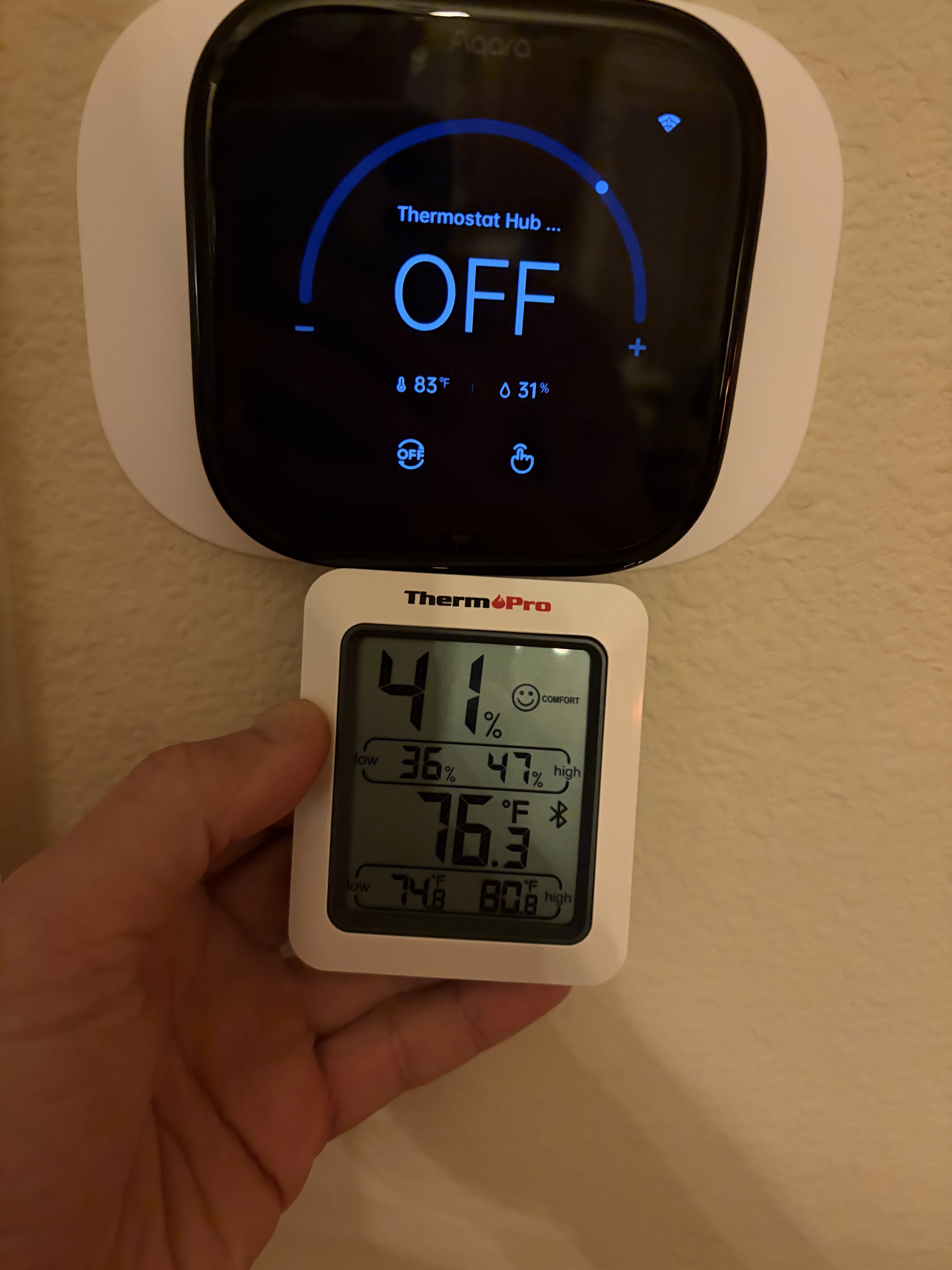

W200 thinks it’s 83F but it really is 76F. So I had to manually turn it off. Also it was online but now offline. I think I got a Lemmon.
If this were a product purchased normally, I’d immediately exchange it for the same item. Is that option available? I consider it a fatal that thermostat can’t accurately measure the ambient temperature. I just installed it but had to uninstall it and put back previous thermostat.

BTW there are lots of effective which could affect the temperature- mounted on the wall , holding in your hand …. But is there not an option in the settings to correct the temperature to the real room temperature?!

Hello, look in the settings, maybe there is a “temperature compensation” section. I don’t have this thermostat, but I recommend it by analogy with the W600.
That’s what I meant above @gafich10
Hello, Aqara does not provide temperature calibration (it was like that until now). This is another parameter, “temperature compensation”.

Hello, Ken, We sincerely apologize for the inconvenience caused. However, the W200 does support temperature compensation. You can try the following steps:
Aqara APP → Settings → Threshold Settings → Temperature Calibration — you can adjust the relevant settings here.

I have the exact same issue. W200 that jumps to 83, plateaus and runs the AC with no regard for actual temp. Is this going to be fixed? I want to stay with this thermostat over my Ecobee, but if you guys can’t fix this is then why release a buggy product?
