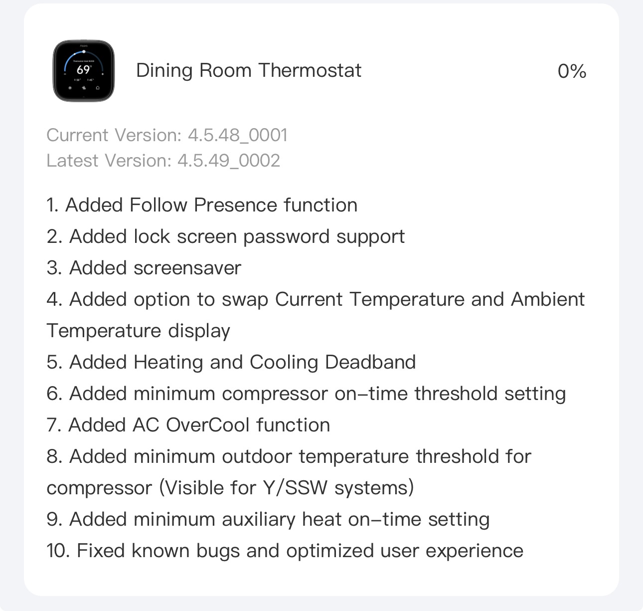

New firmware release might address this issue. Pretty major update
