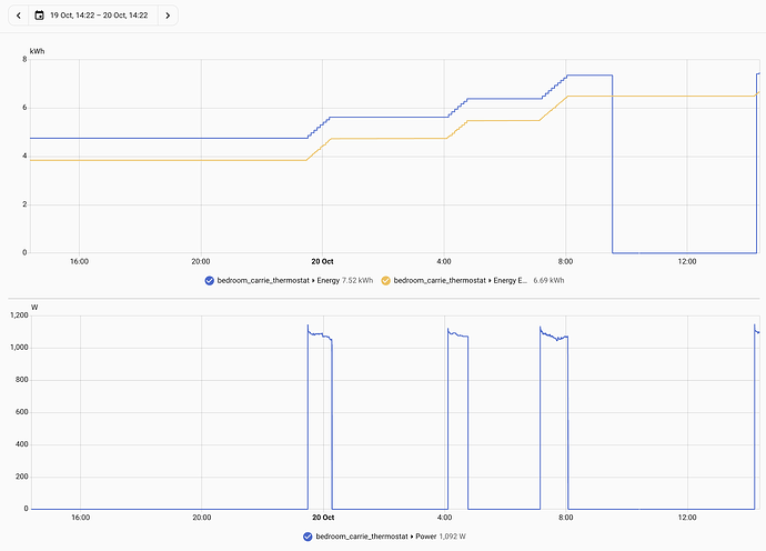

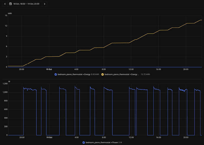

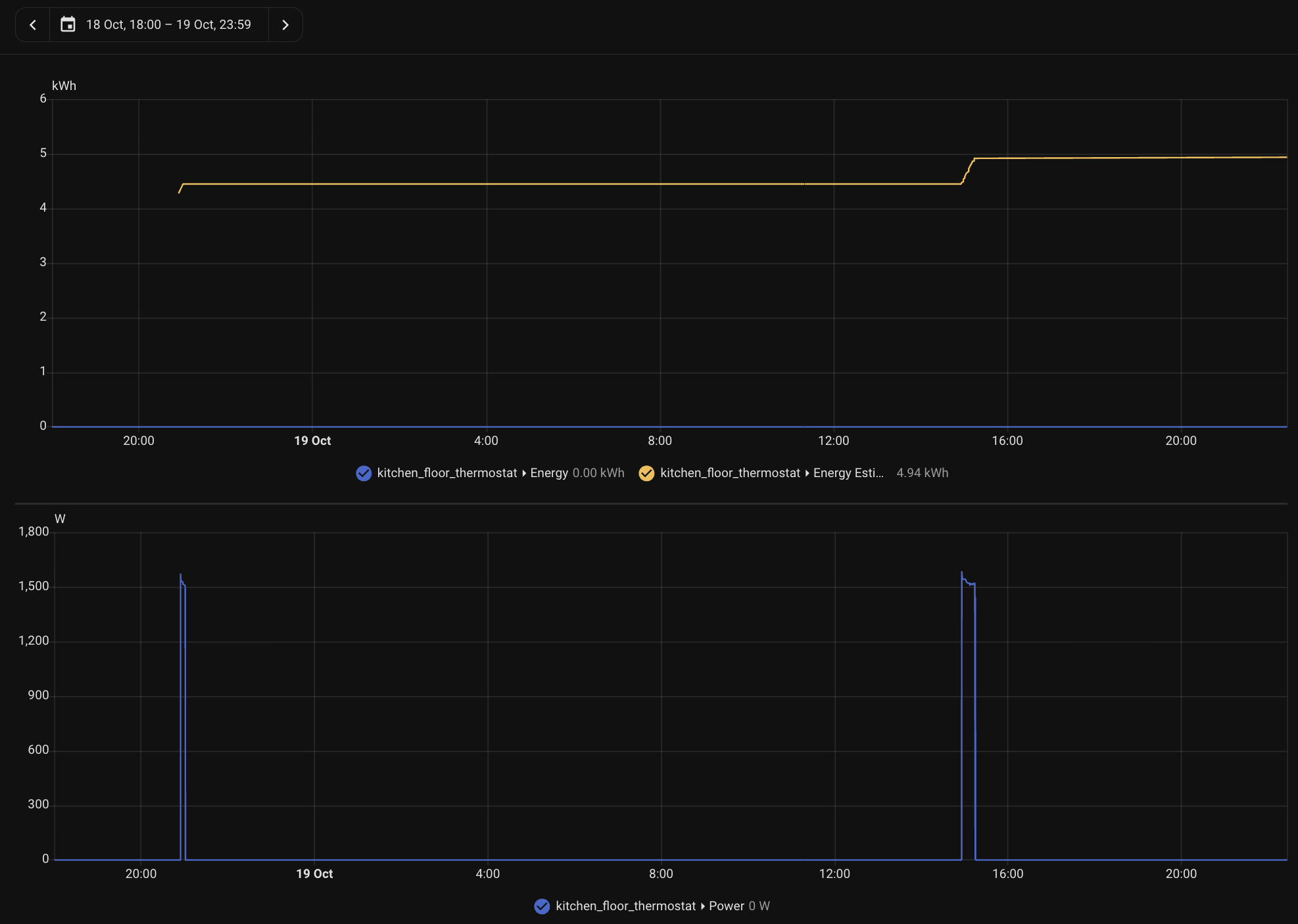

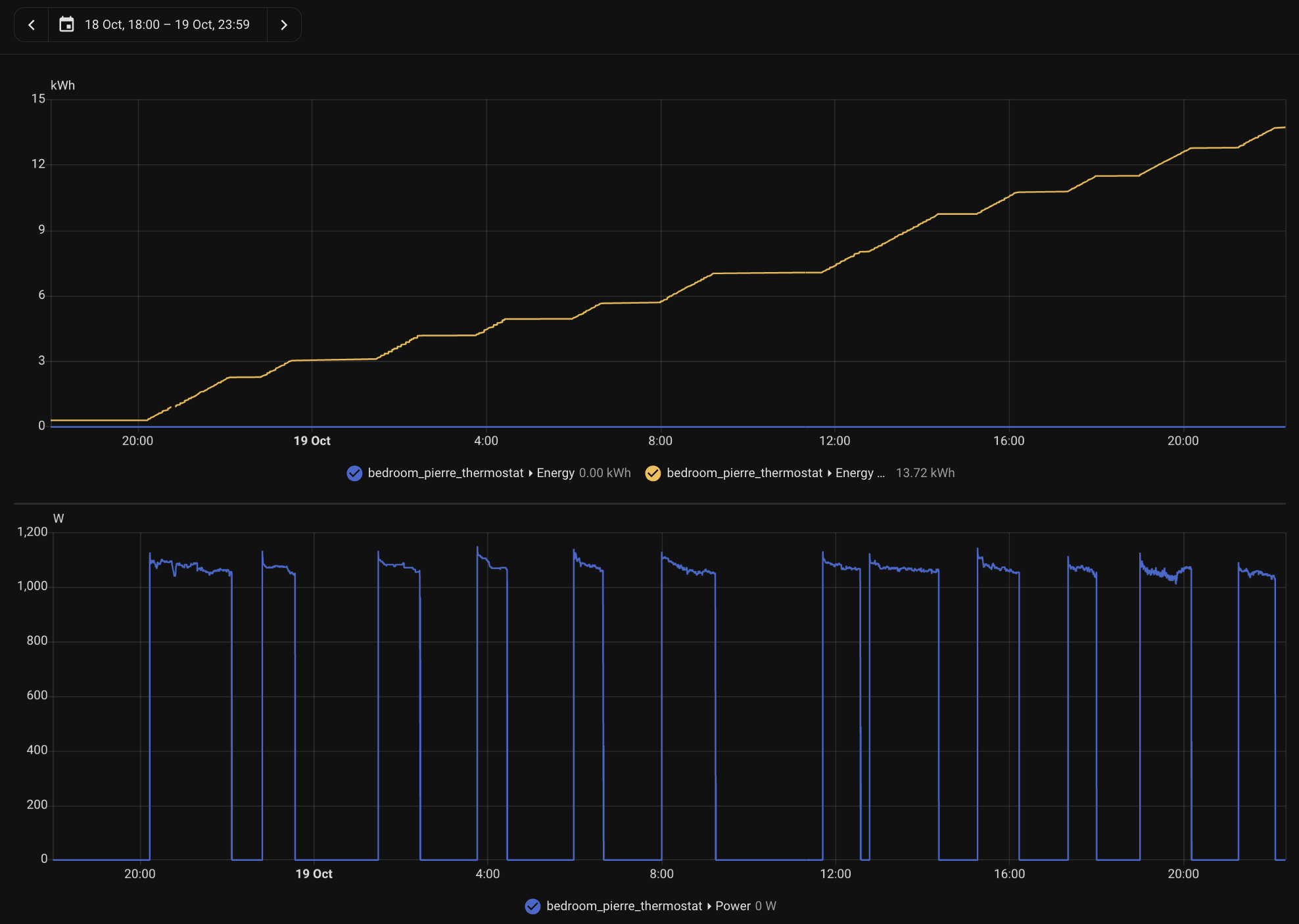

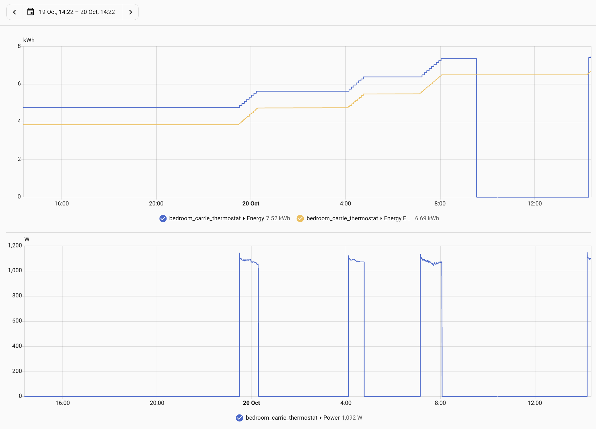

I have installed a few W500 thermostats around the house, and I’ve just noticed that they don’t all seem to report their energy consumption (but the power does give realistic numbers)? I’ve created integral helpers over the power in Home Assistant to estimate it, you can see the comparisons here (blue energy line is the sensor from the device, yellow energy line is the estimated one), on two devices:
Strangely, one of the seems to be behaving correctly?

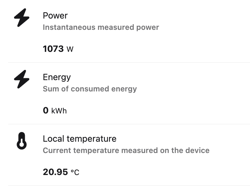

The ones not working, the raw value stays at zero in Zigbee2MQTT, and I don’t think I’ve seen it not be zero:

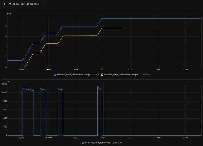

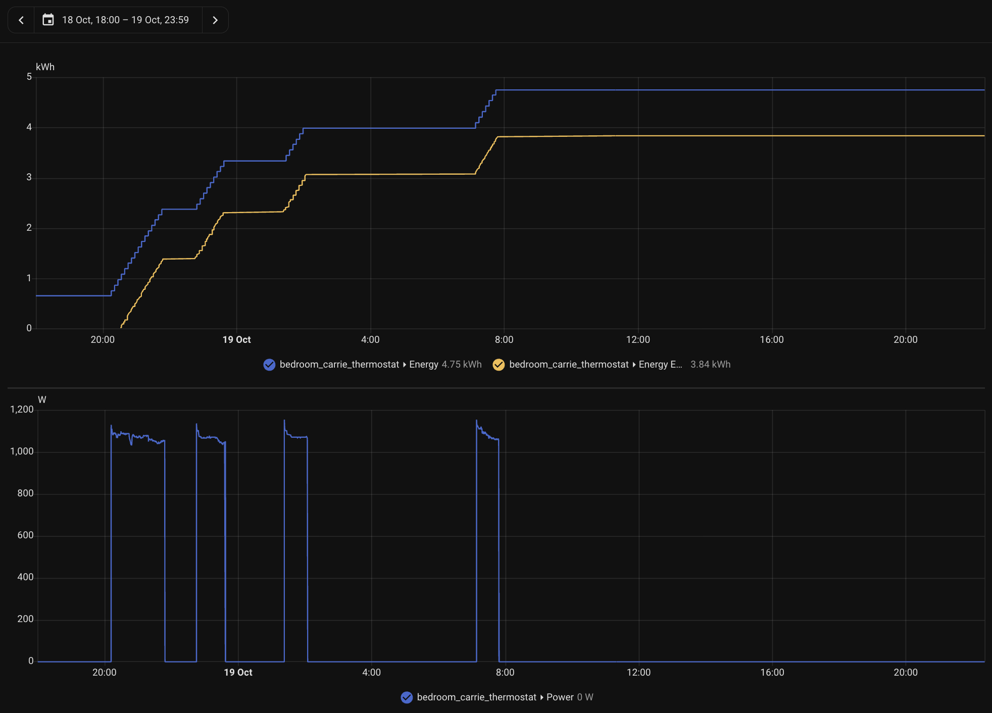

The one that’s working is… maybe not 100% working, but nearly? It reports the right value in both Z2M and HA, but occasionally (I think there might have been a Z2M/HA restart due to an update here?), it’ll go down to zero, but come back up to what it should be when it starts actually using power:
I think in this situation, the issue could either be in the firmware or in Z2M?
