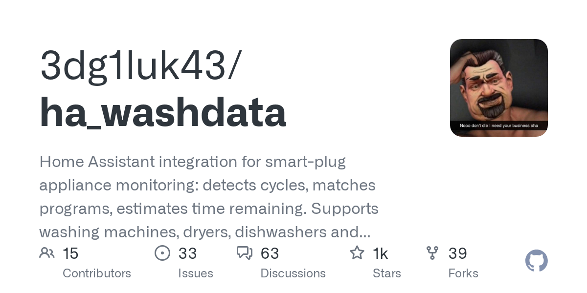

Then definitely check out the HACS-WashData integration, which can send you notifications and recognise the programme, showing you how much longer the wash cycle will take. It also works with tumble dryers, dishwashers and other devices.

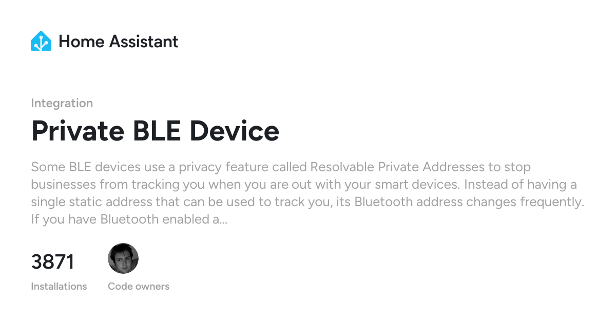

That might not work passively, though. Modern smartphones (both iOS and Android) use Bluetooth MAC address randomization specifically to block that kind of passive tracking, so your grid will quickly lose track of the devices.
One safeguard I’d add is a minimum run time before the low-power check can mark the wash as finished. Some machines pause during a cycle, so a short idle period could otherwise look like completion. A longer low-power window might help too.
Yeah, that’s can be an issue, but check out Bermuda BLE or ESPresense. Both support tracking BLE via IRK (Identity Resolving Key) which stays constant unless you reset the BLE device. I don’t think this is a cure-all for all BLE devices, but it definitely addresses it for Apple iPhones, iPads, and watches.
Thanks for the tip!
I actually came across this integration by chance a few hours ago:
I tried it out right away, and it seems to work. Amazing. Is there anything you can’t do with Home Assistant?
However, the app is still miscalculating my distance. No matter which room I’m in or how far away I am, it always shows me as being 0.0 to 0.1 meters away. Let’s see if that changes over time.
