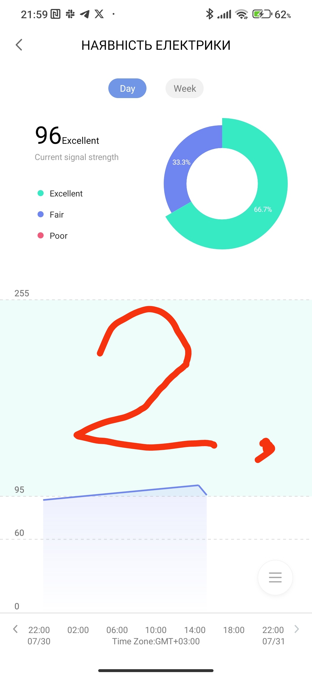

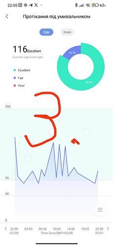

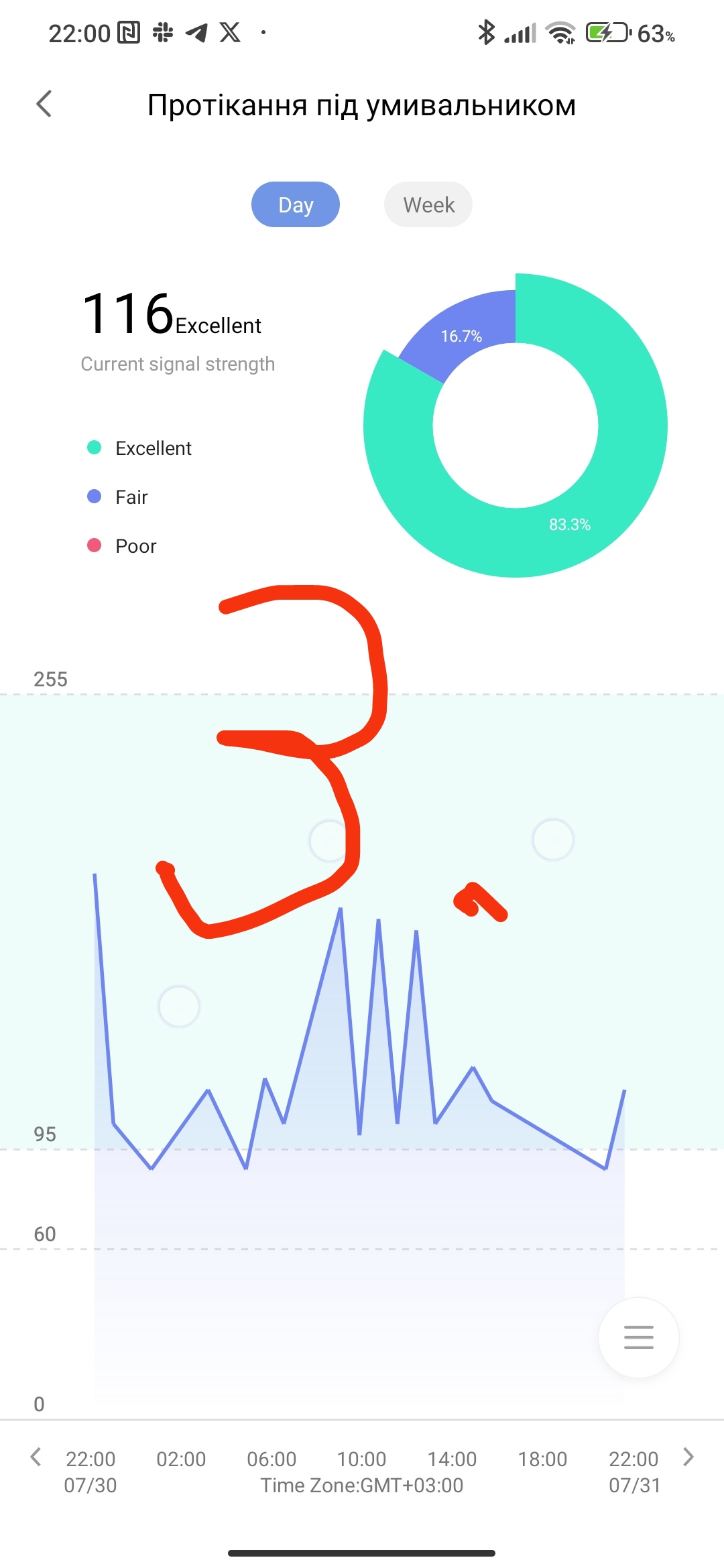

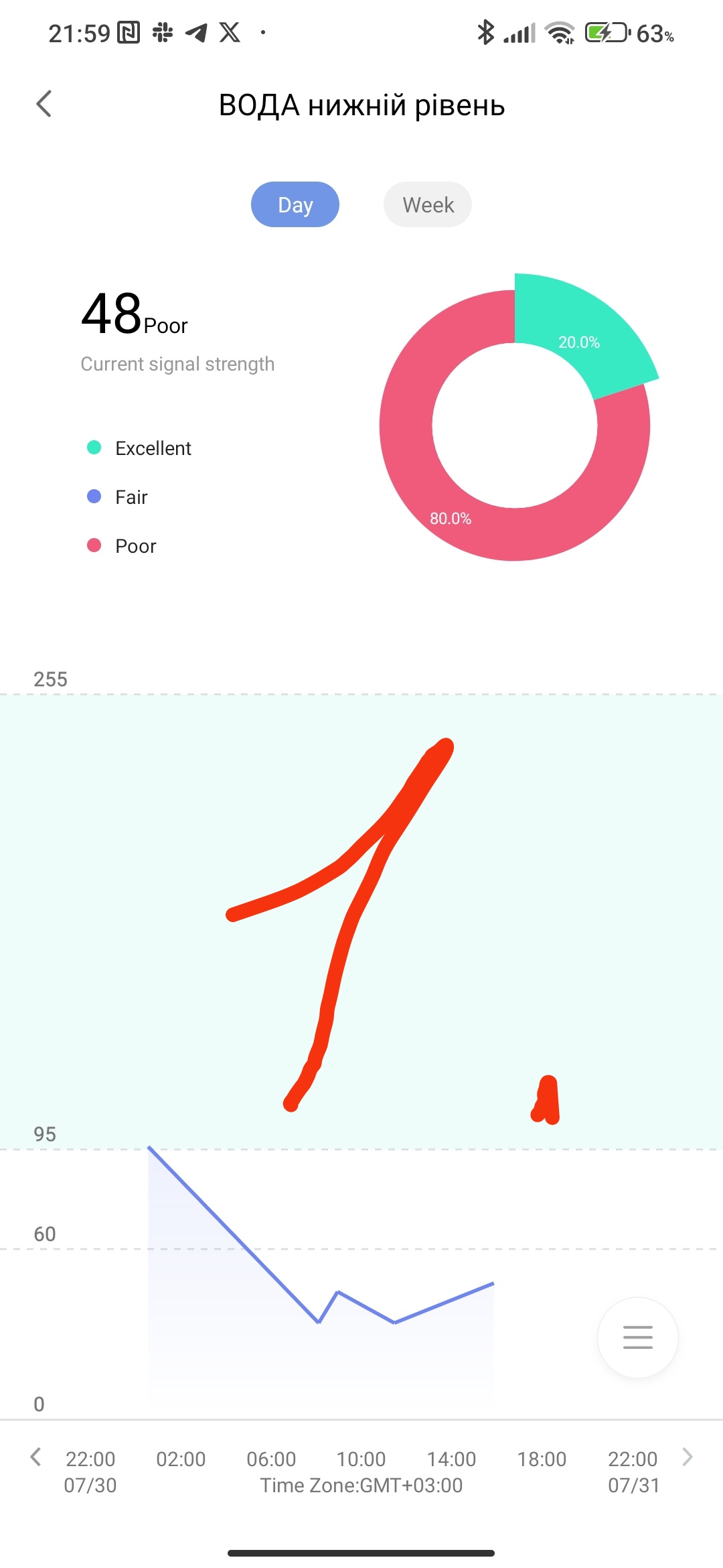

Hello @pchiccino_aqara . Considering that the leak sensor has its own pstrong texteculiarity, it is almost always “lazy”, works as intended very rarely (water leaks). All the time it only sends a communication signal “I am here, I am dry”, I wanted to check the period of sending the polling signal.
I will analyze three leak sensors.
  1. Sensor 1, works in the automation of controlling the lower water level in the water tank. Connected to the M2 gateway directly (I made this sensor critical, direct binding to the gateway).
  2. Sensor 2, works as intended, monitors the disappearance of the industrial network (using dry contacts of the relay connected to 220 volts). Connected to the M2 gateway directly (I made this sensor critical, direct binding to the gateway).
  3. Sensor 3, located in the bathroom under the sink, works as intended (water leakage under the sink). Attention, binding to the M2 gateway through some kind of repeater (some Aqara device in the room). I know this because when the industrial network disappears, it is not on the gateway (disconnected).

    1 sensor is involved in active automation when pumping water into the tank at the moment the automation is triggered (the condition is that the water level has decreased to turn on pumping) sends a signal and the Zigbee communication level is measured, which is displayed on the graph.
2 sensor constantly waits and sends a Zigbee polling signal twice a day, again, twice a day, this is a very long period. The sensor is connected directly to the M2.
3 sensor through a repeater, the signal level graph jumps throughout the day as it wants. Although it is constantly dry.
Based on the above, some sensors have an incomprehensible algorithm for sending polling signals to the gateway when they are operating in standby mode.
