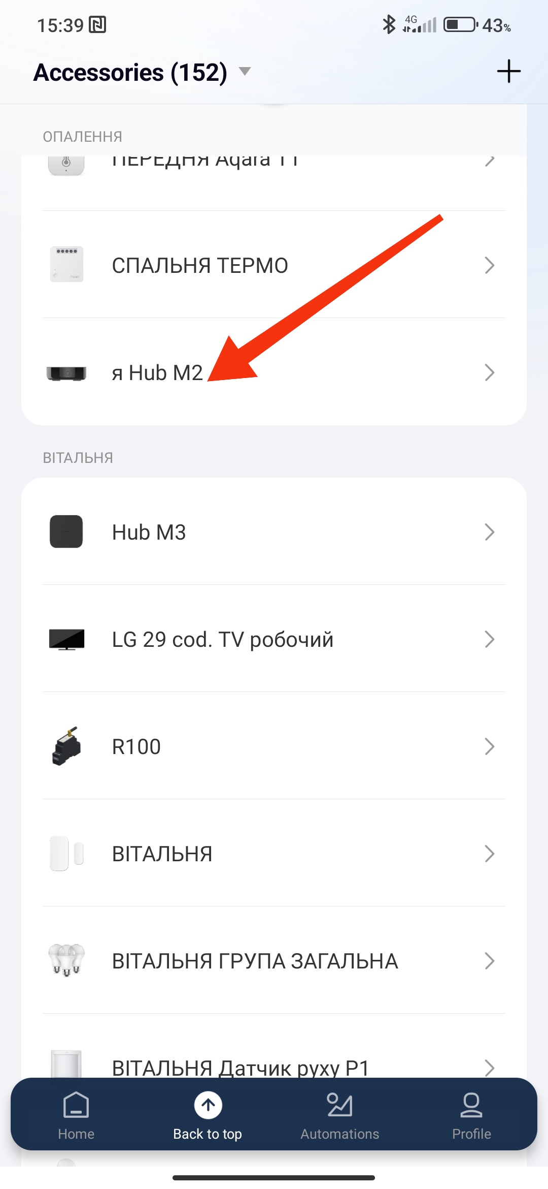

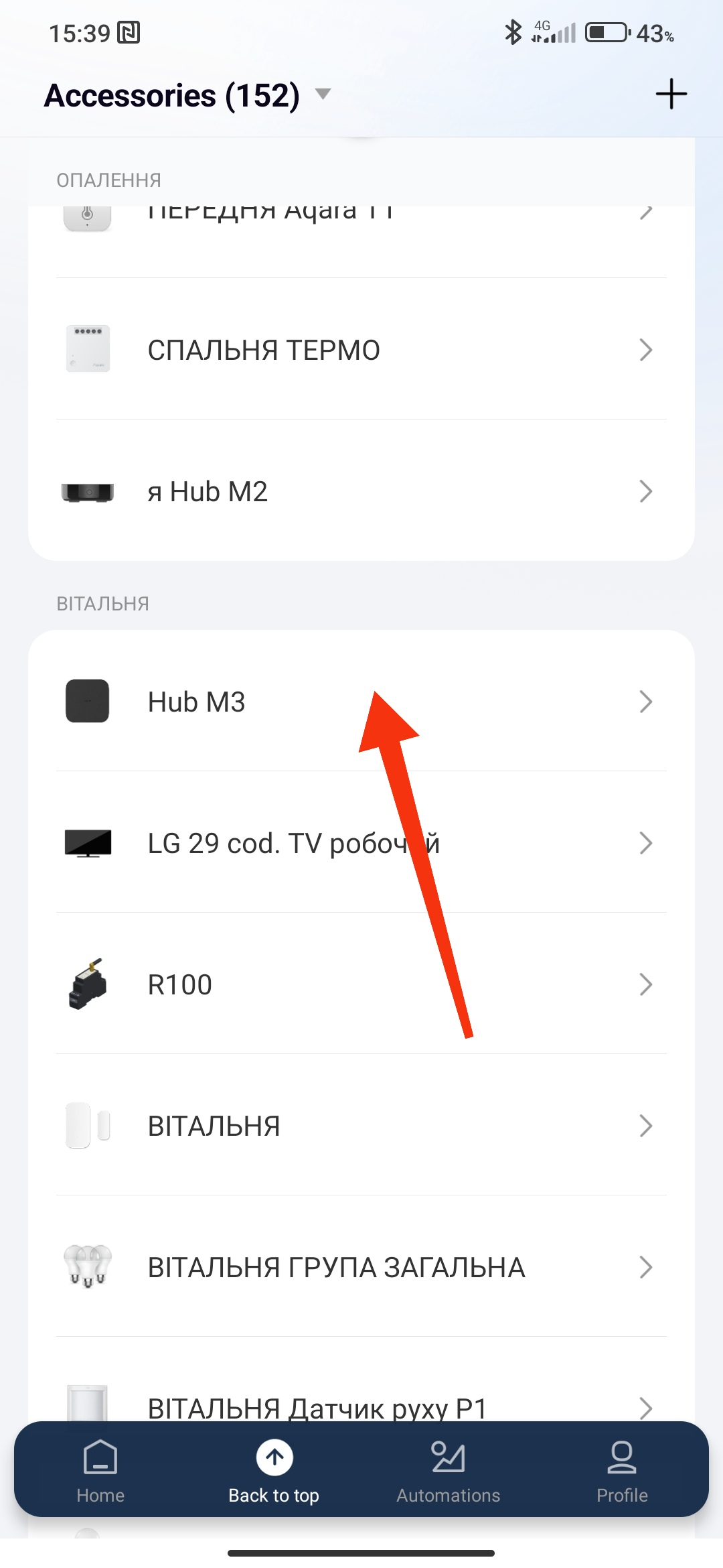

For general understanding, when you connect a device to 220 with zero, as a rule, they take over the organization of communication as an intermediate link. Therefore, if you have such a device, for example, a connection is made through it (for example) 5 battery-powered sensors, and therefore only one connection (a 220 volt device) will be connected to the M3 hub.
Therefore, theoretically you see 6 devices on the gateway, but in fact one device is connected to the gateway.
Just to clarify, an additional gateway does not expand the network coverage. You need to reconnect new or old sensors to it. There is also a feature from my practice, if two gateways in a house can manifest cloud automation within the house, they are connected because the home router works as an additional link of communication between the gateways. Therefore, uninterruptible power supply must be installed additionally on the home router. I try to do all critical automations so that the sensors that are connected to these automations are on the same gateway.
