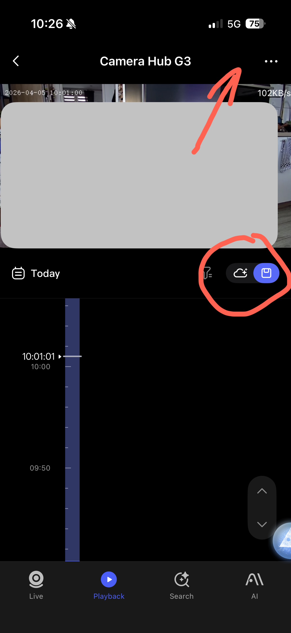

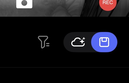

Did you toggle this button to local recordings? You should have full video here if it’s toggled to the floppy icon.
If I set it to local, will I be able to access it from outside my home?
Hello, no.
Yes. It refers to the storage location, you don’t have to be on the WiFi network to browse what’s recorded. The camera can stream from the SD card the same way it streams the live video.
@gafich10 I use it all the time - it just shows me what’s recorded on the SD card. The cloud button shows me what’s recorded on the cloud, and I don’t use the cloud.
For example, I can access the local recordings on mobile data
